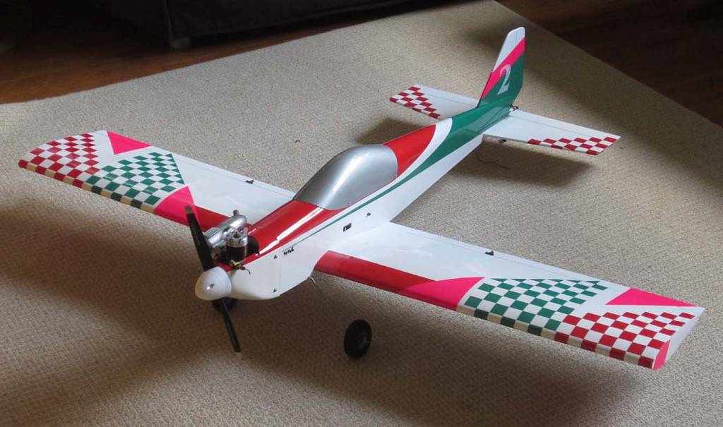

I've just started putting this together and I'm very impressed. Wing halves and joiner all fit together perfectly. I rounded the corners of the joiner where they go between the spars, to make it easier to fit. That made it much easier. It's quite tight, but perfect when you get it. Hardware looks good.
Took some measurements and got a tail volume of 0.7, which is on the high compared to most designs. This measure is the ratio of stab area to wing area, multiplied by the ratio of the tail arm to the wing chord. So large stab, long tail, narrow chord = big tail volume. What it means is that the stab has a lot of leverage on the wing. The 0.7 figure is is much like the old classics such as the Goldberg Falcon and the Taurus. This measure can be used to calculate a CG, and when I do that, the kit recommendation of 3.35 inches comes out on the conservative end of the normal range. By the calculation, 4 inches should be OK, but I'll start pretty close to the recommendation and work it back with testing.
Airfoil is fully symmetrical, with a thickness of about 16% of chord. That's a little thinner than a Stick type, and again, about the same as a Falcon.
Wing area is 556 sq ins, which is the same as a Goldberg Falcon 56. So overall, the size, proportions and force arrangement are very similar to those of the Falcon 56. It says the weight should be about 5 lbs. I notice some have said theirs weighed less than that...I let you know how mine comes out.
It is intended to be flown with an OS LA .40. Many people have used a ball bearing .46. I intend to use an Irvine .39, which is a bit heavier than the LA 40, but lighter than a 46 AX or the like.
Compared to an Escapade, it is a little larger; we'll see about the weight. First impression is that quality is high, and aerodynamics are very promising.

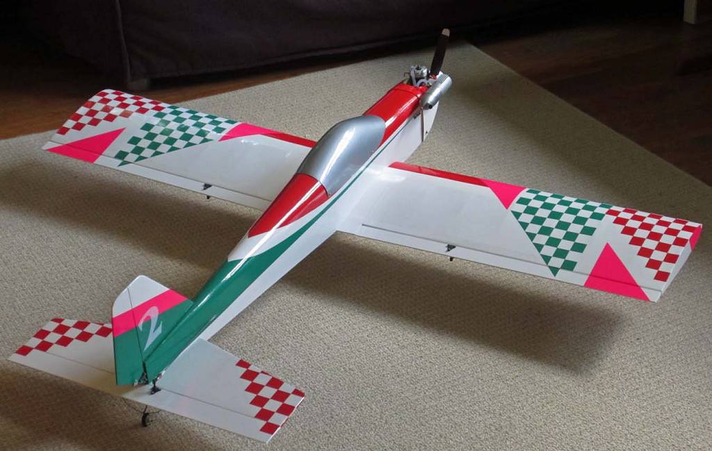

Here it is, ready to fly. Weight was 4 lbs 5 ozs, but CG was at 3.9 inches. It ought to be fine by my calculations, but I added a 2 oz brass acorn prop nut to bring it to 3.5 inches for the first flight. That brought the weight to 4 lbs 7 ozs. Pretty good! I might take it off depending on how it flies.
The spinner is a substitution because the prop shaft on the Irvine 39 was too short for the stock spinner, which has a thick plate. The landing gear wires are from a BUSA Stingray, and they are shorter than stock by more than an inch. Still plenty of clearance for an 11 inch prop. Wheels are 2 3/4 inch GP substituted for the stock wheels (and yes, I agree with the above...plenty of room on stock gear for bigger wheels0.
The florescent pink is my addition to improve visibility; I also peeled off a bit of the stock decoration. Other than these few things, everything is stock. Hope to fly tomorrow if the weather is good.

I guess not much interest in this thread, but I'll do one more post, because I flew the plane today and I just love it!
It seems both extremely easy to fly and extremely capable. Easy, straight takeoffs; I greased the first landing and most of the others. It can go fast, but it slows down nicely and you can poke around at 1/3 throttle and it is perfectly steady. Scarcely had to trim it at all, very straight climb, straight up, with a very nice stall turn at the top, and a tail slide another time. Rudder is very effective with scarcely any roll coupling. It's a go-where-you-point-it airplane that always feels comfortable and under control.
With the CG at 3.5 inches (manual advises 3.35) it is close to neutral in pitch. If you put it in a dive, it pretty much stays there till you pull it out. Flew inverted with very little up. But the elevator control was also very smooth and totally in control. I used the recommended throws, or actually a bit more, but with about -50% expo on all. That gave me really nice control and I felt no need for dual rates. Also, you can cruise along at half throttle and give it full throttle, and the plane just speeds up...no or almost no climb. Rolls are very fast and axial, snaps and spins are easy to start and easy to recover. The manual clearly has a good recommendation for CG...not way conservative like some.
The Irvine 39 (actually a 36) with MA 11x5 prop was very good power. Not a rocket with this engine/prop, but a fine grain throttle control, straight up as far as I would want, and it slows down pretty quick. It gave me the same feeling as the control surfaces...plenty of authority, but always under comfortable control.
I would definitely buy another.
