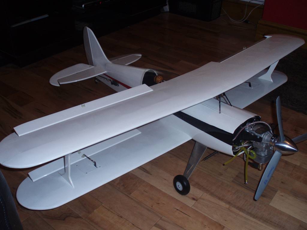

Skybolt 20 cc gas sure is fun, the standard kit or arf would not take a 30cc motor, size and prop clearance would be a issue as have to run a 3 blade with the 20cc.
A bigger one would be nice as it was a tight fit for the electronics and would give more room to move things about for COG.
But I agree if you cant buy it you can build it.

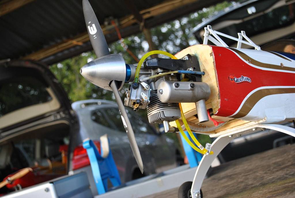

this the NGH GT17 gasser just installed on my GP Super Skybolt. Replacing an OS 91 4s, the plane does have some flights behind it. The GT17 mounted inverted instead of sideways using the same GP 60-120 adjustable mount. Fits well, and a lot neater, engine length is just right (5.8") for the cowl. These pics from break-in, note that I also switched the gear for a bit more prop clearance. The OS was swinging a 14x7 APC, the 14x8 the recommended break-in prop but the NGH looks like it'll handle a 15x7/8 or 16x6 no problem. Haven't flown it quite yet, but expect the plane to be transformed with the 15 or 16" props.

I had no idea they made a little engine like that. Im assuming that a small portion sticks through the cowl? do you have a pic with the cowl on? Of course im gonna ask about a dle 20? would it fit woth out too much cowl butchering?
