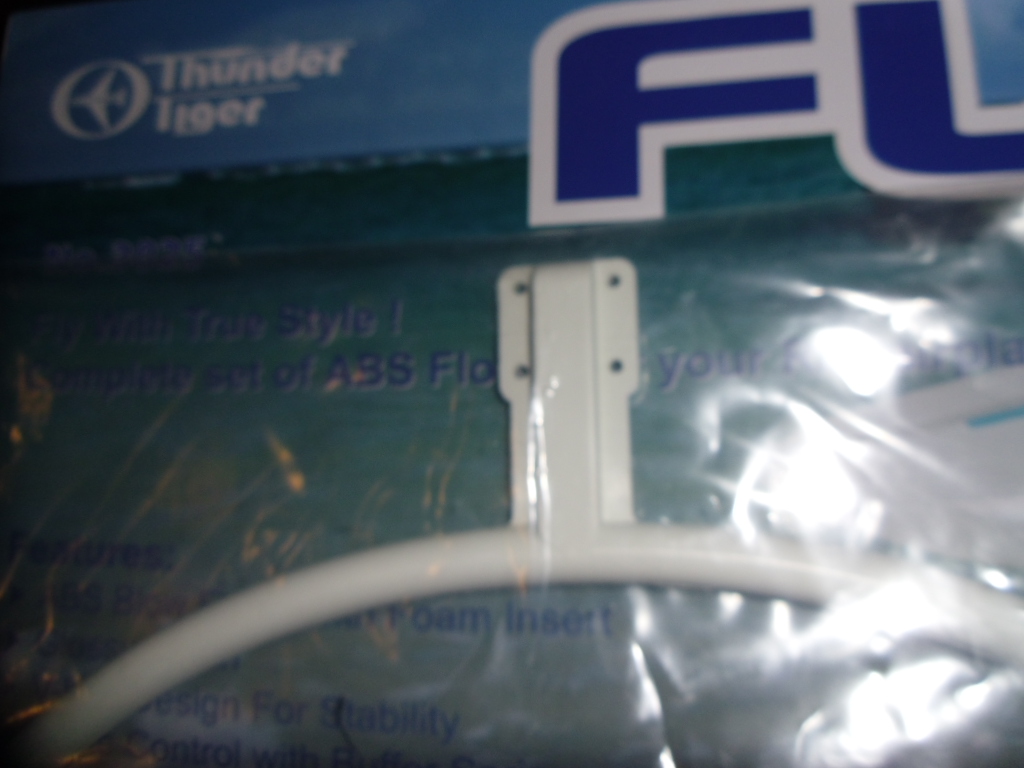

Here's a picture of the Front float Bracket that comes with this Float set and look at the front bracket in the picture on the box. There different because this bracket goes to another plane. Check it out

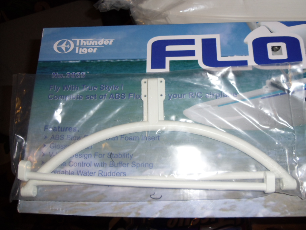

Here's the Front Bracket that comes with this float set see how it's curved unlike the cessna landing gear which is straight. I think this is for another plane and not the cessna. It's hard to get a hold of Thunder Tiger service through Hobbico they don't return E-mails
That mount is the one used on the "Thunder Tiger Ready ". You need to "CALL " tower and get the right one for the Cessna. E mail is fine for some things but people are better .
I 'm going to defend Tower a bit here but it's still their fault if you got the Cessna from them. Tower has only been handling these planes a short while and probably haven't run into this yet as they haven't had the floats on a regular basis as far as I know. ( out of stock )
As said the Cessna takes a special front mount and it just takes the place of your nose mount , it's real easy to take off and on if you have the right one. BE SURE you get the carbon cross braces that go with the set. You can see them in your 3rd picture.

I called the Customer Service and there sending me out the correct bracket for the Cessna 177 and a Decal Set Yipeeee!!

I'll check if my TT .91 fits, just got the parts to make the float set work for the Cessna. They threw in averything else in just so nothing can go wrong - Great Service!!
