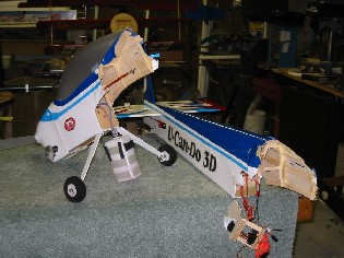

2 pc fuse.
Old 08-29-2003 | 04:30 AM
Joined: Dec 2002
Posts: 88
From: oakhurst, NJ
Default UCD may she RIP!

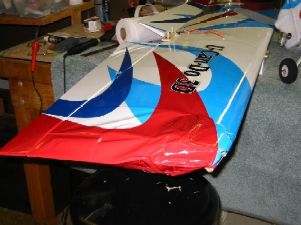

1 pc wing

Old 08-29-2003 | 04:03 PM
SwampFlier-RCU's Avatar
Posts: 1,130
From: San José, Costa Rica
For the looks of the pictures.. it seems that the uCD abc certainly be repaired...!!! Yes i said the dirty world
The fuse is clean and the wing has a couple of bays broken.. do you plan on repariting ot or ditching it?...
IF ditching.. too bad I am so fr away....
Old 08-29-2003 | 06:55 PM
Joined: Dec 2002
Posts: 88
From: oakhurst, NJ
I'll keep the wing and cut of the tips on both sides
and save it for my new one.
As for the fuse, I don't know!

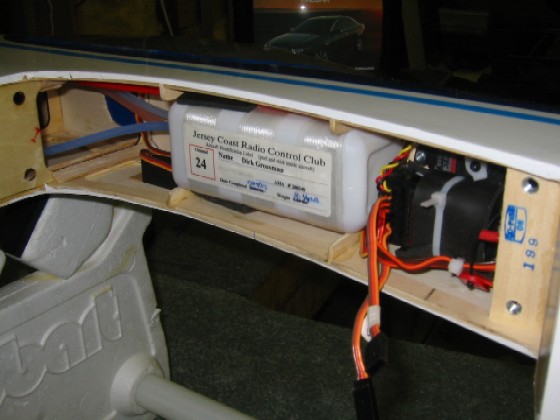

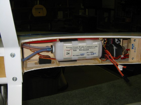

Old 09-15-2003 | 09:20 PM
Joined: Dec 2002
Posts: 88
From: oakhurst, NJ
Default RE: UCD may she RIP!
fuel tank over CG
Dirk

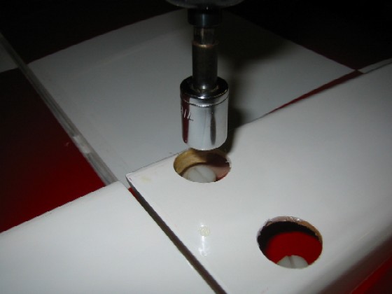

Old 09-15-2003 | 09:22 PM
Joined: Dec 2002
Posts: 88
From: oakhurst, NJ
EZ wing bolts Try this on your next U can Do
Dirk

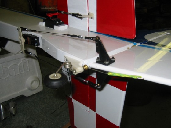

Old 09-15-2003 | 09:24 PM
Joined: Dec 2002
Posts: 88
From: oakhurst, NJ

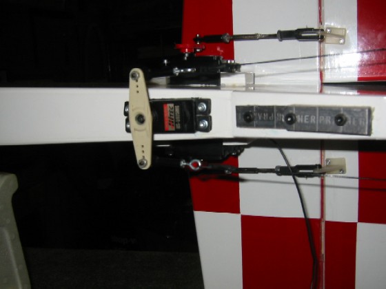

Tail set up
Dirk

Removeable tail weights
Dirk

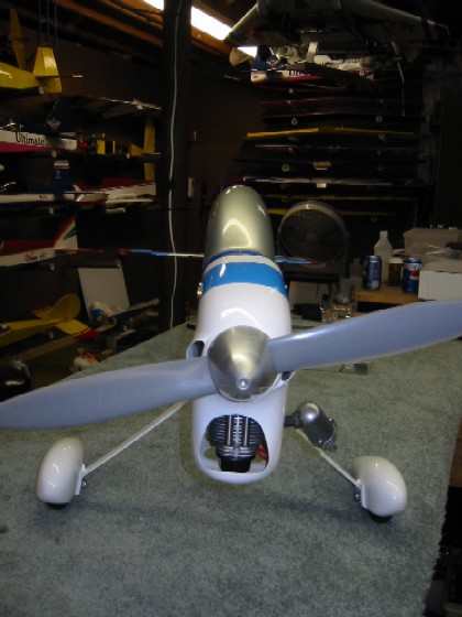

My U Can Do 2 flies great. I have been flying without the wheel pants and cowl
balanced at 5.5 inches with out the tail weights. Climbing inverted a flat spins and water falls are starting to look good. ( just started 3d) I changed to 30% heli fuel with no dead sticks so far. Now that I added the wheel pants and cowl I need to put a hatch behind the wing (it is above the fuel tank on the CG now) so it will balance @ 5.5 without the tail weights. Than when I feel lucky add the tail weight to balance @6" Watch out TOC here I come
