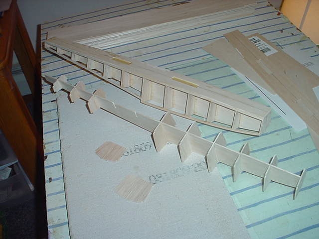

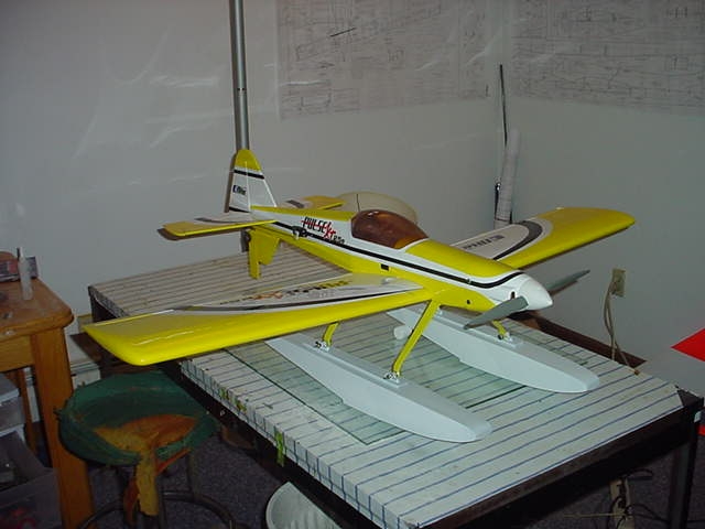

I have the Pulse 125 and I moved the landing gear forward about 3/4 of an inch..I used the front holes for the back bolts and epoxyed a new 1/4 inch ply plate in the floor of the plane for the front bolts..I put the gear on and drilled the holes,took the gear off and drilled the holes bigger to allow for the blind nuts,then put the blind nuts in with a tiny bit of 5 min epoxy...I have no nose over problems anymore , You still need your elevator just like you should on a tail dragger.. I fly off grass ...This is very easy to do.
Brian:
These floats are made from the Flybaby Float plans available from RCM plans. The ones on the 60 XT are full size, the ones on the 25e are scaled down a bit.
The Flybaby floats are very easy to build, light, and handle better on the water than any of the ARF stuff I've seen.

ORIGINAL: Mustang Fever
Brian:
Brian:
