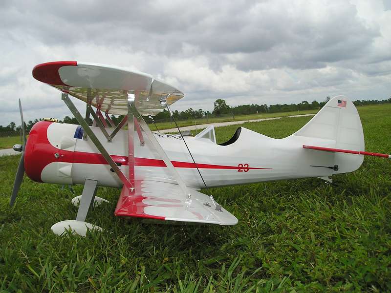

flew my sportsmans waco .60 for the second time today. yes, the main gear is quite weak, but that seems to be the only problem ive found... period . it came off in a soft grass landing on first flight last week.. not terrible though. its not weak anymore. using a saito 100 for power with a Graupner 14x7 3 blade prop. love it love it love it. its a beauty. does exactly what you ask it to. im also very happy to not have to take it apart to transport. thanks for tips and advice. this is a really nice airplane. i wish i would have started flying RC years ago. i never imagined the fun, excitement, and terror this hobby could bring. everything about it is AOK. just wish i wouldnt have messed up the cowl. its ok though, ill get better at building

You know, you can order replacement parts from Hobby People. Search for the plane and then on the page with the description of the plane, there is a link to "parts". The wheel pants are $15/pair and I think the cowl is about $30. I fly off grass and have already found stress cracks in the wheel pants. Think I'm going to take off the wheel pants for everyday flying, and order a new set to use for special events.

Oh,I'm drooling over that picture
That looks like something I have to have,something not so wild fast or 3D.Just a graceful bipe.I have a os 1.20 that i would install,my .91 would probably only fly it.
Is there enough room to put a 1.2 in there or is the cowl going to me all cut up? and room inside for a smoke pump?
