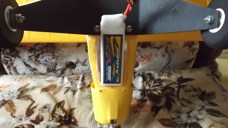

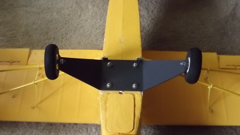

You can remove the struts and wing in about 3 minutes. You don't need to remove the landing gear. Just the 2 screws that face rearward (one on each side), and the screws that attach the struts to the wing, and the screw under the fake antenna, that holds the wing down.
I use 1300ma 15C 3S lipo's I get on ebay for about 12 or 13 bucks shipped, and they fit perfectly. I use scotch tape and make a pull tab on the battery, so I don't have to pull on the wires.

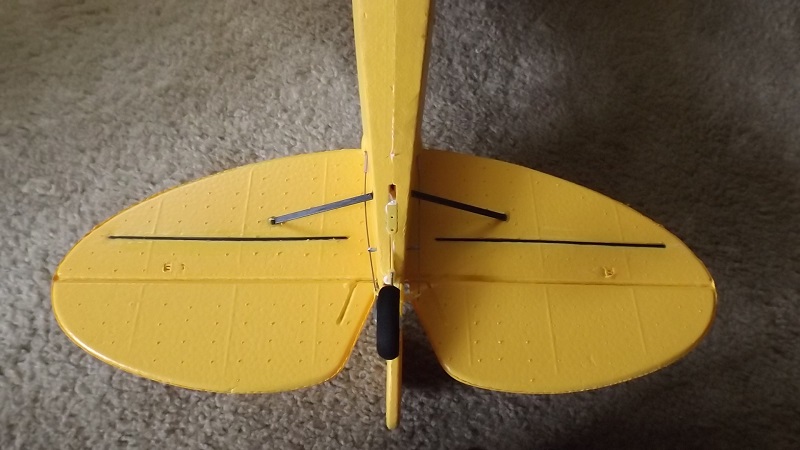

I can't imagine how the tail feathers got warped, but I hear soaking foam parts in hot water makes it go back to it's origional manufactured shape. There's you tube video's about that trick.

Yes, I know that the wing could come off taking only the screws from where the landing gear is attached and the top screw of the wing but, something I didn´t mention is that the screw heads (those 2 actually) were pretty soft on the heads and it is hard now to get them to move with my screwdrivers... will try and find some at the hardware store to replace them (metric).
The foam in the elevators is fine, what is bent is the wire that holds them together and the control horn... I have tried to bend it some but without putting too much pressure as the foam starts to give out. I already had to repair a crack in it.
I also put the receiver in the cockpit and can see the bind light, etc... that is not a problem. Use ArtTech 11.1 1300 mah batteries and they fit but slanted to the back... actually you can see it part of it from the cockpit... the plane seems to balance OK with the equipment the way it is so I will leave it as is. I also had to change the plug from the ESC to a Deans plug - no problem there.

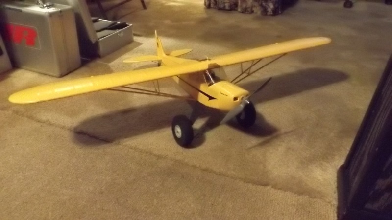

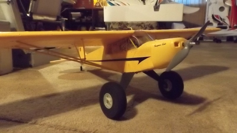

Hey willig,
I was looking for a decent size plane for my home area where I have a nice 55acre farm adjoining my property. The Flyzone Super Cub fit the bill. After reading all the threads & postings on several forums, I decided to do all my mods as I assembled it. I removed the cowl & motor & epoxied the inside of the fuse nose, especially around the steel motor mount. I removed the ESC & decided not to use the flimsy wire landing gear. I ordered a Turnigy Aerodrive DST 1200KV motor & Turnigy Plush 30A ESC from HK. Also got a couple APC 8 X 6E props. I fabricated an aluminum landing gear from an old "STOP" sign as it is tempered aluminum & flexes like a shock absorber. I used the 2 5/8" tires from my Sensei hoping for better grass handling w/takeoffs & landings. I added CF strips to the horiz. stab & made struts for strength.
When the new motor came in, the orig. motor mount plastic adapter fit the new motor perfectly with hole alignment. Installed the new ESC & a Spektrum AR400 Rx. A Zippy 3S/25C/1800mah battery fit in the battery bay easily. When it was all done & ready for maiden, I went to our club field where it is very open. The grass takeoff was almost a disaster as the field hadn't been cropped for a few days & the Sensei tires bogged down a bit. With a hand launch, the plane had plenty of power, climbed well, & only a couple of clicks of trim were needed. It flew nicely at half-throttle giving me 10min of flight w/3.74v residual left & 1125mah to recharge. I set my timer to 12min of cruising & used 1560mah.....all was well other than takeoffs/landings in grass. The following week, a trip to my LHS produced some great 4" foam "tundra" tires that did not change CG or flight characteristics & made grass takeoffs/landings a breeze. I managed to get 3S/2200 mah batteries to fit after removing the Velcro from them & now my cruising flight times are near 15min cruising. All is well now. Here's some pics...
Additional note: I had to reduce the rudder travel to 50% on my Tx as the rudder had excessive travel & now turns much better. Also, I used an E-Flight collet spinner to attach the prop.
Denny
