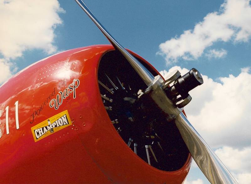

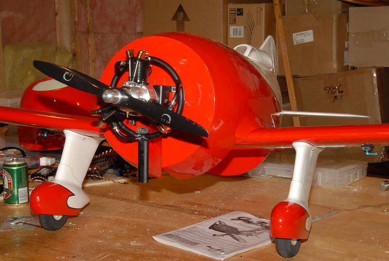

#549
Joined: May 2005
Posts: 81
From: North Aurora,
IL
Mines' still in the box. Still deciding on what engine to use. Here are some pictures that I took of the full-size at an air show several years ago...
Doug
Doug
