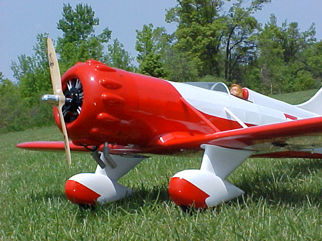

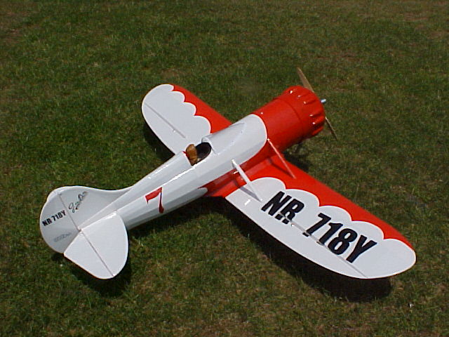

ORIGINAL: Anson
I really wanted to put a gas engine in... I wish I could have used the smaller one (it's a 35) in the GP Gee Bee
If you want to stay in the Gee Bee family, I have a Quadra 35 in my Pacific Aeromodels 82" Gee Bee Model "Y" ARF.

Yeah, I've seen the Pacific Aeromodels Gee Bee Y - very good looking plane. How does it fly with the Quadra 35? Was balance a big issue?

ORIGINAL: Anson

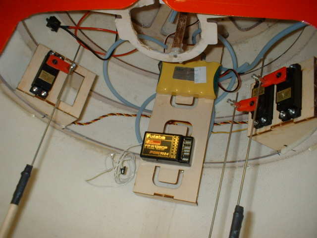

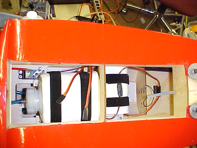

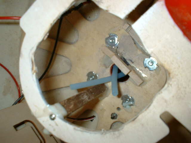

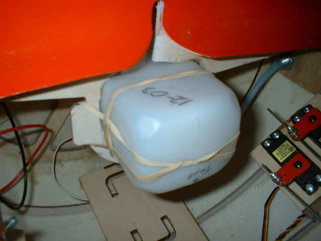

With three servos located in the tail, the 16 oz. fuel tank centered on the CG, and the 5 cell 1700 mAh battery right behind the fuel tank, it needed some tail weight to balance. The engine swings a Zinger 18 x 8 wood prop at 7200 RPM (still breaking it in) and hauls this 17 lb moose around nicely. It will cruise around at half throttle (around 6000 RPM) and climb out with authority at full power.

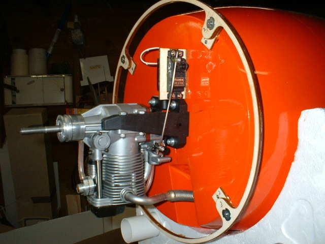

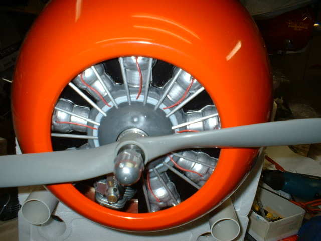

got engine and cowl... APC 17X10 Prop

That's a really nice looking scale engine.
