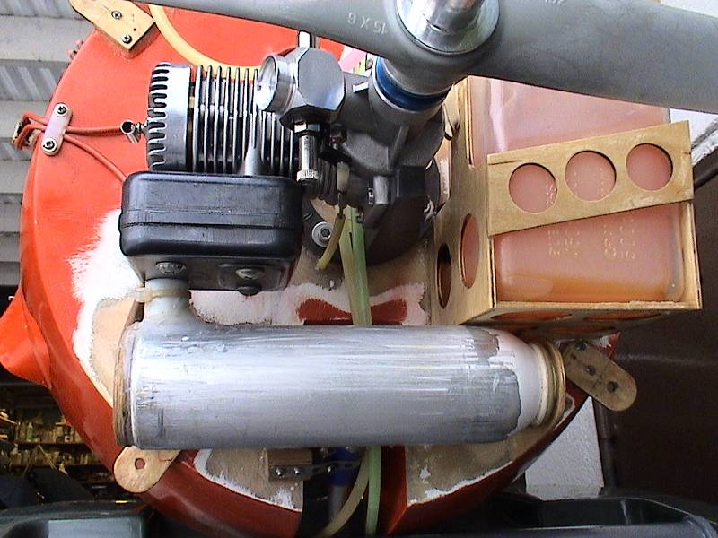

Old 11-14-2007 | 10:58 AM
  #332
Posts: 7,816
Received 10 Likes on 10 Posts
From: Upplands Vasby, SWEDEN
Default RE: GP GEE BEE
Hi!
I fly from a super fine grass field and I can assure you that those plywood end plates are indeed necessary.
Old 11-14-2007 | 12:22 PM
  #333
Posts: 7,816
Hi!
After having flown the GP GEE BEE R-2 know for 3 years I have the feeling that the problems many flyers encounter with this airplane is building it too heavy and powering it with too big engines(Gas engines and bigger than 20c four-strokes)
If you just follow the GP instructions and power it with either a 15cc two stroke or a light 20cc four-stroke engine and building it light, removing parts and making lightening holes were ever possible, your chanses of having it survive the first flight will increase dramaticly.
I fly mine with a 15cc two-stroke engine using an APC 15x4W prop and it weights exactly 5kg (5000g)....that's under the GP recommendations...but it's still a handfull to land, but it flies real well and is very aerobatic.
ID:	803756   Click image for larger version
ID:	803757   Click image for larger version

Old 11-14-2007 | 05:18 PM
  #335
Joined: Dec 2005
Posts: 3,934
From: Victoria, MN
Clever gas tank placement...
Old 11-18-2007 | 10:52 PM
  #336
forestroke's Avatar
Joined: Oct 2003
Posts: 1,942
From: Taipei, TAIWAN
while that's clever gas tank placement, it's critical that you remember to balance that dry. if you balance that wet, you'll be looking for one very hairy, very twitchy landing. i'm sure jaka is a pro but with a gas tank there, i wouldn't be suprised if you balanced her full, she'd be a beast to land empty.

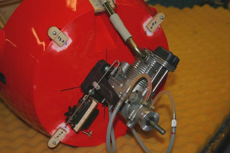

Old 01-20-2008 | 11:19 PM
  #344
dg512055's Avatar
Joined: Oct 2005
Posts: 73
From: UNION CITY, TN
OK guys I just finished mine. I got it for Christmas because my wife loves the plane and wants to see one fly. I have installed an old YS120. The throttle servo is on the firewall. It came out a little tail heavy according to the CG in the manual (2-3/4" from leading edge). Does anyone have confirmation this is a good starting point? Here are a few photos.
ID:	856629   Click image for larger version
ID:	856630   Click image for larger version
ID:	856631   Click image for larger version
ID:	856632   Click image for larger version
Old 01-20-2008 | 11:56 PM
  #345
djyoung's Avatar
Joined: Dec 2004
Posts: 41
From: SeoulSeoul, SOUTH KOREA
ORIGINAL: dg512055
DONT MESS WITH THE CG~~~!!!
Make sure you set the CG at the recommended specs according to your instruction manual.
It'll fly just fine.
I'd imagine A YS120 would balance out just fine because my OS120 balanced with a few grams of weight in the tail section but in your case it's a bit tail heavy. move the battery as far forward as you can and rearrange a few things here and there until it balances out.
The BEEGEE having such a short fuselage isn't all that forgiving especially if it's tail heavy even just a little bit.
But do keep it light as possible and don't "experiment" with the CG until you've flied it a few times in the rec. specs.
Oh, one other thing, you might consider keeping the wheel pants off until you get the hang of takeoff's and landings.
Have fun!
Old 01-21-2008 | 12:04 AM
  #346
Craig-RCU's Avatar
Posts: 645
From: minneapolis, MN
Yes, 2-3/4" is a good CG. Do exactly what the instructions say about the CG. That 120 should haul it around nicely. If I remember correctly, the stock tank is only 8 or 12 oz. Is that going to be enough for the 120? Maybe add another tank at the CG and take advantage of the YS's pump?
Old 01-21-2008 | 08:30 AM
  #347
dg512055's Avatar
Joined: Oct 2005
Posts: 73
Sorry for the error guys, I meant to say it was nose heavy to start. I moved the battery back on an extension of the stock tray, and added 2 oz to the tail. This put the CG on the manual recommended position.
