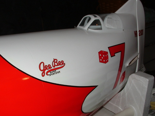

This morning around 1AM I started on the Landing Gear / Wheel Pants! After several long hours of work I finally finished them. Both turned out just great although I am going to add Robart Alum wheels to the pants. The foam Tires are not going to hold up!
Here is some Photo's of what I have done so far!

Okay Guys, I couldn't resist it any longer. Tower was giving $20 off so I purchased the GP Gee Bee. I went to the attack and took down an OS 120 FS II I brought back in the 80's and started her up. She purred, but I think I will put my old Super Tigre G2300 in. Why, some will ask. Well, I looked at the OS 120 specs and the weight was quote "34.56 oz" with silencer and rated at 2.1 BHP. The Super Tigre weighs in at 30.77 oz without muffler, and is rated at 3.7 BHP. It's a no brainer fellas. Just for comparison, I looked at the Saito 1.80 specs and it weighs 31.04 oz at 2.8 BHP.
I expect that I will adjust former to allow for a larger fuel tank. I will not purchase the Robart struts initially, but I will attempt to strengthen the GP gear by wrapping them in wire and soldier and possibly adding a wire splint if needed. I have had experience in bending Gee Bee landing gear when scratch building Henry Haffke's Gee Bee Model Z, so supplimenting the GP gear with larger diameter wire shouldn't pose to great a problem.
As far as the landing woes I continue to read about, I think the larger diameter prop on the G2300 will allow ample braking, thus allowing the plane to be flown to the runway on the prop. This has always been the ideal landing technique for Gee Bee's, Corsairs, and most high-wing-loaded proped fighters.
I thank all of you who have shared your building experiences with the plane and likewise I will upload any helpful suggestion I may encounter as I build this beautiful bird. I gotta confess though, it is taking every ounce of will power I have not to strip my Sukhoi of its MVVS 1.60 gasser (haven't flown yet) and toss into this Gee Bee. I think the only problem will be the added weight up front caused by the ignition and batteries needed, as most are reporting a need to add weight to the tail. Once I open the box though, I will see if it is feasable to erect a servo plattform in the fuselage tail section to mount the elevator and rudder servos. Gp's Cap even utilizes a rudder servo in the bottom of the fuse tail, which might be another idea to look into.
