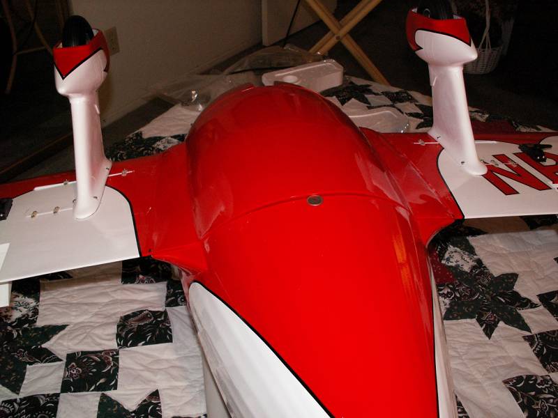

I plan on installing a G23, but will make a final decision after I hang the motor and try to balance the airframe.
This is the nicest ARF that I've run across. The workmanship is very good. Glue seems to be everywhere that it should be. I'm very impressed so far.

You need a bigger table mate, are you gonna show us any more pics of how it goes together.

Ya, Colin, I'll get more pics when I get something done.
My "shop" is in my computer room. I didn't figure that I needed much of a building board to assemble this ARF. If need be, I'll go out to my regular work shop and use it's board, but I think I can get by with this one.

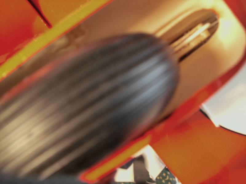

Well, I finally got time to start building. I started wtih the wing, which was pretty basic. I do however glass all center sections using fairly stout fiber-glass and Bondo fiber-glass resin. I like the way this combination sands.

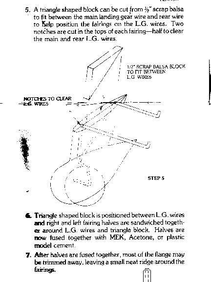

The landing gear wire is reinforced with a balsa triangle piece wedged between the leading and trailing wire of gear. The balsa is secured with fiber-glass which is saturated with medium CA. The pants fit over the assembly without a hitch and if needed in future the wheel pant can be secured to balsa for more stability.

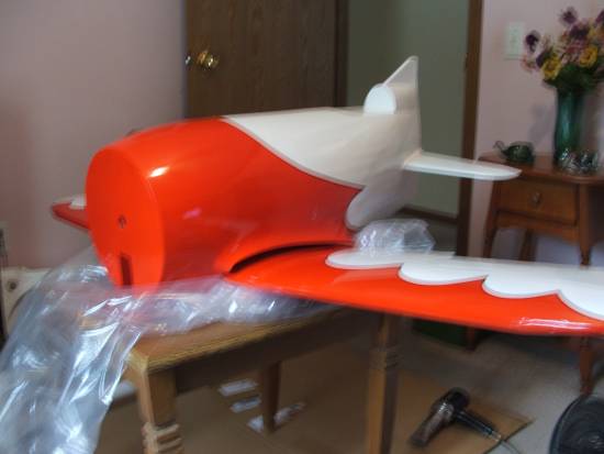

I test fitted the belly pan after cutting notch at center and initial trimming of sides. I guess I am one of the lucky ones as the belly pan appears to be a very good fit. The rear of the pan is only an 1/8 of an inch high at the rear saddle area, just a bit higher than the dime seen in the accompanying photo.

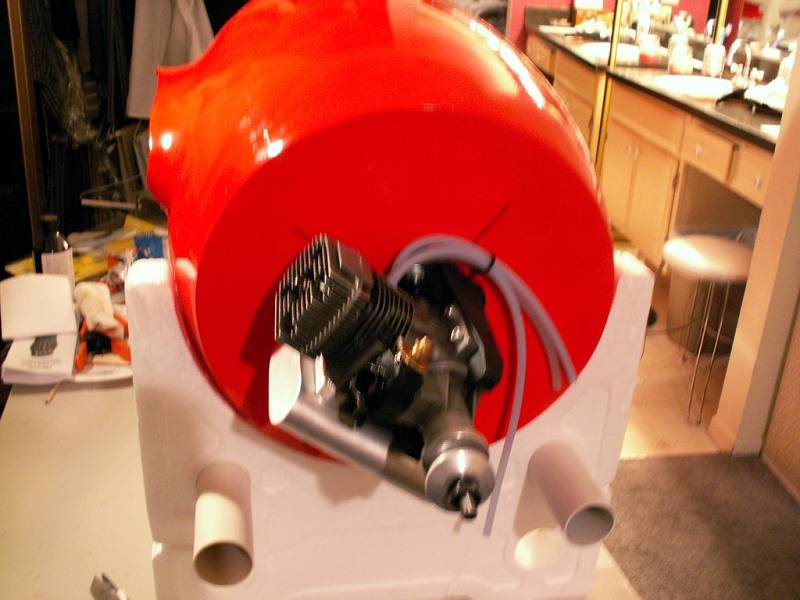

Did a test run on Super Tigre G23 using Perry Carb, ran like a tiger using 18x8 prop. I am uncertain as to how to mount engine. The instructions suggest 6 inches from firewall to front of rear prop washer. I think I read somewhere here that this may cause Super Tigre carb to interfere with dummy radial engine.
If anyone has any advise on how far back to move engine on mount to clear dummy radial, I would be appreciative. Also, what was the weight penalty for doing so, that is did you have to compensate by adding ounces to the nose for balance?

I thought that I would be able to use the Super Tigre G2300 stock muffler, but it was a bit to large as it touched the sides of the fuse cut out. I have ordered a Bisson 70 deg. pipes # 2231 muffler. From looking at the catelog picture, I think it might be the right muffler for the application. I welcome any thoughts on choice of muffler. Thanks in advance for any advice offered.

Hopefully the thread is not Dead...I was awaiting a muffler from Bisson, which took some time to arrive. The 70 deg. pipes are at the right angle for the fuselage slot, but the pipes were a bit too wide apart. So, I used a vise to bring them together, see photos.

Not dead...just dorment! I see my GeeBee sitting in the shop, and I do want to fly it again, but I've gotta wait until our flying field is worked over. I will have enough room to set this thing up for a proper landing then!
Engine looks good. Ever notice that just about everything looks small mounted on that firewall?

To tell you the truth, I love the room in the engine bay and inside the plane. It gets a little tiring trying shove equipment in 40-60 size planes.
