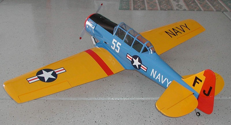

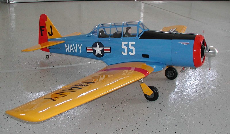

I have a Hanger 9 AT-6 with a Thunder Tiger .91FS. The CG is supposed to be 4 3/4" inches back from the leading edge. It needs 4.5 ozs at the TAIL to balance!.
Anyone else with this combo have similar results?
and, I assume that is means from the yellow part of the LD not the blue center section
Any help appreciated. Don't want to try and fly it with the butt hanging down

The CG is always measured against the fuselage. If you measure the CG from the yellow part of the wing the result is a plane which is tail heavy.
A nose heavy plane flies poorly, a tail heavy plane flies once.
I would start measuring the CG against the fuse. If it feels nose heavy it is easy to move the CG backwards. If it is tail heavy you are lucky to get it back in once piece.
--kaboomski;

Bumstead! I have the great planes balancer. I have the center section leading edge, the blue part where the wheels retract into up against the stand right against the fuselage sides. You then measure back 4 3/4 inches from that point. As far a changing the gear wires, just unscrew the four retract screws and remove the unit from the wing then drill a 3/16 inch hole in the existing retract unit. The hole that the unit comes with is about 5/32 inch. The existing wire that is in the retract will pull out after you loosen up the allen screw in the retract unit. The robart wire is the correct length, but the coil in the gear is different so you will have to use a dremel tool sanding disc to make a small cutout for coil on the gear to retract into the wing. No bid deal. Just takes a couple minutes to do it. It is well worth the time to make this adjustment. Good luck.

That tip about the CG against the fuse was the ticket.
Now I have to tear out the battery from the rear fuse and
all the other junk I stuffed in there trying to balance
the thing. H9's manual could have been a little more
explicit concerning where the CG is measured from.
Doing only constant chord wings everything was easy.
Wish I had asked first...Oh well..Thanks again everybody

The balance point is 4 3/4 inches from the leading edge of the blue fairing up tight against the fuselage

News from the flightline- Took the plunge and tried to fly it today.
1) wing generates huge amount of lift, so much so that it lifted off
after about 40 feet of roll-out.
2) Unprepared for such a quick jump, I tip stalled to the left (torque)
3) Totally pilot error..not inherant plane problem.
4) Here's the fun part.. The firewall separated from the fuselage clean...
like it was tack glued. I *****ed for a minute about hot-glue or something
but then I looked and had a plane that had survived a 10-15 foot tip stall to
asphalt, no fuselage damage other than a smashed up canopy
(it was cracked from the box anyhow) and a easily repaired firewall.
I have epoxyed the firewall back in place and will remount the engine
tomorrow,
When I began repairs I discovered that the firewall is
HOT-GLUED to the fuse. I'm no chemical engineer but is that stuff strong enough
to stand a .91 pulling it's guts out and flying stresses?
