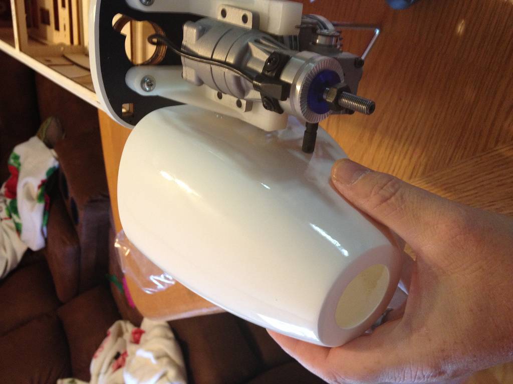

Got my Meridian and my Evo 10cc this week. Started the build last night. So far, looks to be high quality model.
Question, does anyone have any recommendation for mounting engine inverted or 90 degrees? The reason I'm asking is two fold, one to get a cleaner look on top of fuse without head sticking up and getting exhaust pipe on underside of airplane (if mounted 90 degrees). Suggestions? Comments, pics, already done it? Any advise would be great.

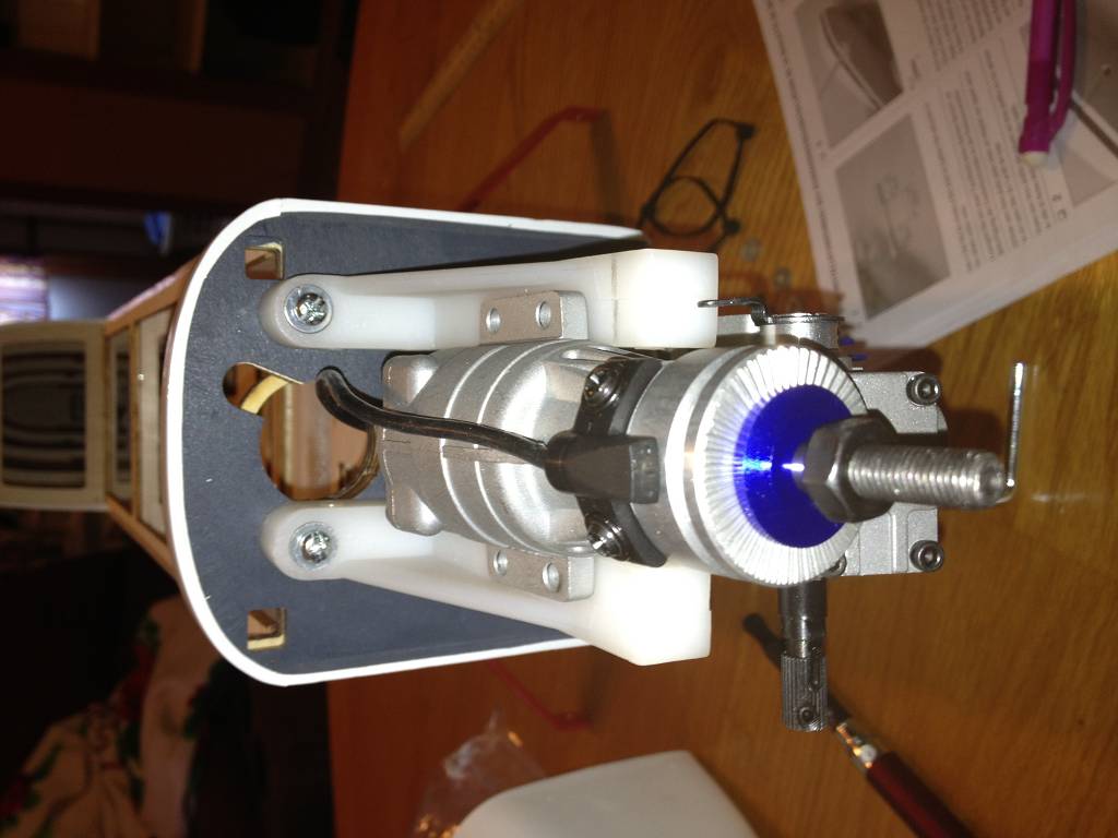

Inverted 10cc evolution engine in hangar 9 meridian. Will it work? I think I can trim engine mount to make throttle cable work. Any thoughts, comments, suggestions?

Line drawn on engine mount represents where it needs to be cut out.
