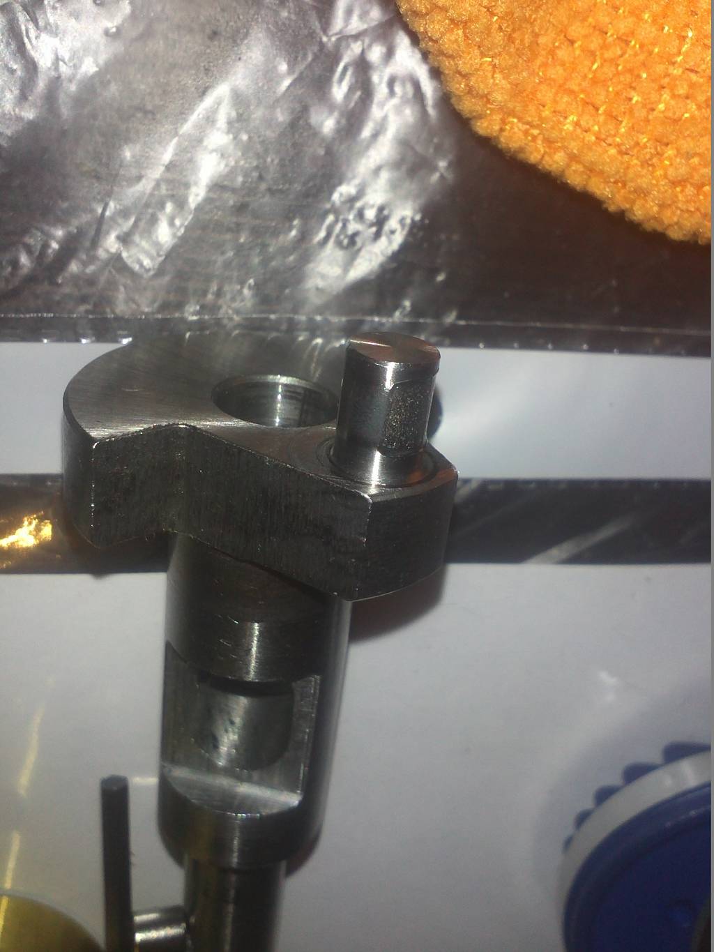

Clicking Noise.
My engine has around 25+ tanks through it and it's now making a clicking noise when running and is noticeable at idle /lower rpm. There has always been a slight click when rotating by hand and it seems others have that as well but it just started to be very apparent when running.
Still running 20"1 and switched over to Klotz about  8 tanks ago. Running an APC 13X6 and just tried a Vess 13X6. Have the carb tuned for good transition on low and peak rpm to where it's not 4-stroking in the air but yet not too lean. The engine is still performing well but now with this clicking.  When rotating by hand the click that was there is still there but not any louder. There is no end play or lateral play in the crank that I can feel.
Anyone else experiencing this yet?

Well I spoke with a "Tom" at Horizon and explained the situation. He said that Klotz oil should be OK as the only oil they know of that doesn't work well with their engines is Amsoil.
He said it sounds like a crank pin or wrist pin that could be making the noise and not so much the front roller bearing. He didn't seem too concerned with it and said keep running it and if it gets worse or the performance degrades then send it in.
I think I will remove the speak plug and get wooden dowel and hold down on the piston as it approaches TDC and see if I can "feel" the click or any slop . I'm not going to open the case and risk voiding the warranty unless told to do so..

I removed the plug(plug looked good with just a few deposits) and I took a wood dowel ,held it on the piston with pressure and while rotating the engine I believe I've found the "click" at idle/low rpm in the form of a little slop when the piston was coming up with a slight "clunk" as the piston dropped down a bit. Repeated and it was consistent.
Looking at the post and pics from "smsinfo" (elsewhere), he showed premature wear on the crank pin after tearing his engine down after some trouble. I am going to say it's the crank pin on mine starting to wear as well. I can't tell from his posts if he experienced clicking at idle/lower rpm on his.Here is his pic

I removed the backplate and it was clean inside. I couldn't tell if the crankpin is worn but it looks to be a bit irregular. I can see some slop between the pin and the needle bearing but I can also see a little slop between the wristpin/bushing too. The clicking at idle must be the movement (slop)of the connecting rod when under pressure. I can see and feel it move.
I also noticed what seems like excessive slop in the prop driver and the crank. Didn't look like any excessive wear on the crank, driver or key but there's about 2-3mm of slop back and forth . Just seems like there shouldn't be that much.
Here's some pics and there's really not much to see. Will require a tear-down to find out if anything is worn. Looks like I'll put the backplate on and send it in .

A club member of mine has two of these engines, both run great but one did start to make a clicking sound. After a call to Horizon, he deiced to send it in to get checked as its still under warranty. they said the crank pin was worn because (they think) it wasn't heat treated correctly. They pressed it out and put a new one it and the engine was good to go. never heard of a pressed in crank pin on a model engine but anything is possible I guess. At least that what he said they did.
the turn around was fast and he is once again happy.

That's exactly what Horizon stated on another thread. Early batches apparently had some faulty cranks due to inadequate heat treating. Looks and feels like the problem to me as well. It's going in next week.
Thanks for the post Bill.
By the way. What kind of oil was he using after break-in ?
I switched over to Klotz and Horizon said that shouldn't be an issue as the only oil they have a problem with in their engines is Amsoil.
