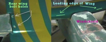

Hey Cliff,
I have done this on a couple SuperStar 40.. Even tho I know one can use a single pin in front I usually use two pins in front, and two bolts in rear.. Make sure wing fits saddle as perfect as you can.. I use a hardwood block to front of wing saddle to receive wing pins and a hardwood block with blind nuts to receive rear bolts... I have a twin stix that has four bolts,two front, two rear..
If someone can tell me how to add pics to these dang post I can try to whip up a couple as I have one I am doing right now.. I already have both blocks in but have not covered fuse yet.. Wing is done and covered..
I also change them from single Aileron servo to dual servo,one per side, so I have lots of room in wing center..

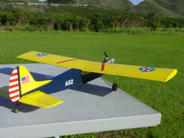

This a Global Right Flyer 60 size that was converted to remove the rubber bands.
Just added a piece of 1/4 lite ply to the front for the dowel to slide into, and bulit up the back saddle with a anothe piece of 1/4 with maple blocks under it. This was to allow the 1/4 nylon bolts.
Made a small cutout in leading edge of wing and insert 1 1/4 inch dowel with lots of epoxy...
Project was a lot of fun and aircraft flys great.
Hardest part was removing the sticky back covering.

Default WOW... Nice lookin plane !
Nice looking plane, which plane is this ? BH

bhouck
That is what he said it was.. And yes, it is a killer looking plane..
Almost looks like an ole Cessna 140..
Hircflyer
I would be interested in seeing a couple additional pics if you would like to email them to me.. [email protected]

Ok,,Cliff
Pictures would help if ya got'um.
I finally made a couple pics for you to see what I did on a trainer type plane... Aditional post/additional pics .....
Robby
Old 04-25-2002 | 12:29 AM
My Feedback: (18)
Posts: 2,252
From: SheCarGo, Sillynoise, IL
Default Tired of rubber bands!
Ok,,Cliff
Aditional post/additional pics ..... If you want larger I can email.
Robby
Old 04-25-2002 | 12:35 AM
My Feedback: (18)
Posts: 2,252
Ok,,Cliff
Robby

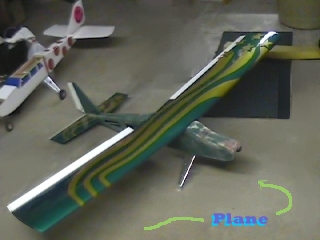

Old 04-25-2002 | 12:37 AM
My Feedback: (18)
Posts: 2,252
Ok,,Cliff
And here is a pic of what plane should look like when done...
Of course, that would mean I haffa git offa my lazzy duff and git it done...
Robby
