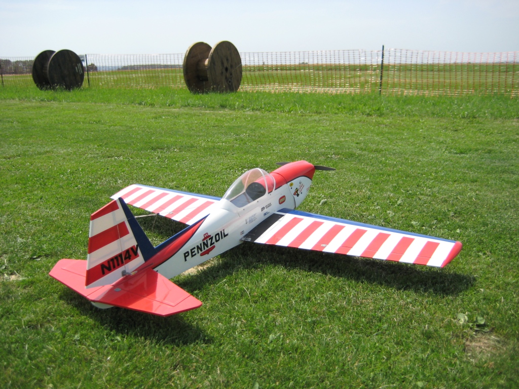

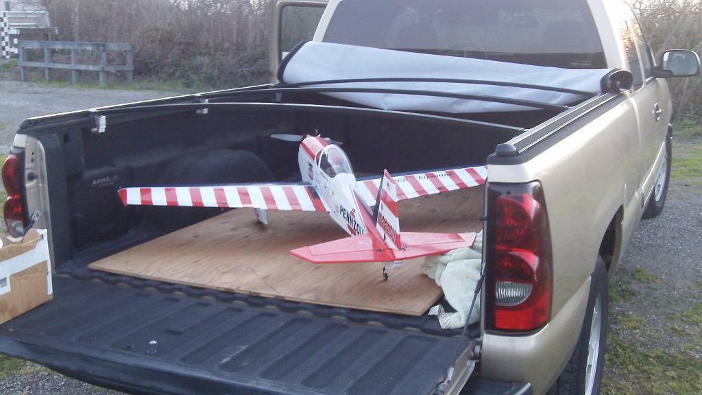

Today I completed the things I had to work on the Chippy like installing Jose', my pilot ( i just named him
) and sealing the seams on the Thouglong covering.
Yesterday I said I was going to be done by noon today, what do you know I was done by 3 pm just 3 hours pass the planed completion time.
The day turned out OK here in the bay area so at that time I decide to venture to the field, around 1/2 hour drive, when I got there I found one member already packing to go home, right away I put my airplane together, gas it and got ready to start the engine when I remembered that I had the glow igniter charging at home [:@], my solutions was to use the mini glow driver that I installed on my fuel box a few months ago, but not having the extension for the glow plug I had to dig into my field box to find a pair of alligator wires, I got the engine going with that [&:]
I got the range check done so it was time to fly her, on the first flight, well you have to see the video, I will post it soon ( working on it )

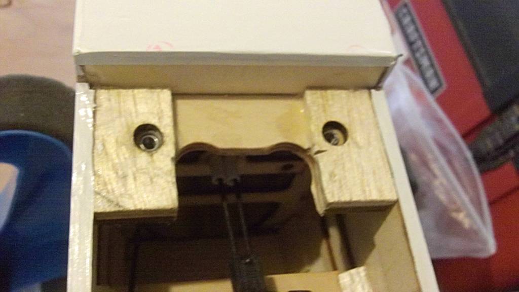

As Igot into the re-conditioning of my Chipmunk, Idiscovered that it has a Zenoah G38 engine and not a G26 as Iwas told when Ibought it. The power output is about the same but, the G38 will be a bit heavier due to the larger displacement. It should develop more torque though and that means a larger prop in length and pitch. It came with a nice Xoar 18x8 and it looks like it may be a good match for this engine/airplane combo. We'll see.
The project is picking up speed as I've removed all of the stuff Iwanted to change and started installing the equipement Iwant in it. Iremoved 2 heavy old NIMHbattery packs. One was completely dead but, the other is alive and well. I've ordered two LIFEPo packs to replace the NIMHs which will save about a pound of weight (well, maybe a half pound
Today I re-plumbed the fuel and smoke tanks, installed the fuel tank and ran the fuel lines, installed both electrical systems ...one for the ingnition and one for the receiver/servos, installed the smoke pump and feed line, installed the servo tray, the throttle servo, elevator servos (2), and installed the rudder servo. Ialso fabricated a new gear strut for the one that was missing. I'm glad I bought a 4 ft. section of 1/4" rod as it took a couple of tries before Igot it right.

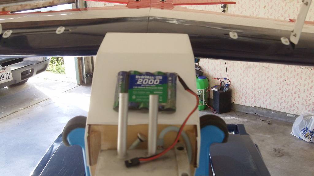

Nice going with the building cession, looks like you are well on the way with the chippy reconstruction, I wish I could get a bigger Chippy in the near future, how about some pictures when you get a chance.
I have been under the weather for the past three days ( no work for me

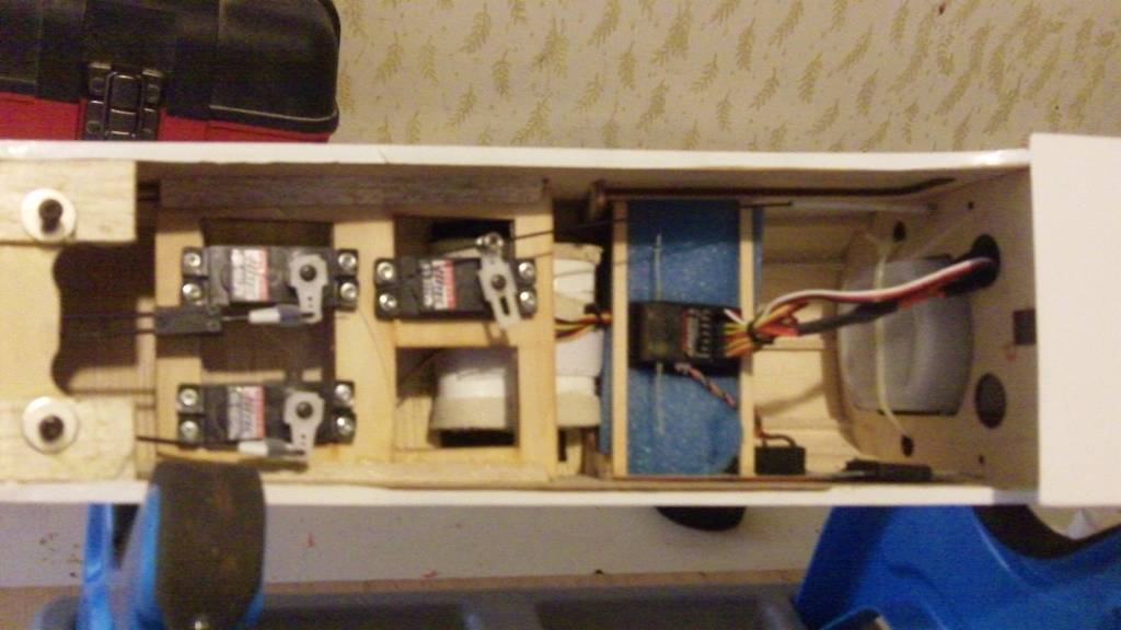

) but feeling much better today, I had a chance to keep working on my Chipmunk, had to move the battery about 10" forward to get her to balance at the recommended CG, the CG was about 3/8 behind the recommended point ( no wander she flew tail heavy the first flight [
] ) the battery ended up under the fuel tank and against the fire wall, also I clear some of the screws wing mount as the flaps torque roads were pushing it at full travel.

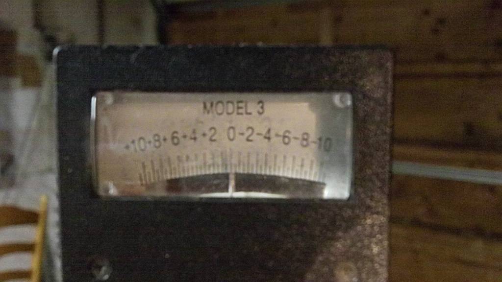

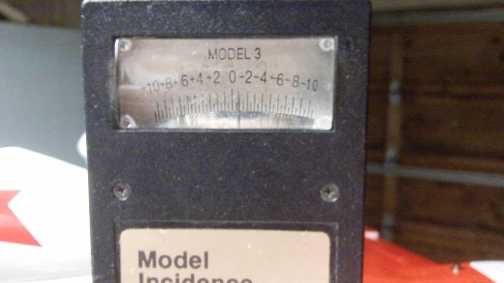

I did a quick check on the wing/stab incident and it looks like when the horizontal stab is at 0 degrees the wing has +1/2 degree of incident, now that I change the CG by moving the battery forward I like to see if the downward elevator goes away if it doesn't then I will have to take a closer look at the wing incident ( tomorrow Thursday test fly with new CG )
