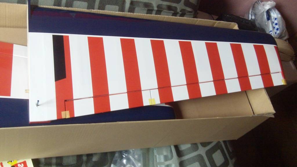

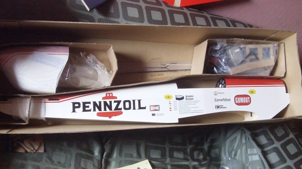

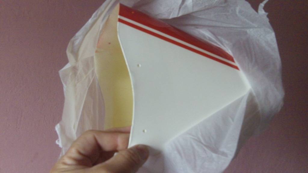

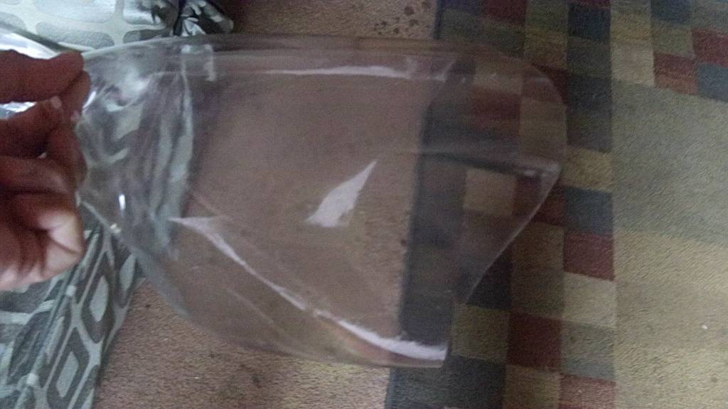

Here are some pictures of the kit, it all came in plastic bags, the manual is short and to the point, it has drawings of the steps to assemble the model are clear and the translation to English is very good.

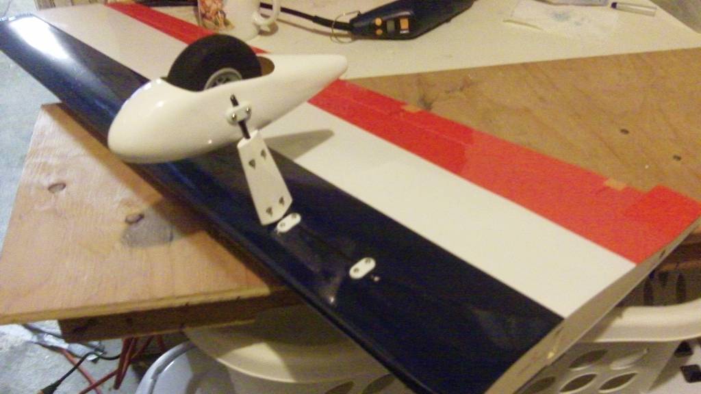

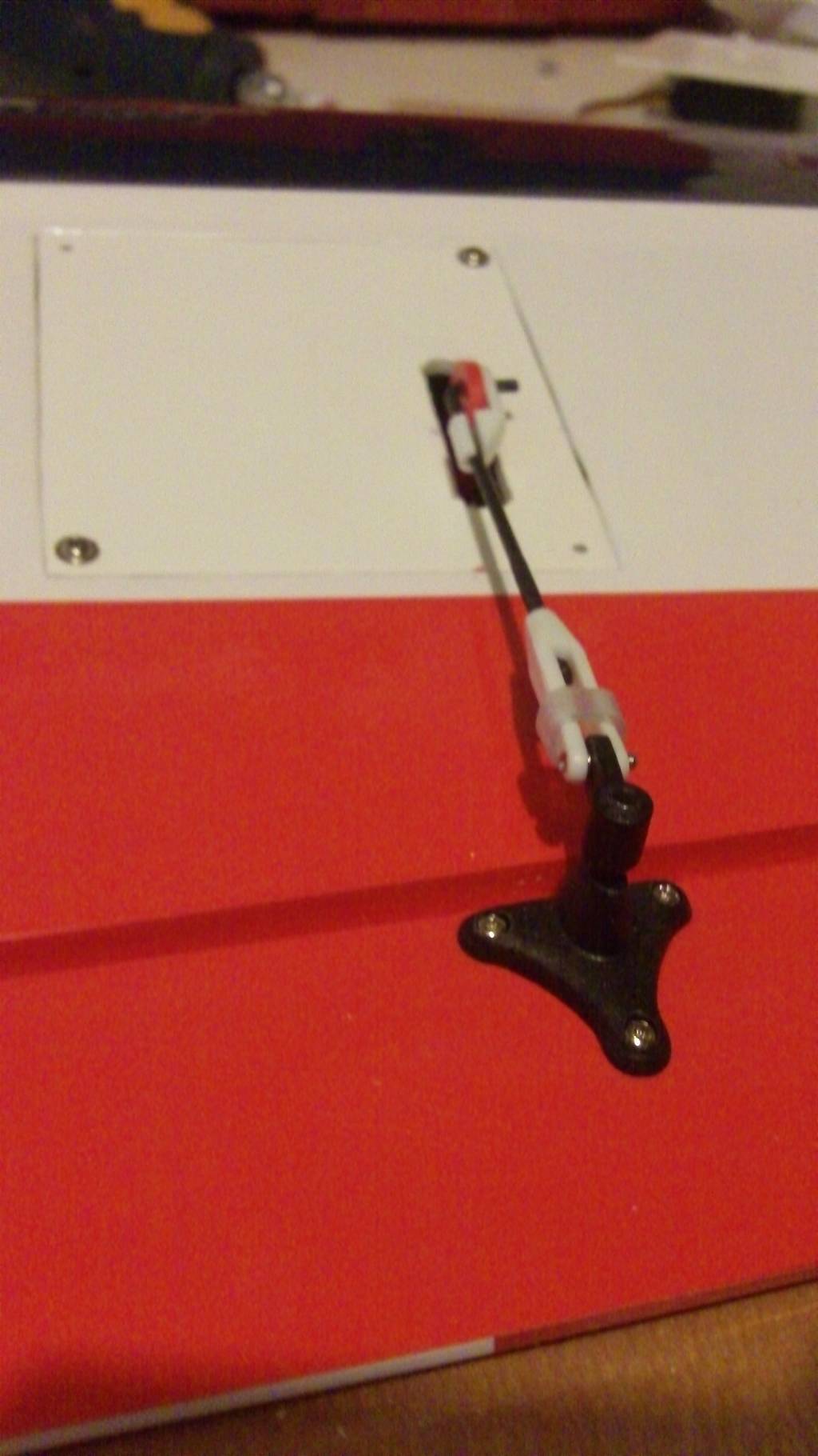

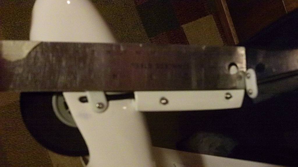

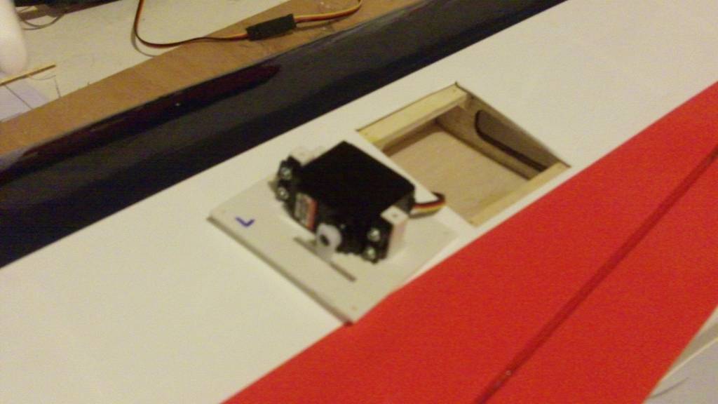

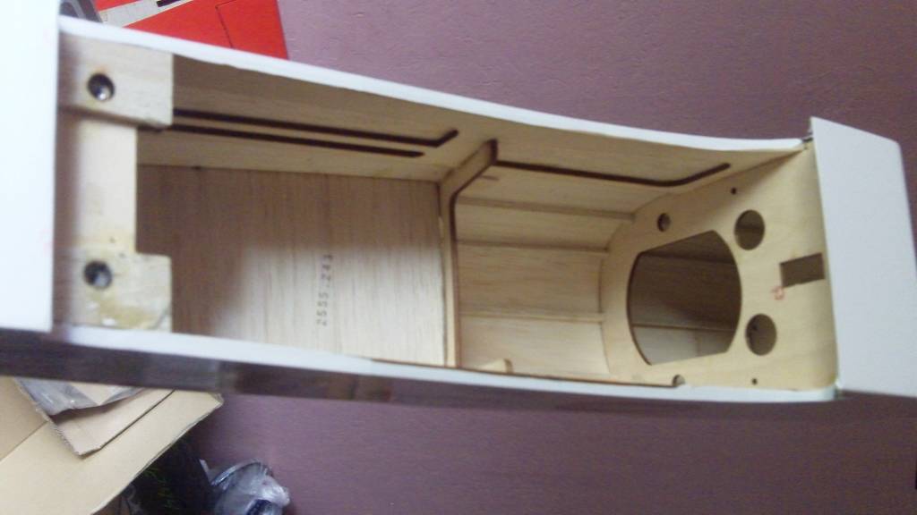

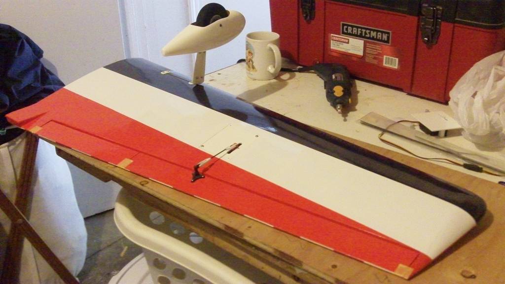

Completed the right wing, installed the flap servo, glued both half with 30 min. Epoxy.
I noticed the flaps torque rods were loose when I held the flaps against the wing and pushed on the rods, they just didn't have enough glue on the rods/flaps, I solved that by poking some small holes on the underside of the flaps with the exacto knife right over the torque rods and added thing CA to it, problem solve, now the flaps are very solid.
When gluing the two half first I dry fitted them, end up shaving the corners of the wing joiner to have a loose join, when gluing it it was much easier to slide together, the center join is perfect no gap, very clean.

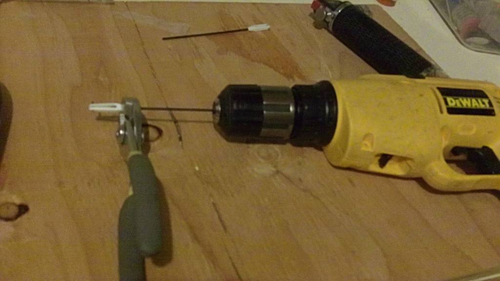

Now moving to glue the tail feathers, I noticed that with the travels recommended in the manual I couldn't get it to travel without having the elevator in the rudder's way, my solution was to cut about 1/4" from the bottom of the rudder to get enough clearance for the feathers to travel all the way to the recommended distances.
I couldn't upload the pictures of the construction earlier because the wifi at home wasn't working, I'll try tonight again.

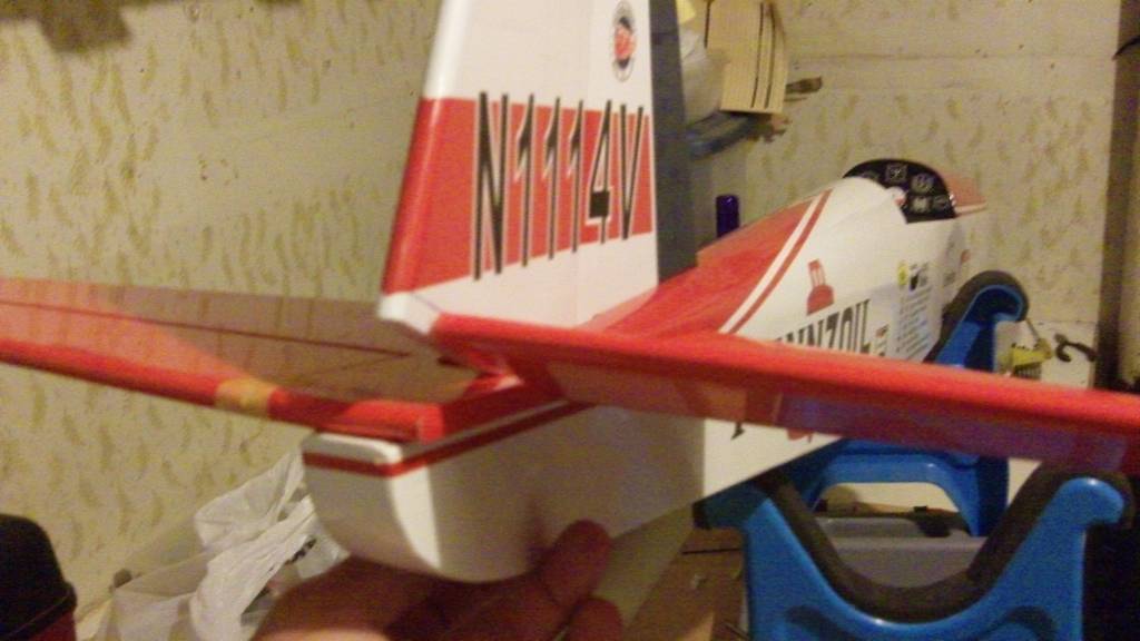

So far only two things needed some attention, the clearance of the elevator/rudder and the loose torque rods on the flaps, so far it is going fine with the build, I fitted the wing to the fuse and it slides in perfectly, no gap noticed.

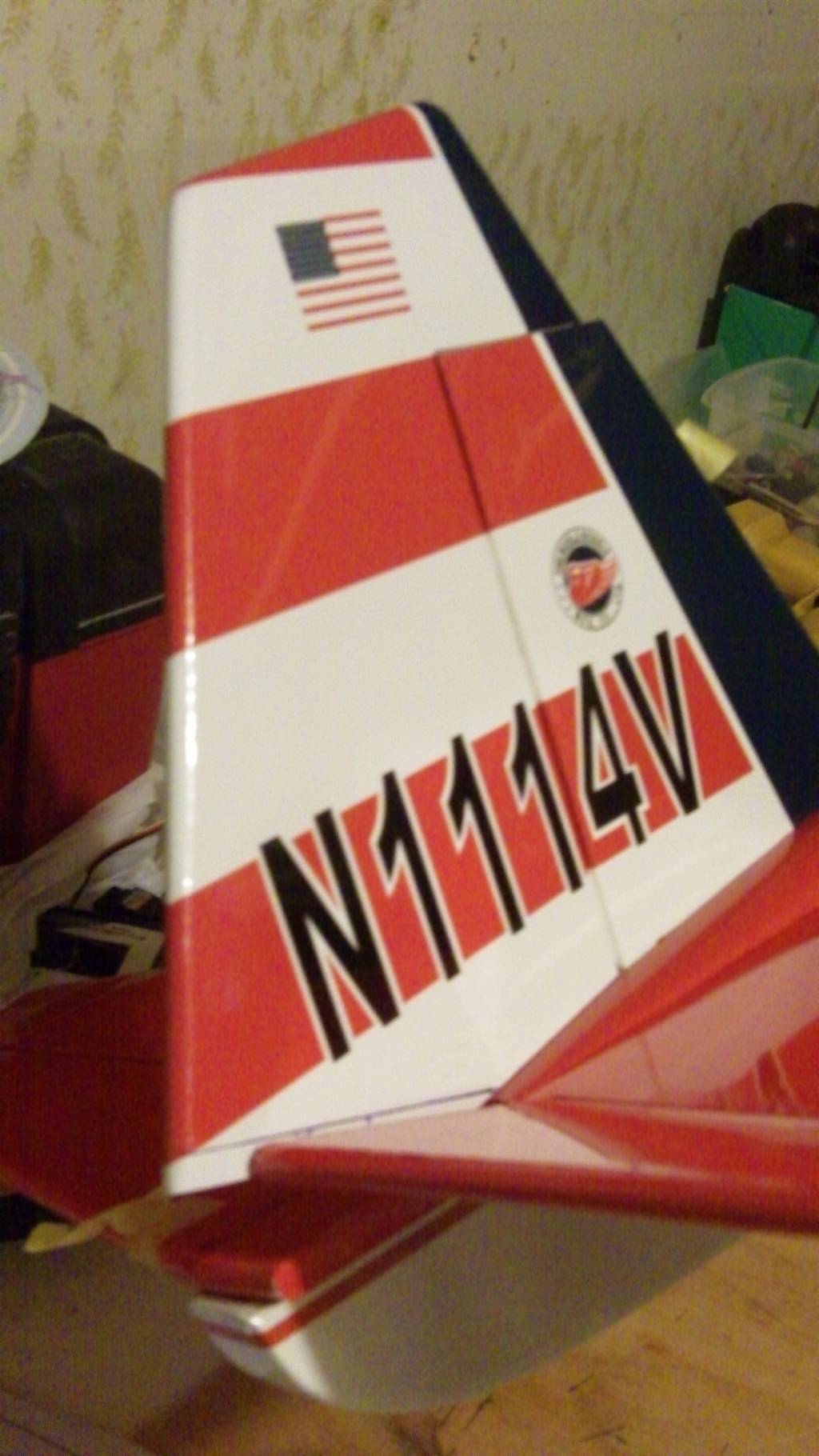

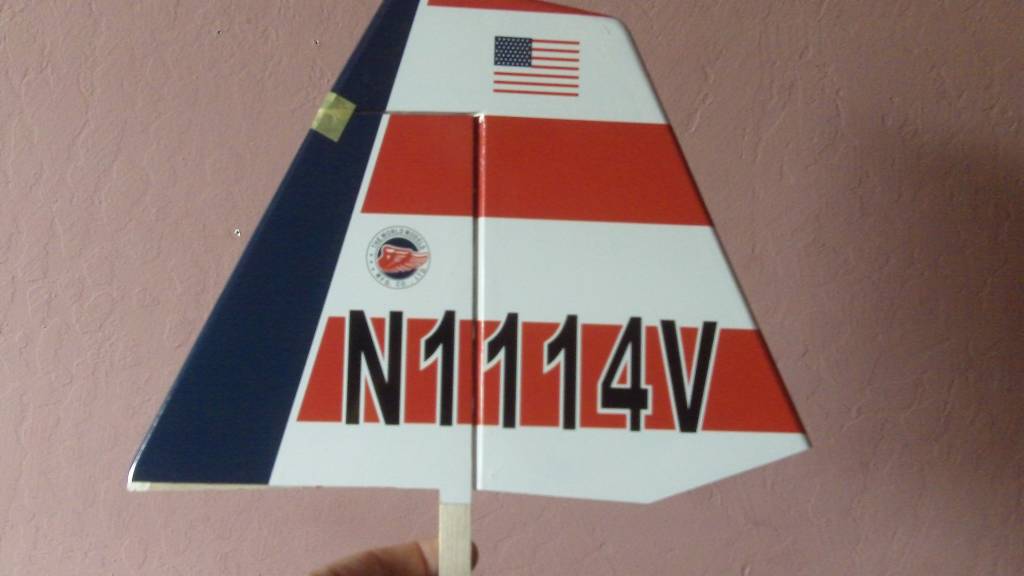

I cut about 1/4" from the bottom of the rudder to be able to get the proper clearance to get the suggested travel on the feathers.

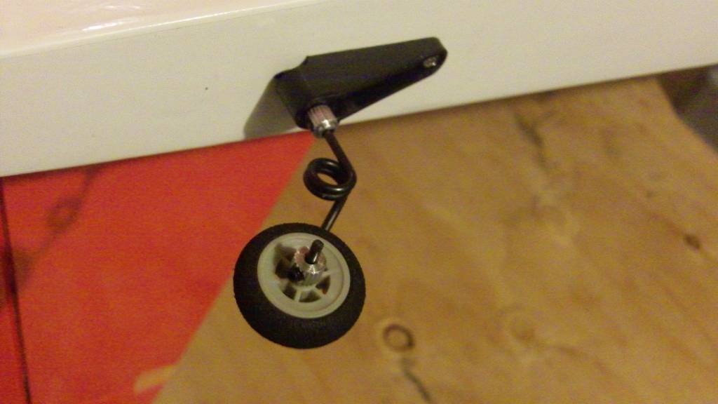

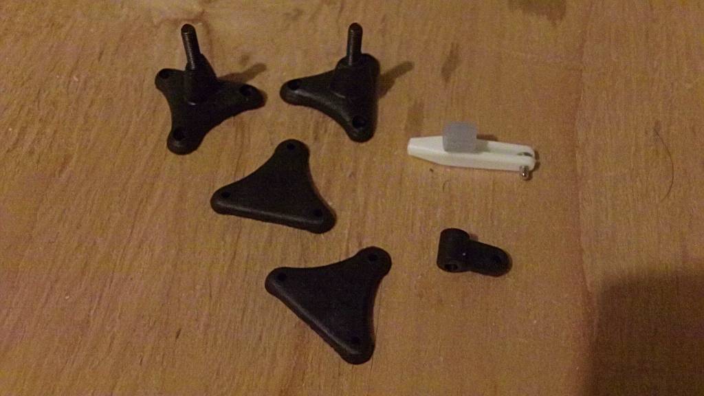

Regarding the rudder and the tail wheel, the instructions show how to assemble the parts, what the instructions do not show is that you have to cut a groove under the rudder in order to have a functional mounted tail wheel, this was easy to do, the vertical and horizontal stabs were very easy to assemble, no surprises there, also it didn't take to much to align the horizontal stab with the wing.
Here is the before and after for the rudder

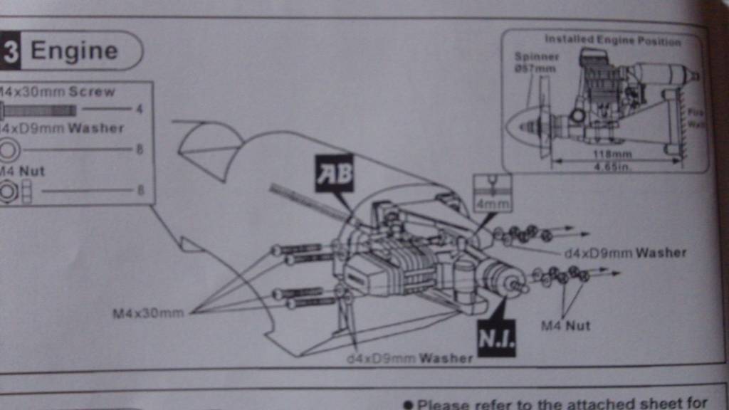

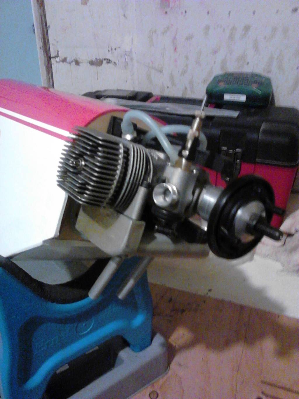

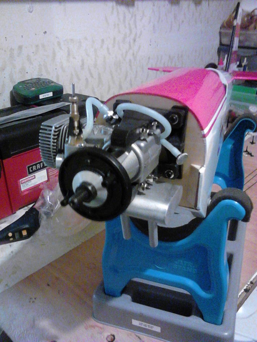

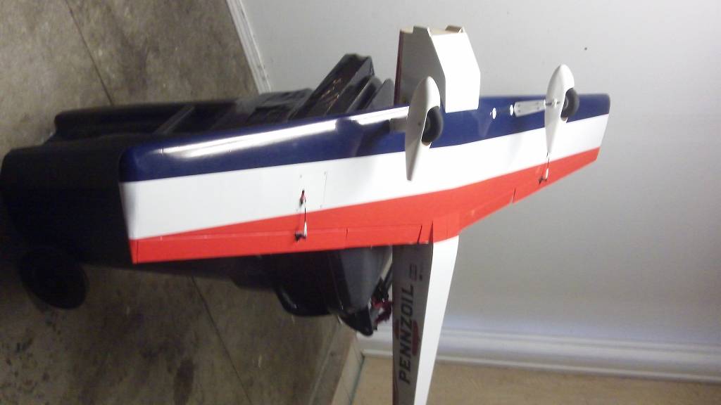

Today was a super build day, on a day like this I try to build as much as I can for at least 8 hours almost none stop ( only to eat and to run to the bathroom ), this usually happens a day before the kit is done, the next day is completion and detail day and if I'm done around noon then I go to the field ( weather permitting ) to run the engine if the engine runs good then I give it a go for the maiden flight, it may happen tomorrow Friday.
I said I was going to use my 4 stokes OS Surppass but for the moment I will be using my Super Tiger 90 with a Pits style muffler, I'm going to work on the cowl once I decide if the Super tiger stays on the Chipmunk.
