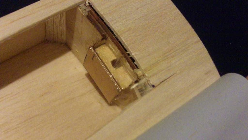

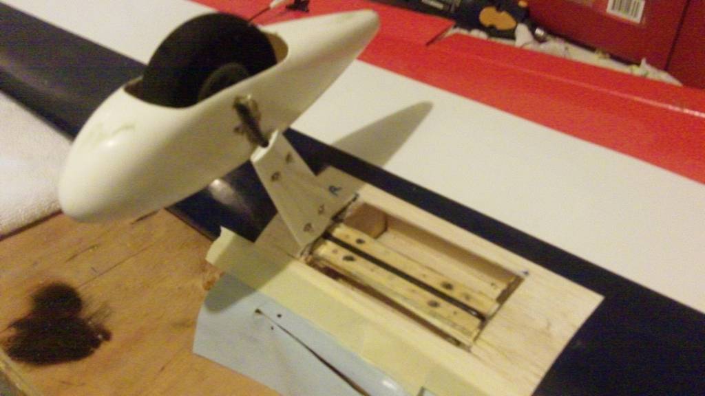

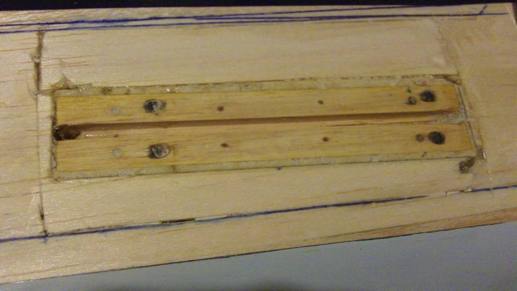

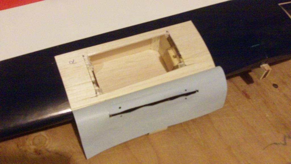

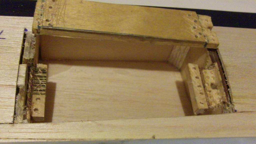

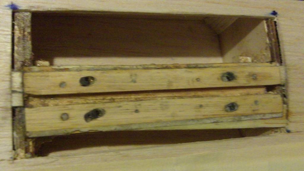

I Started the main gear rails repairs, as suspected not enough glue on the rails and with the wood been burned by the laser the grains gets sealed and the glue doesn't get there at all, also the china ply is very brittle [:-] I new this had to happen it is a down side on the ARFs ( all of them )
Since the rail on the right main splitted in two I added a 1/16 ply piece under to reinforce it ( looking at the simplest way to fix it without reinventing the wheel ) I used 1/16 aircraft grade ply, 1/4" basswood, 3/32 carbon fiber rod ( instead of using wood nails ) 30 min epoxy, 5 min epoxy, thick CA/accelerator.
As you can see the basswood block use to stop the wire from rotating is now in a ply box to stop it from splitting because of a hard landing, the carbon fiber nails are in on a angle ( like 45 ) from the rail through the 1/4" basswood through the play and balsa ribs.

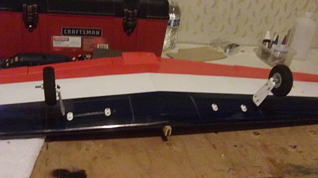

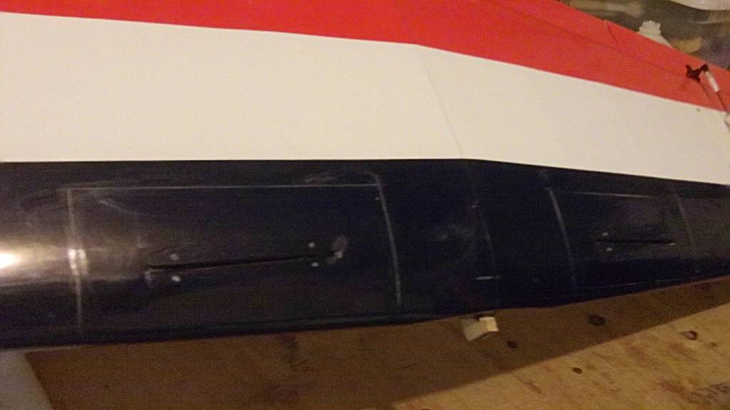

Repairs are completed, will go flying on Sunday, too windy to day and tomorrow I will repair the wheel pants next week ( not much to do )

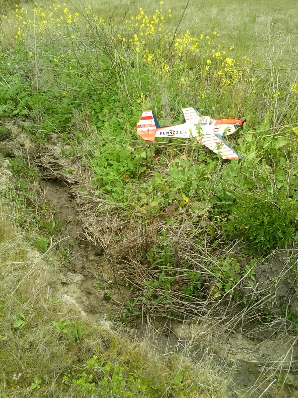

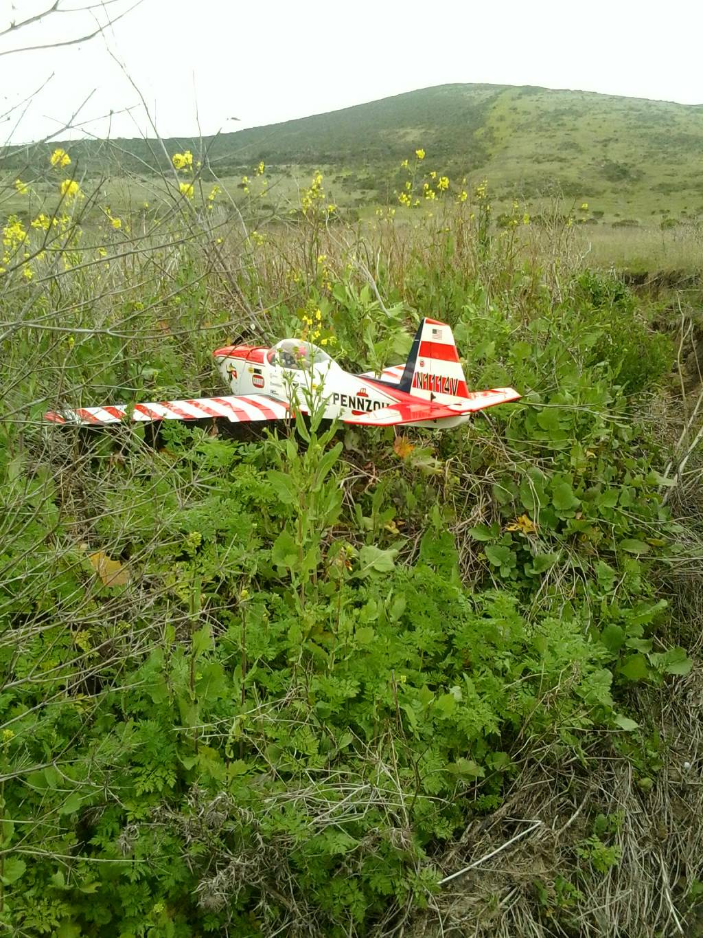

Went flying yesterday, on the second flight my engine quit, it was low, mid runway, going up wind, needless to say it was not good to turn around for an up wind landing and no way I could do a left 180 to land down wind so, I went forward but she keep flying added flaps and she keep flying, finally she came down past the runway and then some, when she landed I could not see how she landed all I know is that I flew her all the way down to the ground and I imagine landing her.
I was very upset, I thought I had the engine dial in, as I was walking ( the walk of shame ) I could imagine the damage ( I was mad [:@][:@] )
To my surprise [X(][X(] she not only landed without any damage but a loose wheel pant, she had manage to avoid total destruction by landing about a foot or two past an 8 foot ditch [&:]
My conclusion was that the carburator was lean at the low end, after fixing the pant ( about three drops of thick CA ) the carb was adjusted and took her up for anothe flight, all went well with that flight so, my plane came home in two pieces ( as it should be )
