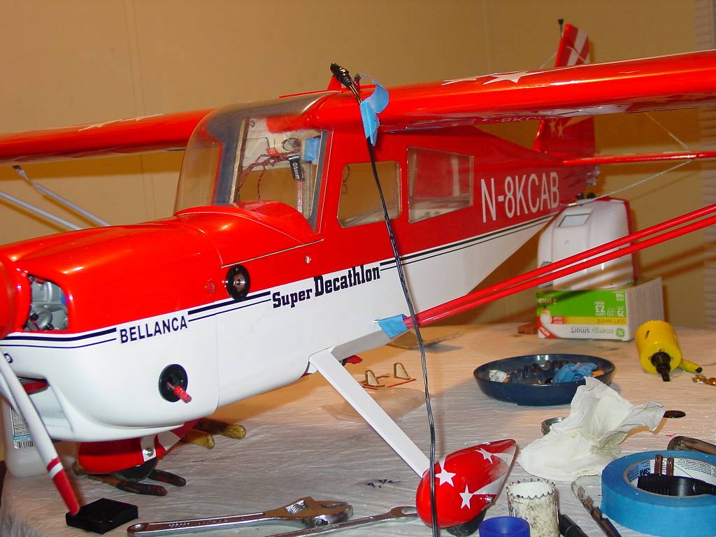

Im Balancing My Plane per specs of 70mm or 2 3/4" behind trailing edge And They Say a Little Nose Heavy Is Ok but wheres the line on a little iv balanced mine with level bubble off the horizonal stab running with the fuse and iv got a 1 1/4 inch drop in plane from the point of level to nose Measuring from a fixed point on plane from both level to free standing is 1 1/4 inch drop is this ok or do i need to back some weight off nose a little  the Plane is A Super Decathlon .46 By Pheonix
Old 03-06-2013 | 09:41 PM
Joined: Mar 2013
Posts: 9
From: Athens , TN
Default RE: Question on balancing plane
NOTE That The Fixed Measure Point WasAt Rear Of fuse Just In Front Of The Stablizers so measurement will be greater than if Measured at front of plane the drop indicicated in level bubble was bubble just left outside the the marks

Just Checked The 1 1/4 Drop Was Measured 20 inch Back From Pivot Point

Just balance it where the tail doesn't drop at all...remember this....extremely nose heavy may be difficult to fly...a tail heavy plane will probably crash!!

Dang Must Have Been tired when i post last 2 postI hadplane balanced with 1 1/4 inch drop in nose but iv backed that back off to1/2 inch drop it should be good there
