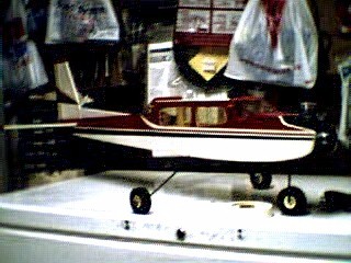

Mike Bogh:
Thanks again for the reply. Attached is a photo of the fuse, with the tail feathers just temporarily in place.

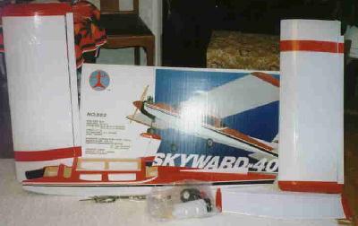

Mike:
Sorry, wrong pic. That one was how I found out what it was. Here's the right photo.

Hideho Dennis,
You know what? I'm going to go out on a limb here and suggest that you just assemble this plane the best you know how. Use common sense and just make sure the horiz stab and vert stab is lined up 90 degrees to the fuse. The incidents should be built in.
If you want to, you can go to www.horizonhobby.com and download the instructions for the easyfly 40 or the Easy 2 and use whatever info you find applicable to your plane.
The nice thing about trainers is that unless you have a horrible warp built in, they all pretty much fly about the same.
The servos all go in about the same place, the battery and rcvr usually go foreward of the servos under the front of the wing against the former.
I don't think you'll have any problems, honestly, and if you do, were here to help.
