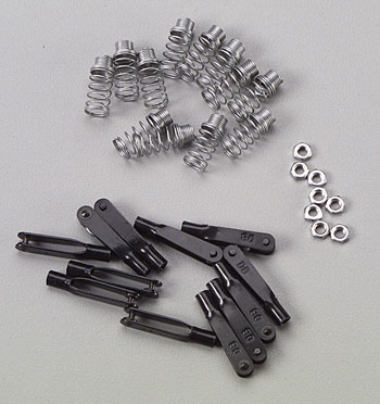

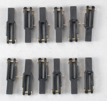

Hi,
I'm upgrading an GP revolver 70 to 4-40 control rods I've been looking at which clevis to use. The two that I'm looking at are,
Dubro safety lock kwik link
Dubro kwik link metal
I think that the metal clevis would be the best option. I'm looking to see what experience others have had with these item.

I have always preferred the Sullivan Golden clevis. I like the security pin that attaches. Check them out as a 3rd option.

It would be "Dubro safety lock kwik link" for me. Not a fan of metal clevises.

I use both types with equal success. The nylon ones are larger and may not "look" right on some models where the metal ones are a bit slimmer. Use the ones that you think look best on your model. If using the metal ones with metal pushrods make sure you use nylon horns so there is no metal-to-metal contact/vibration.

and make sure the lock nuts are tight frequently! Unsecured metal clevis on metal threads (usually a sloppy fit) will vibrate the threads to nothing eventually....

Hi All, Thanks for the reply's looks like either option will do providing check nuts are used with metal clevis. Think I will use the Dubro safety lock kwik link.

Metal clevis on one side and plastic ball links on the other. Both of these are the same, the spring just acts as the keeper that you would otherwise use a piece of tubing. The nut is then not very critical. Its got some play but nothing too bad
