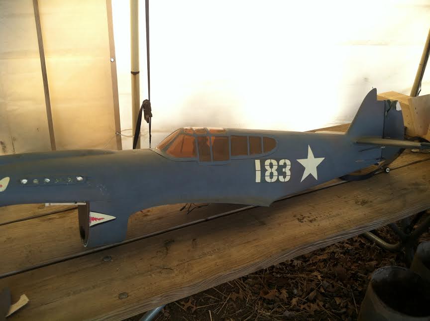

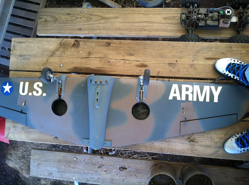

I've picked up a used CMP, P-40 ARF and intend on doing something, different. I've always wanted to model the Curtiss A-75 Hawk or the P-36 variant.
Since the CMP ARF features a fiberglass fuselage, this will necessitate slicing the forward fuselage off just forward of where the sharkmouth is seen. Installing a new firewall fiberglassed to the inside
of the cutoff and installing radial cowling mount tabs shouldn't prove too difficult.

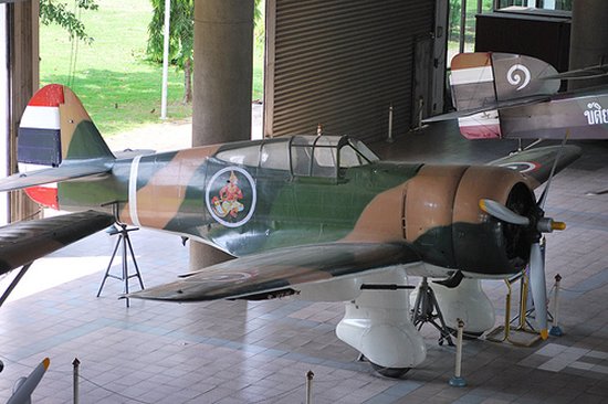

I considered doing away with the 90 degree Jet Hanger retracts and fixing the gear to make the export version as sold to India and Thailand in the late 30's. This would simplify things and reduce the space needed for pneumatic plumbing. However, at this point I'm still undecided. If I were to go this route, I would have to fabricate wheel pants and spats.
Eliminating so much fuselage length would naturally change the weight distribution, probably making the plane tail heavy. A radial cowling would enable amply space for additional ballast or choosing a heavier powerplant, perhaps.
Any thoughts?

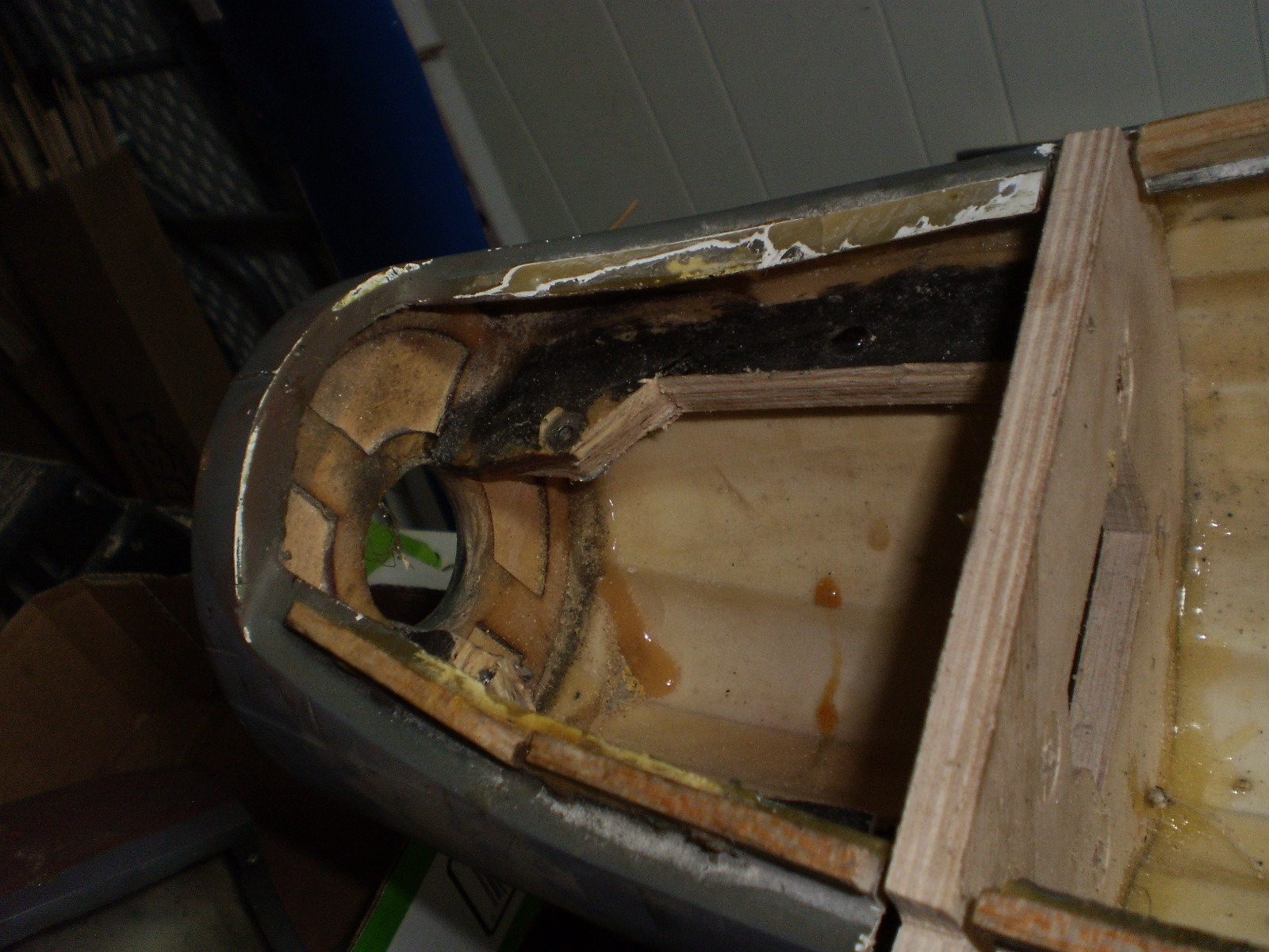

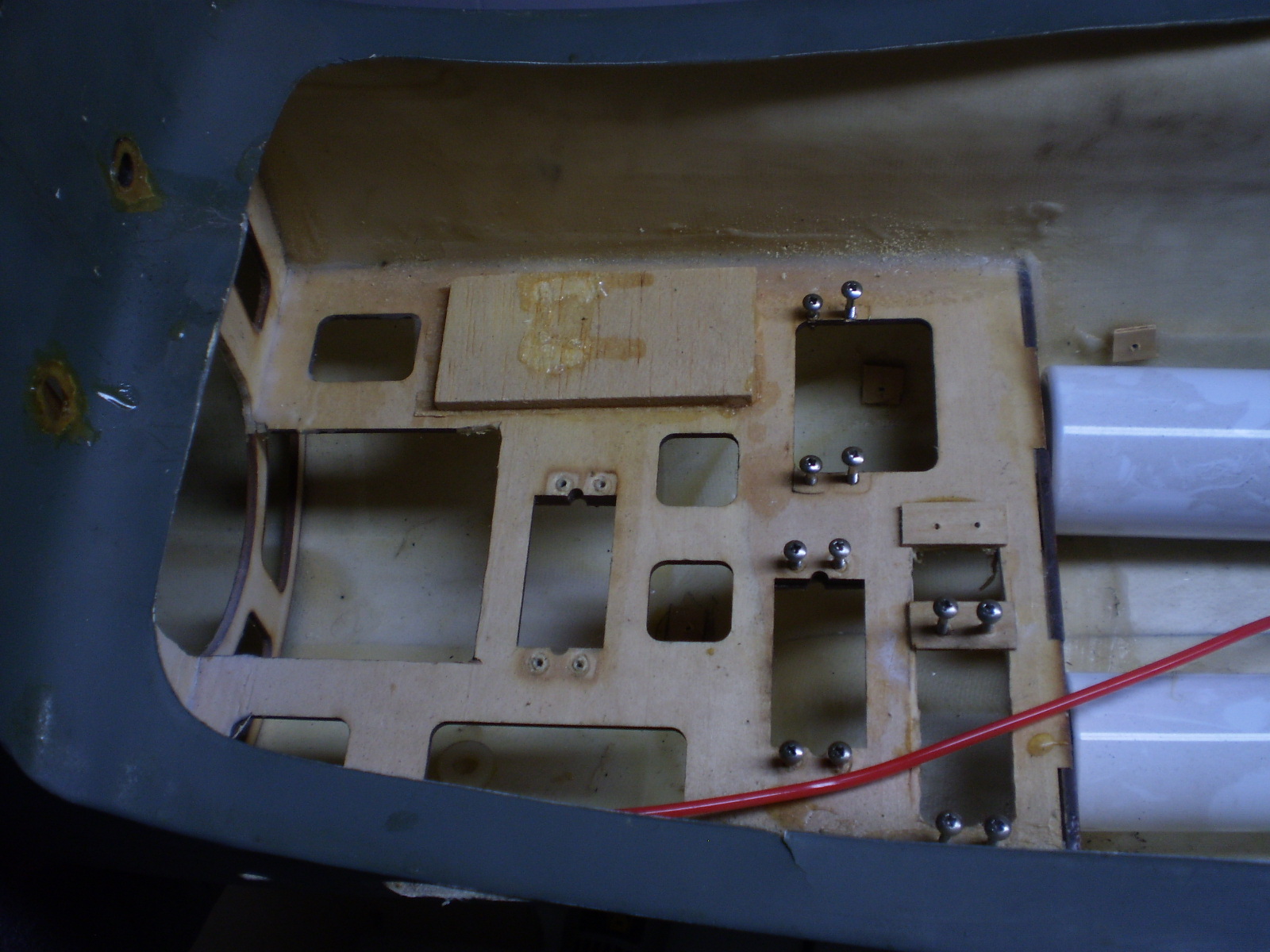

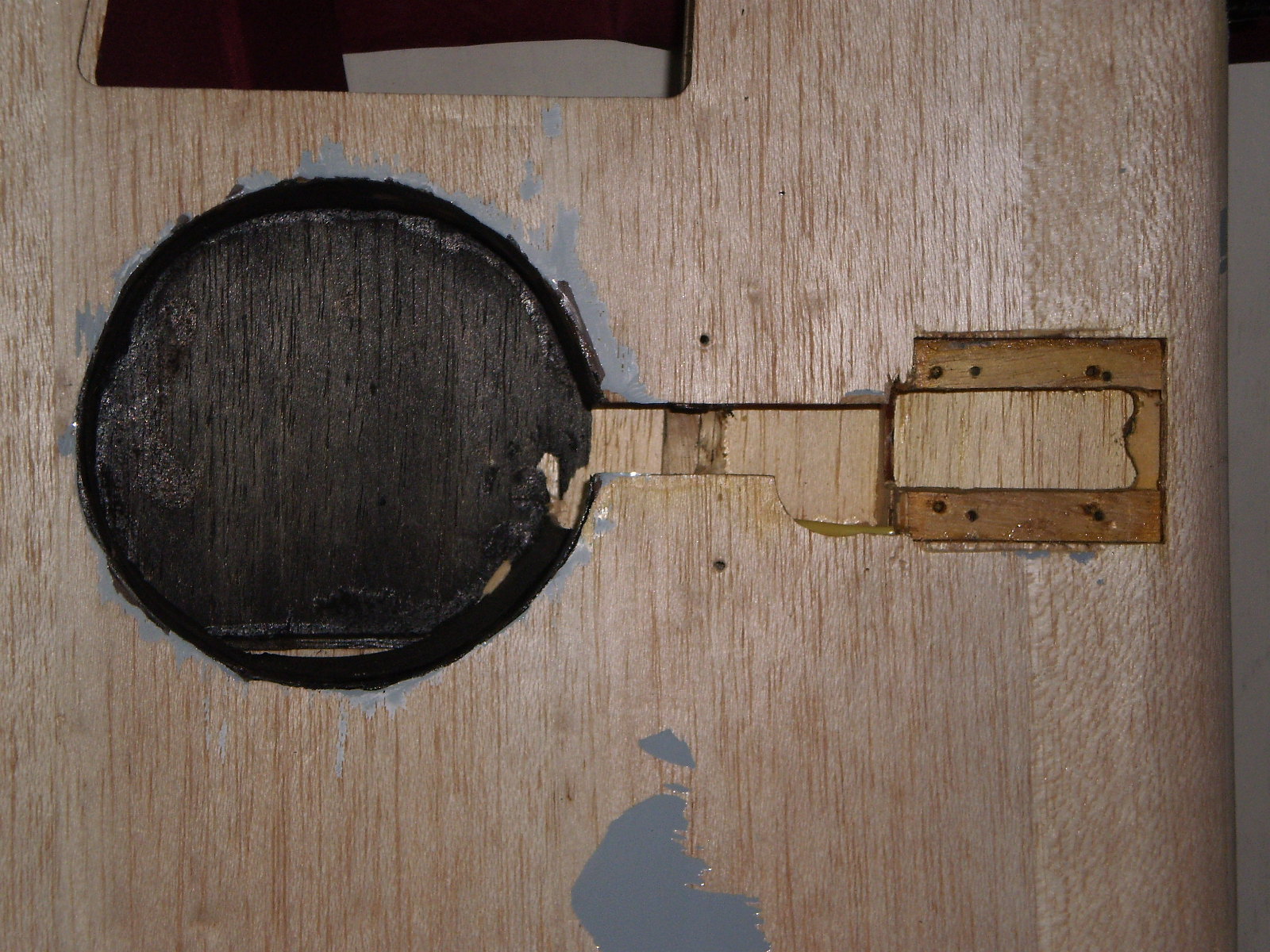

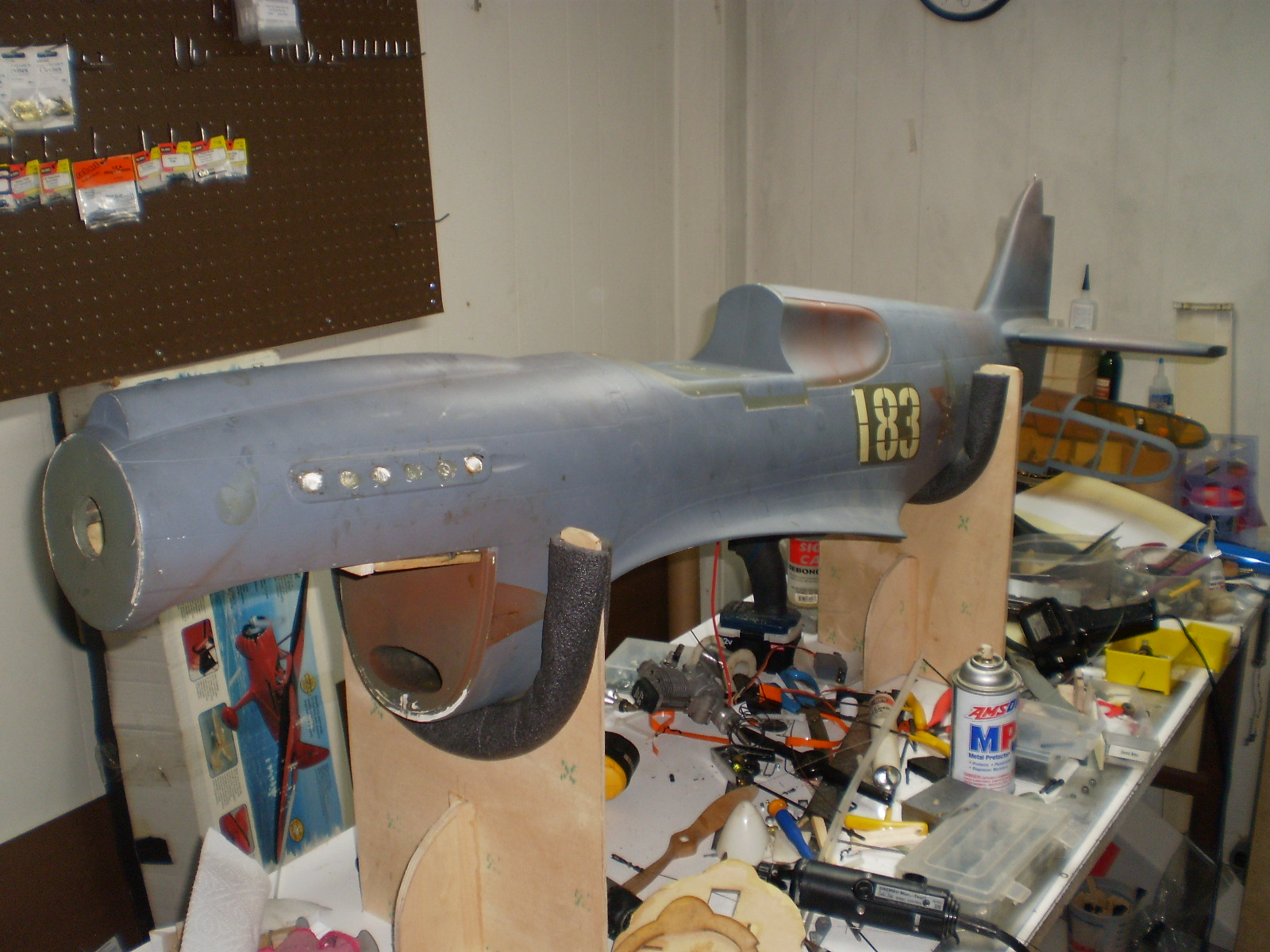

Brought the P-40 home this weekend and started the process...

That appears to be a P-40E fuse. A P-40B/C would be closer to the P-36 as that's what the 'B/C' was developed from. The 'E' came later and there are some differences in the cockpit/canopy area and the rear fuselage between the canopy and the tail. I don't mean to be critical of your project. I just don't know if you're aware of these differences.

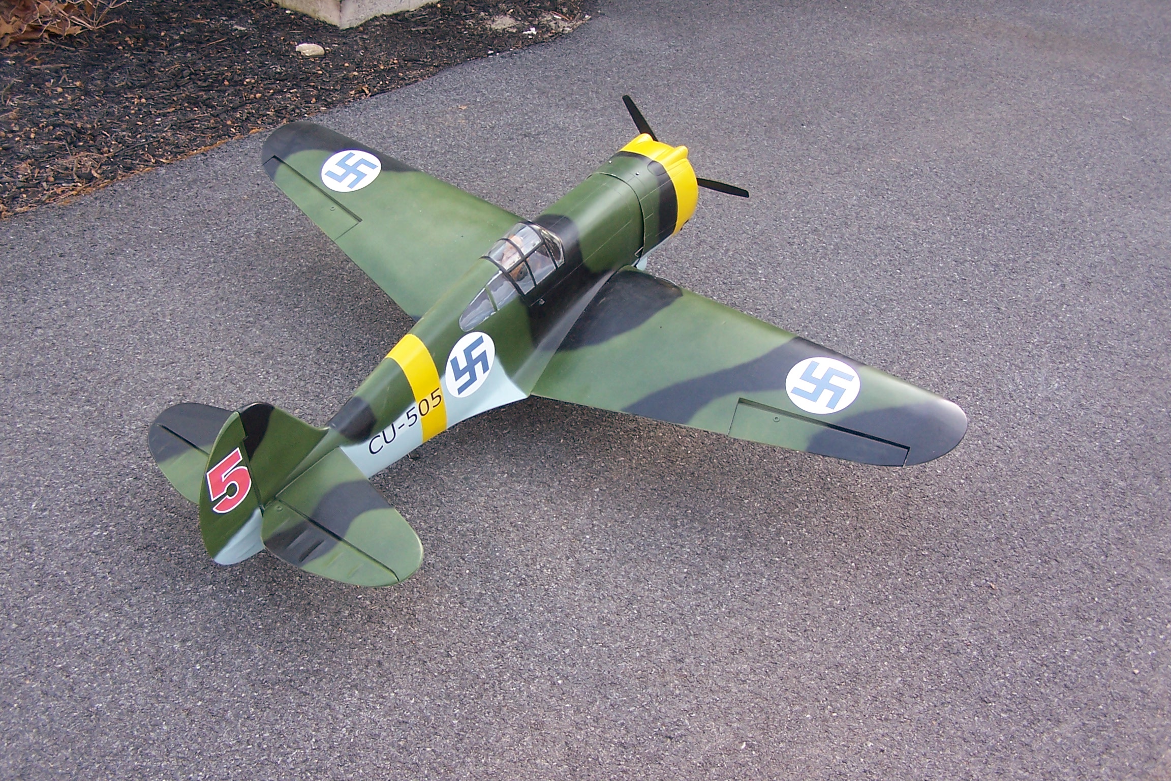

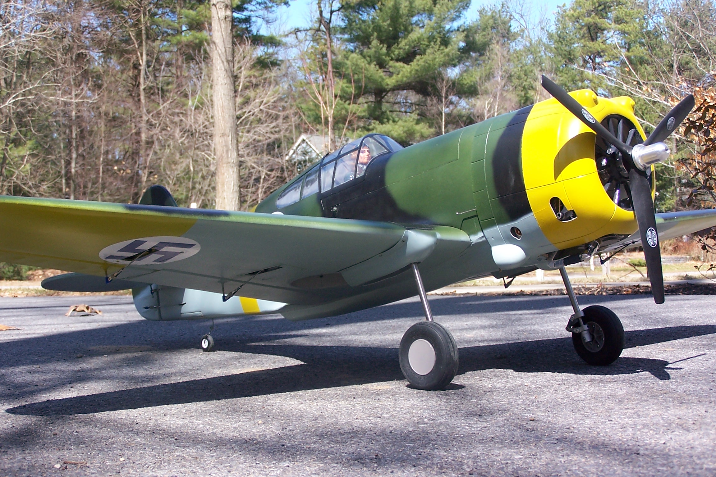

PonitMagu, go for it. I alway thought a P-36 was a great looking airplane. I converted a 65" ws BH P-40C to a P-36 (Hawk 75) in Finnish colors. Unfortunately I lost it getting too low and slow, snap rolled on delayed go around, cart wheeled down runway and totally destroyed. However, P-36 cowling survived and I was going to get he Top Flite 60 size P-40 and convert. Since I have decided to do that the ARF has been "temporarily unavailable" for the last 8 months. Here are some photos of the P-36. Used CJ retracts and RCGF 20cc gas engine.
