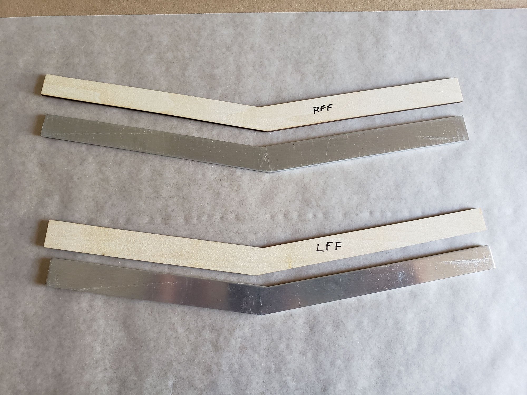

The wingtip joiners are very specific in their orientation. I'm trying to keep the most weight up front as possible so I'm trying to make sure aluminum plate is toward the nose when inserted, hence the markings. Wider side goes into center wing panel and slimmer side into wingtips.

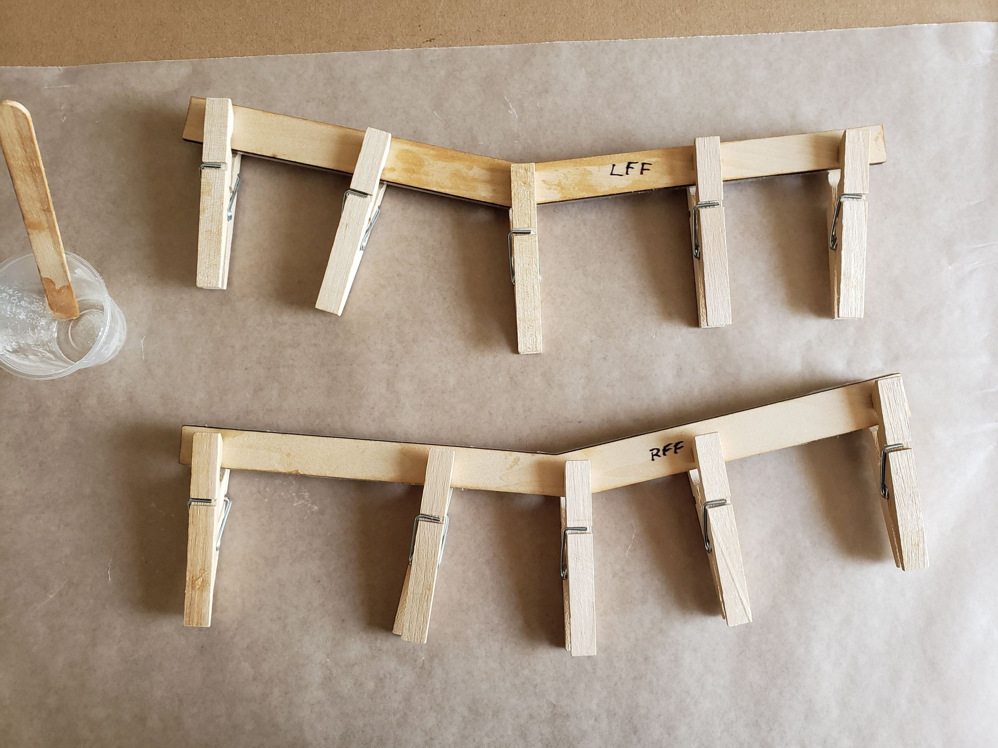

Been a few days, had a drive fail on the PC....FIGURES! After six years of service, it deserved to RIP anyway. Have to say, while a beginner might be able to fly this, one might not be able to assemble it. The wing joiners are very loose in the center and wingtip pockets. I've been coating with epoxy to see if I can get a little more tightness out of them. Be warned, if you need to sand them to make fit, sand very very little at a time. These receiver pockets are not tapered and it might be something as small as a drop of glue on a joiner in the way. They were very hard to get in the pockets and then I sanded very lightly, now they're too loose. Would like to keep this a 3-piece wing but it's not looking that way. We'll see how the attempt to get a few microns back with the epoxy works out. In all, I feel like Tower could have done a little more in this and the spoiler hardware area. I'll get to that spoiler next and explain.

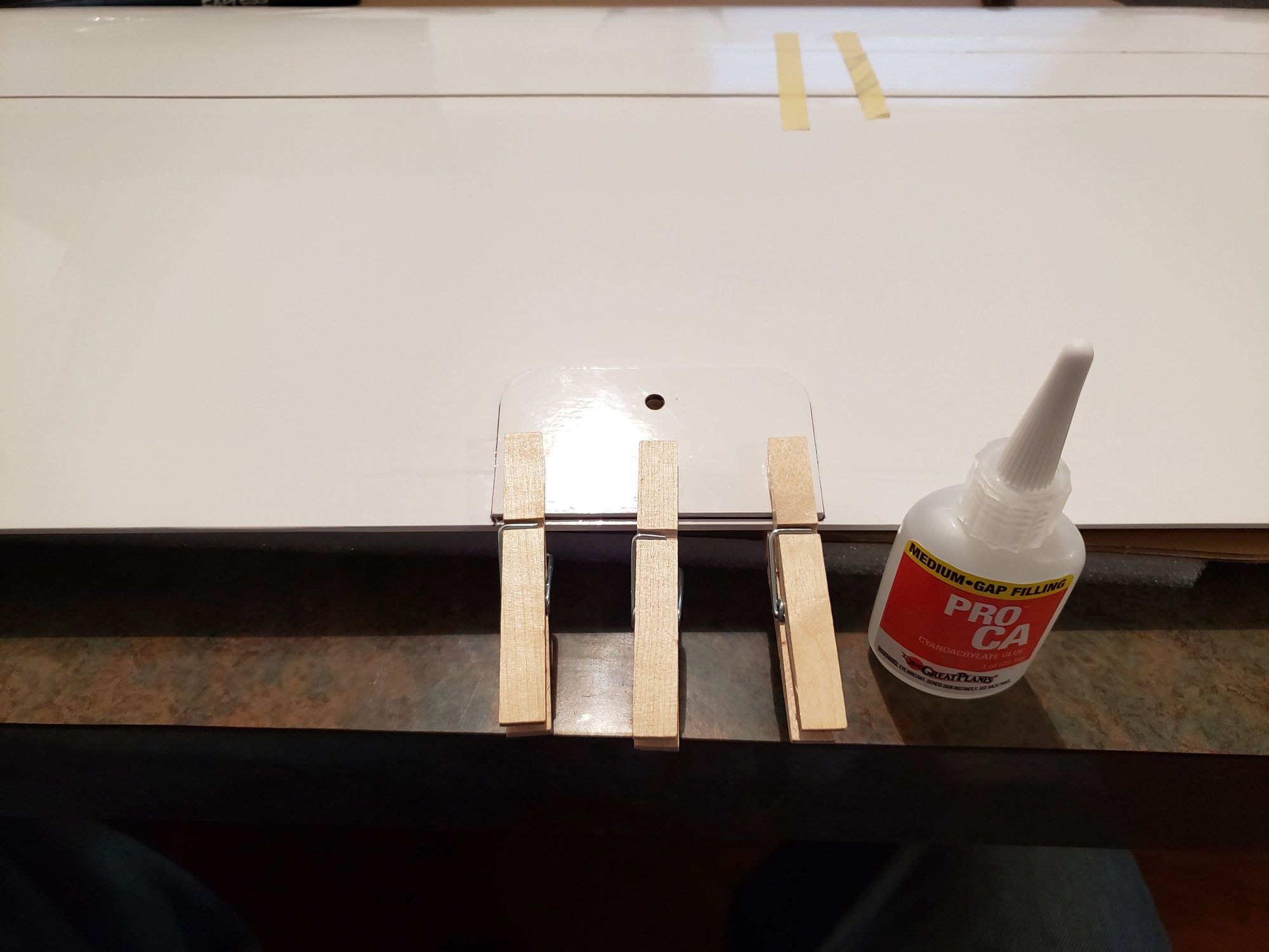

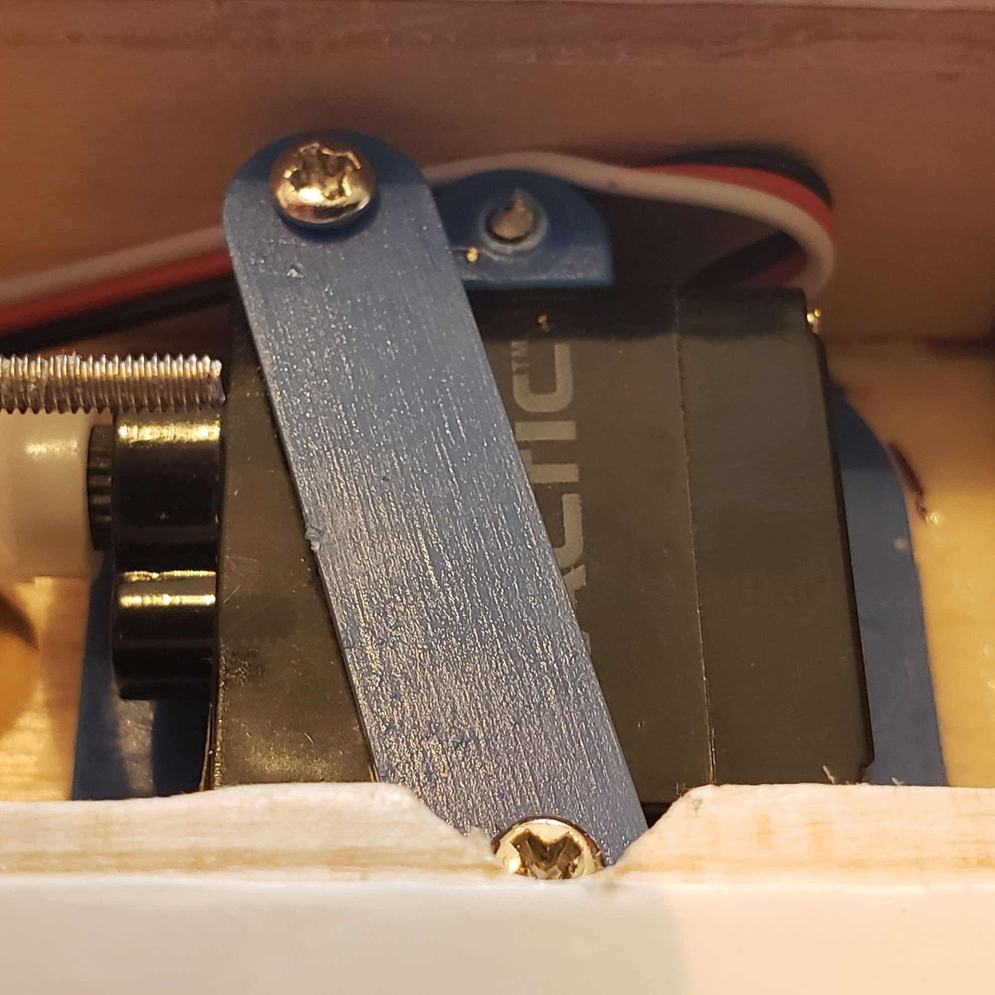

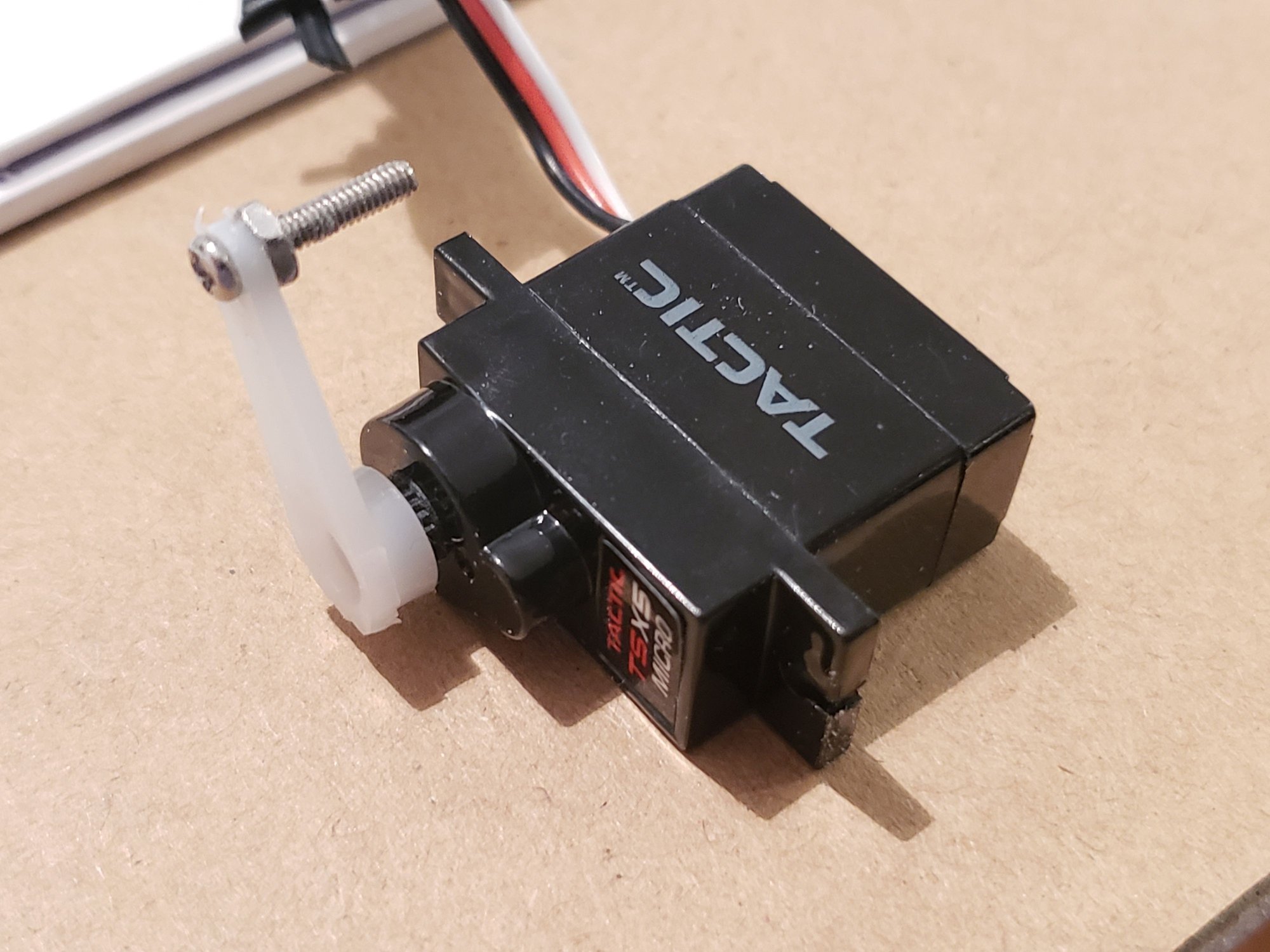

Now for the weakest link...Literally!!
The hardware included in these next steps are just this side of rinky-dink.
First have to get your servo arm ready. The instructions say to go all the way to spoiler open position
and place arm a few degrees forward of that but this did not work for me. I'm placing control on channel 5, which
is left rear slider on my Tx.

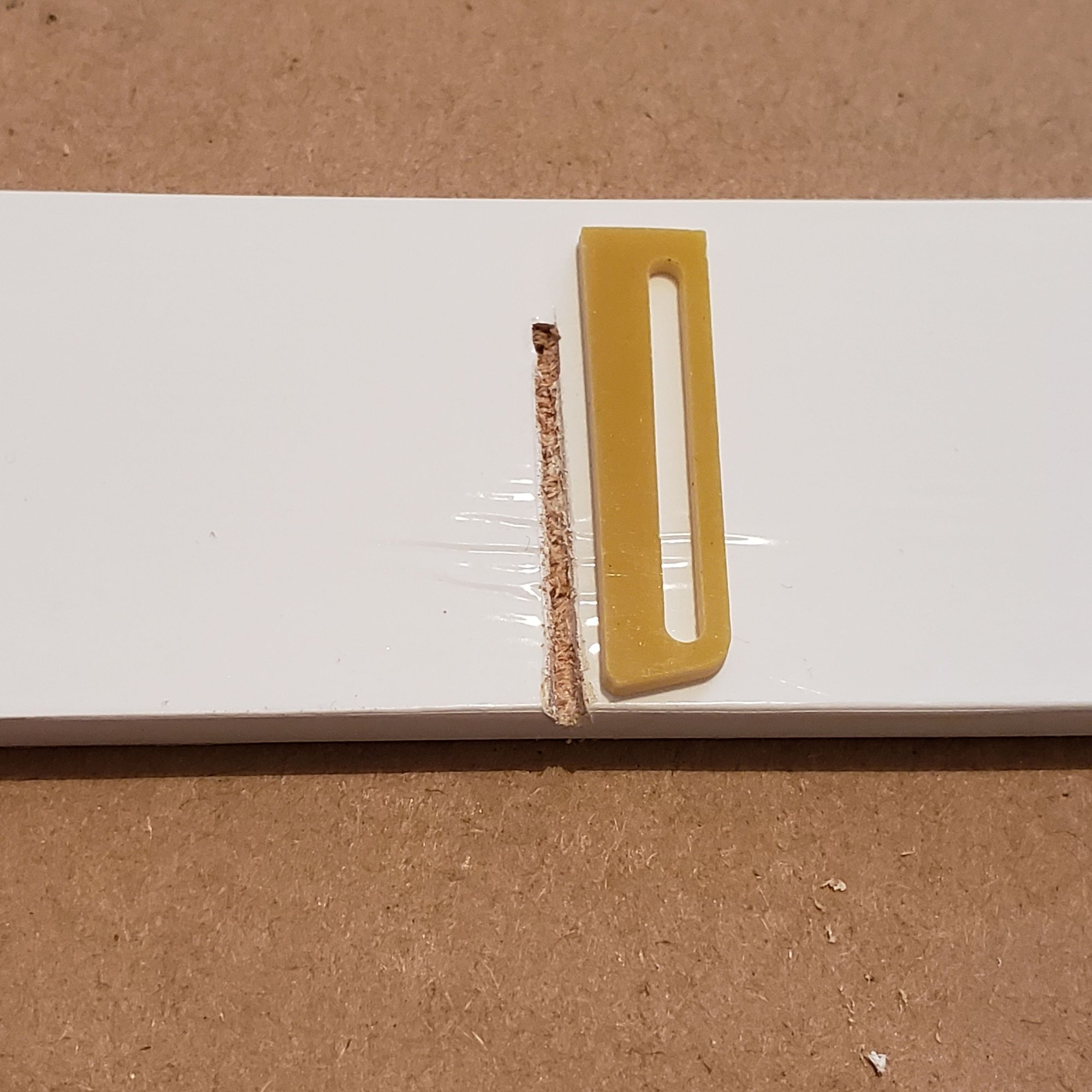

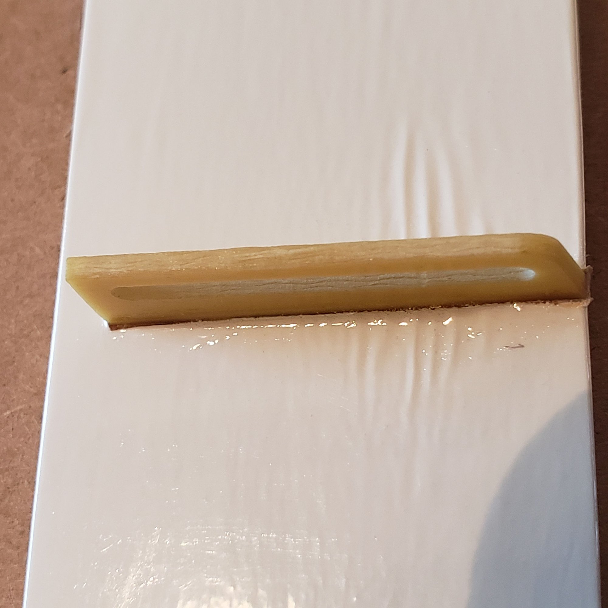

Here I installed the spoiler control bracket after making the slot a little deeper and longer. My spoiler only came with what I can only imagine is a reference "scoring" for a notch. Definitely not something you want to install this bracket in. Nothing in the instructions mentions this so I took it upon myself to modify this groove.
Use a hobby knife to deepen and lengthen this groove as seen here. Your model MAY be different as I feel this was an oversight on mine.

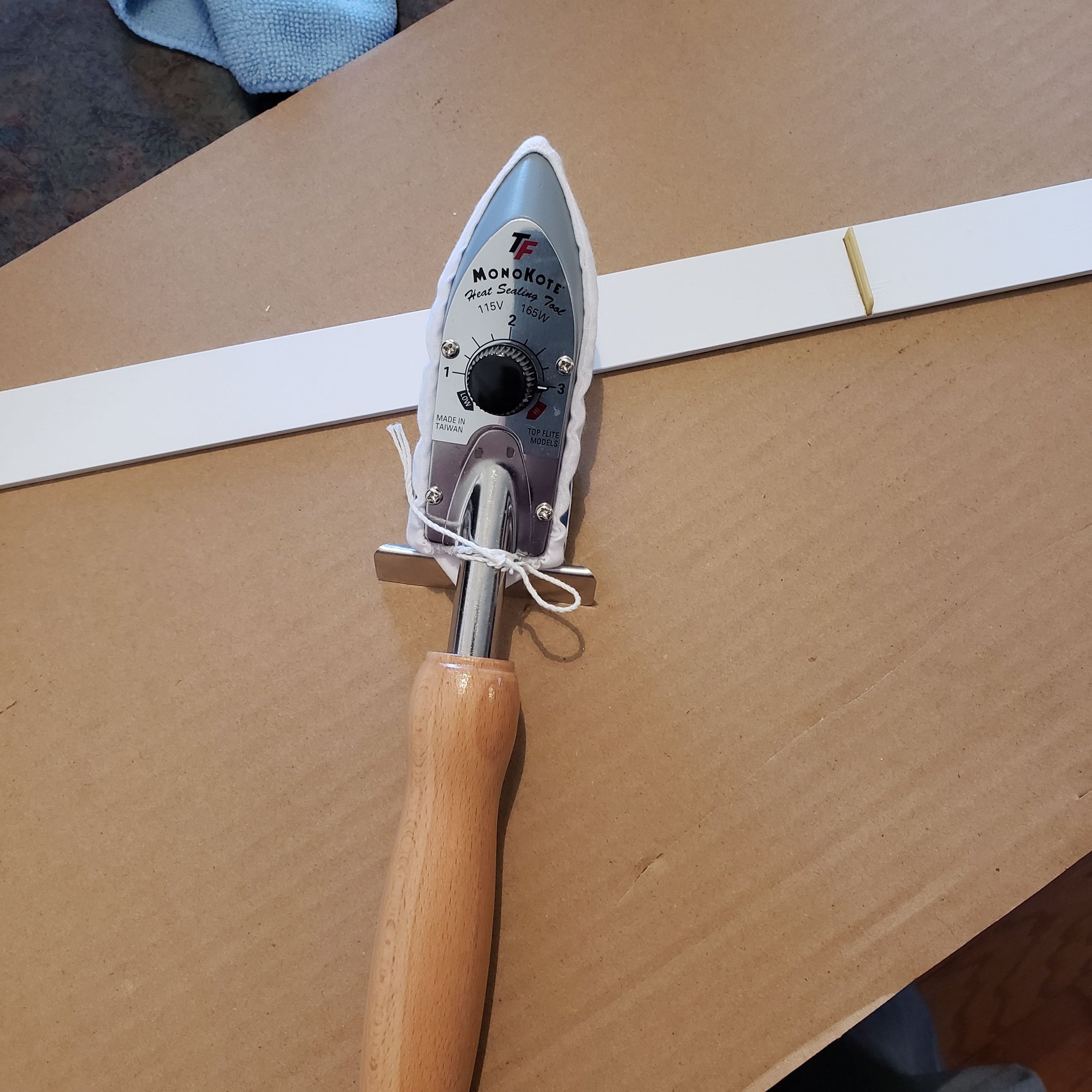

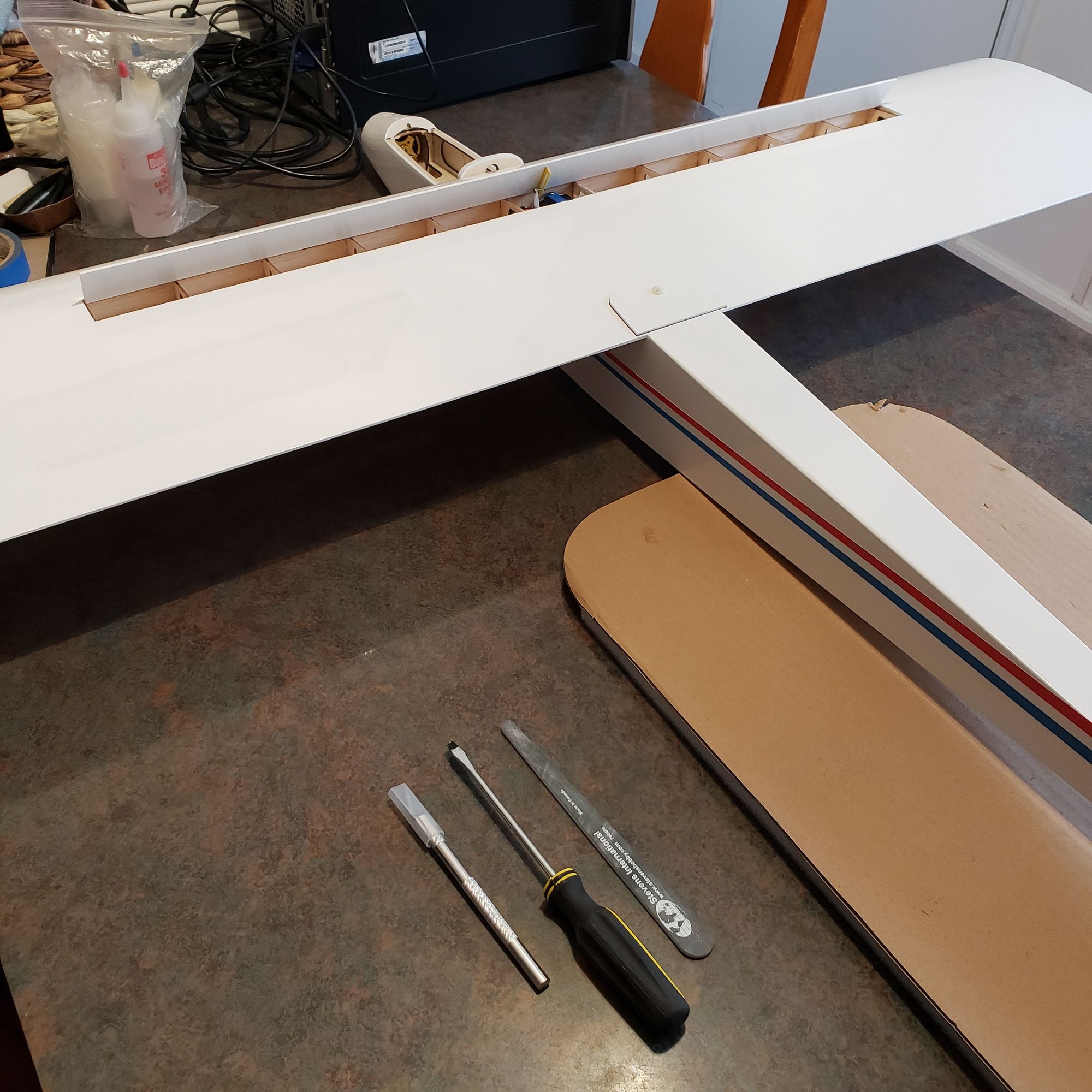

Oh, and you're going to want to iron the spoiler to have a slight downward arch before hinging. It's very thin and this allows the spoiler to seat more flush. I'd love to run a carbon fiber rod through the whole piece since it's very soft and would allow a more even distribution of seating when retracted.

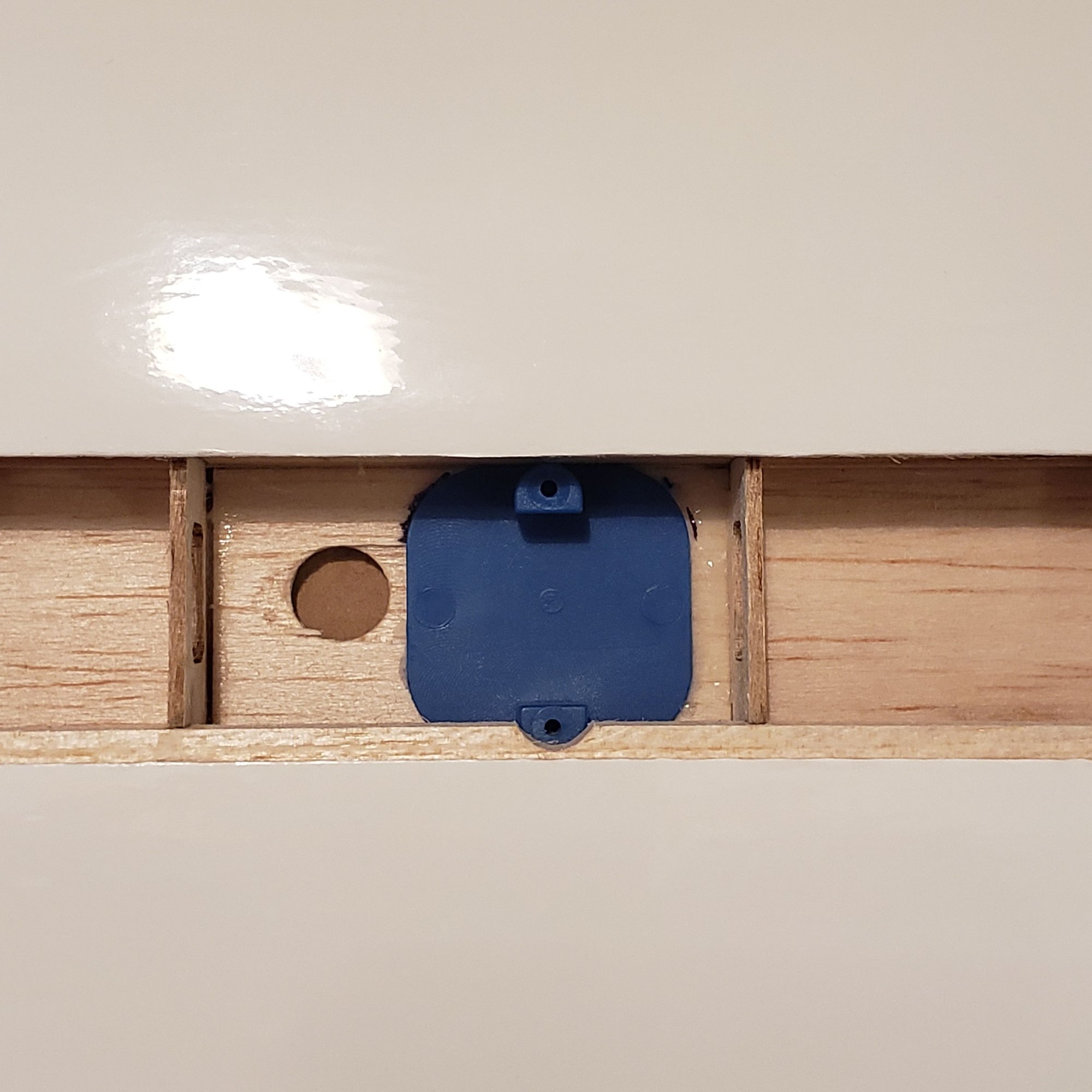

Here's where I ran into some problems. This servo (the recommended one) is not wide enough for the tray strap to even touch. When I tried to back out the screws one of the sheared right in half...they are junk! USE YOUR SERVO SCREWS INSTEAD! Furthermore this bracket is very tight on the screws and recommend drilling out a mm or two before inserting screws.
Banned
You could also use some servo tape underneath just to lift the servo a little. Had I known, I wouldn't have had to semi-permanently CA my servo in and CA the strap and screw back together. Oh well, it's a $9.00 servo and I have plenty of CA remover, AKA Acetone!

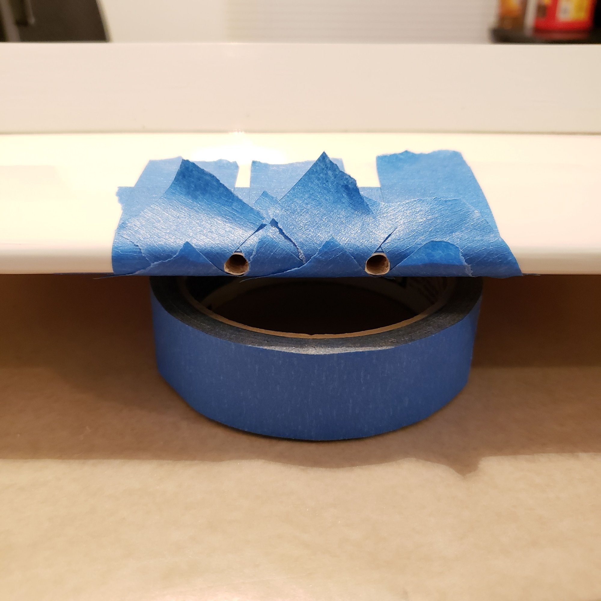

Dowels epoxied and another clean job thanks to my buddy, painter's tape. These were tight on the test-fit so a little sanding on the insertion ends had to be completed in order for them to go all the way in, and you definitely want these to go as far as possible. No cheating and leaving long then cutting off excess on this step. Believe me, I was tempted!!!!

Spoiler completed and assigned to CH #5 (Gear) on Futaba radios. Servo also reversed as stated earlier. THIS is what I like to see on an open section of wing, BALSA and PLY wizardry and beauty! Love the classic design of the Vista line. Vietnamese (or whatever) ppl really have this thing licked don't they? I just hope we don't eventually see all small to medium sized airplanes going "Nerf". That would be so sad. How they make these so inexpensively is beyond comprehension.
