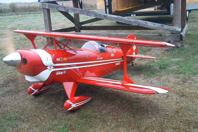

Just flew my GP Pitts today. It's a sweetheart. Has a Saito 300 Twin in it and almost all the flight was done at half power. Loops, rolls, snaps and knife edge all on the first flight. Notice there are no wires running to the top wing for the aileron servos. Magic!!! It weighs 18 lbs. An incredible Acft!!!

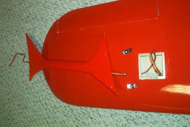

Default RE: GP Pitts Special
The picture shows the magic. The servo wire for the upper wing were run through the bottom wing out to the strut. then a small hole in the top of the wing where the strut goes then up thru the strut to the top wing. The strut is hollow so just a little drilling and you're into the strut center. I use chokes on the long servo leads to cut down on any interference. My transmitter is a JR 10X with a Jr 955 receiver and a Duralite 6v 3500 Ma setup for the batteries. I used all HiTec digital servos. I have seen one other Pitts flown and it had a DA 50 and did great.
If you're careful setting up the controls , you'll be amazed at how easy this bird flies.

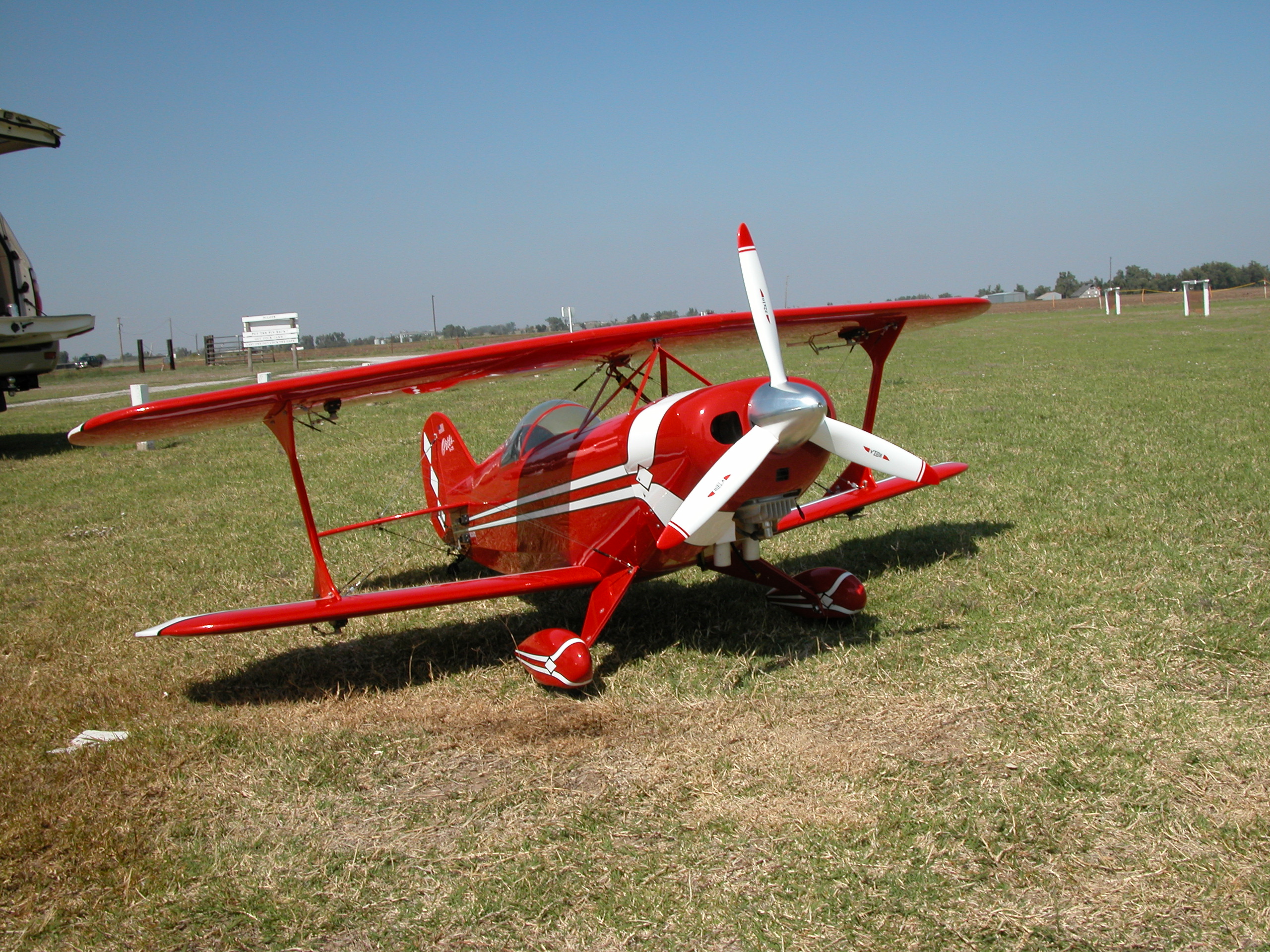

Here is a Pic of mine it has a 3W-75 Biela 3-Blade prop and somke.
Plane will hover at 1/2 throttle and has truly unlimited vertical!
it is 18lbs and I now have it WAY aft cg so it does some realy cool stuf!

Nice plane, BTW. 18 lbs? How have you balanced it?

At 18 lbs the CG on mine is 51/2 inches from the leading edge of the top wing. ( the straight part).

The smoke and RX battery were under the cockpit -- way nose heavy, then moved both batteries 1/2 between the tail and cockpit -- much better, then moved both batteries to just in-front of the tail -- now the plane feels slightly aft cg but tumbles really good now.
I'm using the duralite 4000mah battery for rx and 1800 for the ign battery (it is mounted in the firewall box) & 600 mah nicad for the smoke.
I have approx 100 flights on this plane no damage other than one of my wheel pants came loose. I have since fixed that, and I fly off of grass 99% of the time!

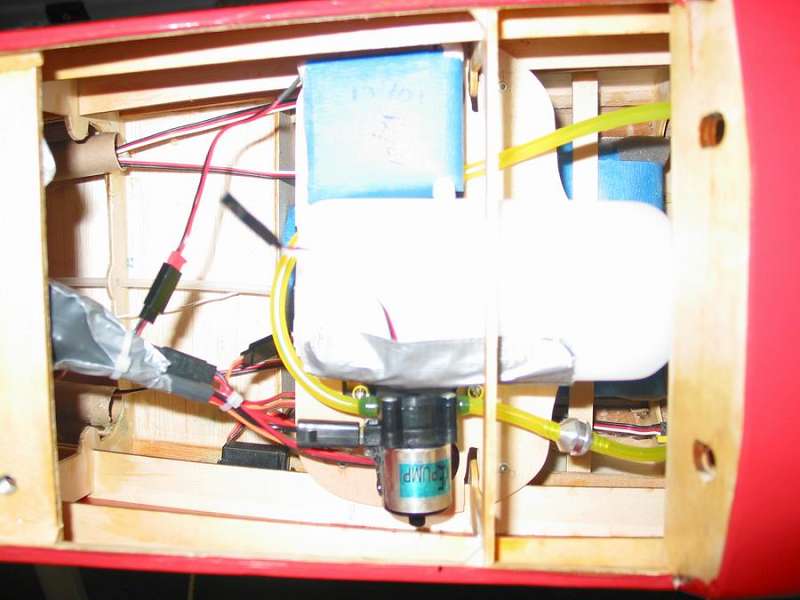

Default RE: GP Pitts Special Smoke Tank
Can anyone tell me where they are mounting their smoke tank in the GP Pitts?
Does the elevation matter like a gas tank?

Booker RCU Glad to hear your wiring idea worked out. I thought about doing this, but decided to just use the extensions throught the wings. Mine weighs out at 18 lbs also. Just finished her today. Hope to do the maiden next weekend.
Goldwing RCU, I mounted a Simple Smoke system by making a mounting try out of thin ply. I put the tank and the pump on the tray. I then used epoxy to mount four short wood strips to the fuse stringers. Then put four #4 socket head screws in to secure. Mounted just aft of the fuel tank. I used the same system on Pitts I and then transfered the tray to Pitts II. This worked great on my last Pitts. This time I used a 24 oz tank vs a 20 oz. The 20 oz. just ran dry too fast. The pictures below are from Pitts I. On Pitts II I mounted the same way, but put the battery down in the fuse and used a 24 oz. tank. Same position, but mounted the tank a bit more forward with the 24 oz. tank.
