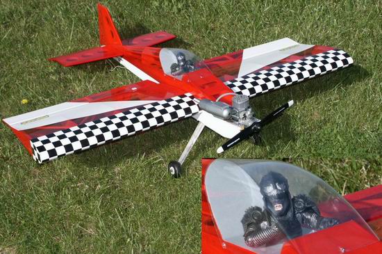

I too have a 61fx and love it. Buddy that I bought the plane from had a 91fx in it!
