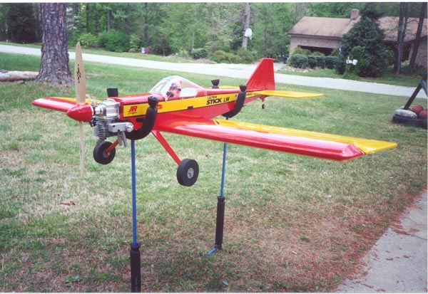

Heres the mod i did to my H9 120 USLW >
Good luck with yours!

Add a piece of 1/2 triangle stock to the bottom side of the wing hold down plate if it doesn't already have one. This was a sore point on one that i soald to someone else.
Switch to 4/40 hardware throughout the kit. Use pinned hinges instead of ca hinges.
That's about all you need to do to upgrade this kit to top notch.
