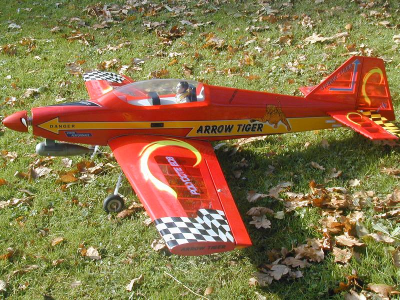

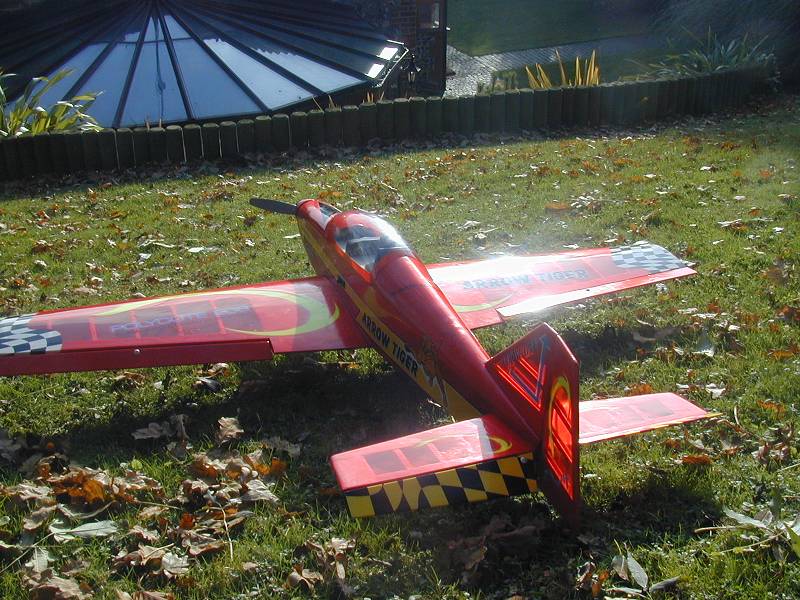

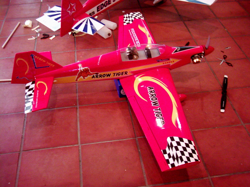

Default VMAR Arrow tiger 2 pics
Hi all,
Well, I did it, I went and got myself an arrow tiger. Mainly because my first low wing was the series 1 arrow and I couldn't resist.
The wing is super thick and the overall quality seems to have improved over the first

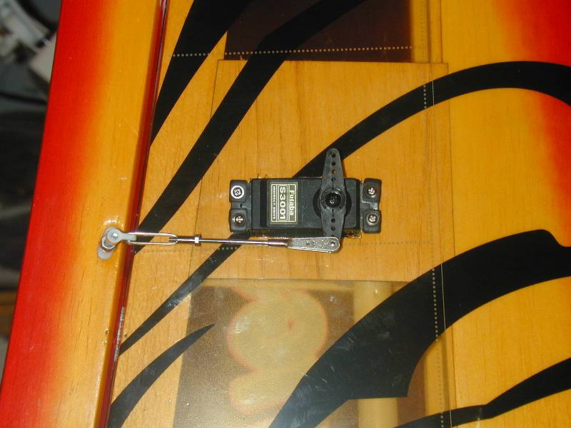

You rearly ought to check out the latest VMar kits, your comments relating to them are now old hat and very out of date.
Latest Arrow Tiger in Europe is now a see through red scheme the aileron servos are not under a cover but exposed as per every other ARTF now days, only problem I had with the whole build was the incidence pins for the wing joint being out of position, I had this with a Graupner kit so no big deal, the work required is just enough to make you feel involved in the construction sequence and having contributed to the build.
I'v put Ailivators on mine so the elevators also act as ailerons, seemed to good a chance to miss as the twin push rods where already there, pics should explain mods required.

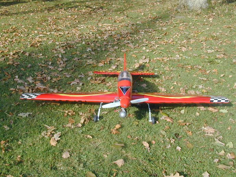

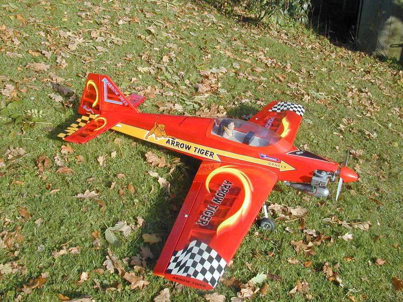

Pic showing ailivators. And other views, note the OS Max 50H which is a helicoptor engine of 20 years still going strong, could not get the engine back far enough to reduce the gap to the spinner, perhaps a latter mod to extend the nose will too the spinner is in order, trouble is it fly's so well I'm loth to change anything at the moment.

BE: That's a darn fine looking aircraft! I do like the see through covering on the panels. I am stunned to see the ailvators. Man, that thing must twist like a croc when you wiggle the sticks!
As for the gap, I bet you could form a spacer from balsa, sand to shape, paint and glue it on the nose and no one would know the diff!
Cheers!

All four pics are of the same plane, the model does not come with wheel pants, flying off grass they are not an option anyway, they get full of sheep sh** and lock up the wheels, if you fly off pave then they would certainly enhance an already good looking ship.
As to making up the gap at the nose, a balsa spacer may be the way to go, but I will probably use some lightply to give it a bit more strength.
The Ailivators are very effective at slow speed they increase the manouverability out of proportion to normal, at high speed you can get the same effect by increasing the aileron movement only, but rolls are more axial, its the slow speed manouvres that butter my turnips, simple mod see earlier pics in this thread.
