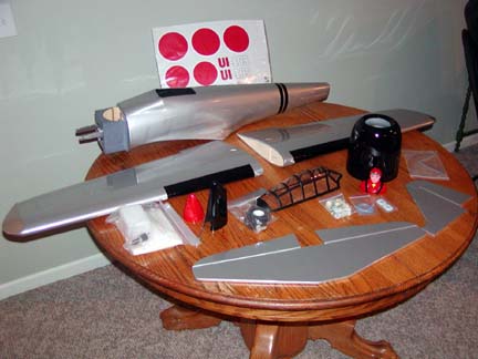

I just picked up this ARF of the Zero from Seagull Models and I was quite impressed with what I received for 139.99 at my LHS.
The model is entirely built up with an unbelievable number of stringers in the round fuselage.
The plane comes with everything you can think of to assemble, even the foam to wrap the fuel tank.
It is covered with Ultracote siver (not exactly scale), but the covering job was outstanding.
The cowl and rear cone are fiberglass, not ABS. Comes also with painted pilot, spinner, etc.
The engine mount and pushrods are already installed and all the control surfaces are hinged and pinned!!
I believe I can have this finished in 3-4 evenings.
The literature on Seagull says they use CA and epoxy. The first sign of that was the firewall which looks to be epoxied and has triangle supporting stock behind the 1/4" plywood firewall. You don't see that in many ARF's.
I am going with a TT 46 and Hitec 425 BB servos. It has two aileron servos, no flaps.
I am mostly interested in building scale kits and from plans, but got this to be a practice "warbird" plane before I fly my Skyshark SBD Dauntless I am working on.

Retracts are not really an option, but for $139, I was not expecting them and would not invest for this size plane. It is just for fun flying scale.
I put the wing together in about 2 hours yesterday and I am working on the tail feathers and pushrods.

Not a lot of interest expressed on this ARF, but I might as well post the finished product. It was one of the easiest ARF's I have every assembled. Other than the cowl, the rest of the plane went fast. Some of the best fitting parts of any ARF I have assembled.
I opted to mount the TT 46 engine sideways with a Pitts muffler rather than inverted as the instructions indicate. I don't like to mount 2 strokes inverted unless I have too.
I will try and get it in the air in the next couple of weeks. A great plane for $139.

How much weight in the nose did it take to balance it? What was your all up weight minus fuel? I just got my wings glued together tonight with servo's installed. I read so many posts on zeros saying you had to add a lot of weight to the nose and many were just opting to hang a bigger engine out there instead. So I talked myself into buying a lightly used O.S. 91 surpass four stroke. The engine is about 23 oz with muffler as compared to a TT .46 which is 17 oz with muffler. Its my first four stroke and I can already see some challenges. Like having the carb behind the engine. I think I am going to have to cut into the firewall so the engine can fit futher back. I am sure it will be interesting. Hopefully the extra 6oz in motor isn't too much. I am also going to try out a 3-blade prop.
We had to put a lot of weight in the nose also. I helped a friend build his Seagull Zero. We put a Thunder Tiger 46 in the nose. When we were finished we had to add 13 oz of lead to the motor mount to get her to balance at the mid-point of the suggested CG range. When we finally had her balanced, the all up weight without fuel was 6 3/4 lbs.
She flew well though and responded very nicely, but, here is the bad news, she had one takeoff and zero landings. My friend was doing a mild split-s when the nylon pin in the factory supplied clevis we used on the elevator sheared off and he lost all elevator control that resulted in a steep nose dive, tree slamming, hole digging contest that totally destroyed the plane.[:@]

I looked at my weights and I added about 9 oz of lead to the nose on the motor mount box. I also used that as an opportunity to laterally balance the model and ended up putting most of the lead on one side of the motor mount "box" vs. in the center.
The plane weighs about 7 1/2 lbs with the lead in the nose.
Regarding the plastic clevis.......I am always afraid of plastic clevis, I always use the Sulivan metal clevis with the retaining clip. In this case, I did go ahead with the plastic clevis, but now that I have heard the story of the failure, I think I will go with Sulivan. The only reason I did not to begin with was because they are 2mm metric and all I had was 2-56 or 4-40 in my parts supply. I will make a trip to the LHS and get some metric Sullivan 2mm before I fly it the first time.
Only other change I made was replace the fuel tank with a Sullivan tank. I have has ARF tanks leak before an it really just ruins the model. That was really the only item in the box that I thought was cheesy (except maybe now the clevis).

The CG instructions were confusing since the directions were given as cm back from the wing tips and not the leading edge per normal. When I figured everything outm, it was about 1" behind the spar. I have added about 9oz of lead in the nose. Hopefully, that will be enough for a safe first flight.

That doesn't sound right. 9 oz. is a bit much to add to a .40 size plane. The instructions does say 6 - 8 cm from the leading edge at the wingtips. Sounds pretty confusing, especially if the wingtips are rounded. Still, 9 oz. sounds like too much.

Hmm 1 inch behind the spar? Ok, you go first.
Ha ha ha I think I am shooting between the spar and 1/2" behind the spar. World models makes a 60 size plane that is just a tad larger but we may be able to cheat and view their CG and come close. They usually post their manuals and I have many of their planes all of which flew great. Their's is a 60" span (635 sq. inches) where ours is 58" span (550sq inches). Kyosho also makes a 40 size but their wing dimensions are quite a bit smaller and so is the all up weight.

I have test flown the Seagull Zero ARF with the cg per the instruction books recommendations. I called Horizon Hobbies to clarify the CG stitauion and they said the 6-8 cm was from the LEADING EDGE OF THE OUTERMOST RIB. I marked those positions and stretched a string from each wing tip cg position and made my cg marks on the fuselage. When we balanced the Zero it took about 12-13 oz attached to the motor mount to balance about the mid-range position of the recommended range. The all-up weight without fuel was 6 3/4 lbs and she flew very well, so I don't think that the 9 oz is too much for this aircraft if she balances in the prescribed range and the overall weight is satisfactory for a .40.
I hope this input helps
and good luck to you. Let us know how things go in the test flight. PS - You might want to check out my posting in this thread on this bird.

I did the same trick with the stretching the string between the wingtips. That is how I arrived at the point 1" behind the spar. I realize this is farther back the the ususal "balance on the spar". Hdkeney: what did your measurements translate to at the fuselage relative to the main spar? With the weight you added, I assume your test flights went OK?
I appreciate all the input. I am going to replace the plastic clevis but my LHS did not have the 2mm metric Sullivan clevis, so I need to order. They look to be metric anyway, as my 2-56 Sullivan did not seem to fit?
