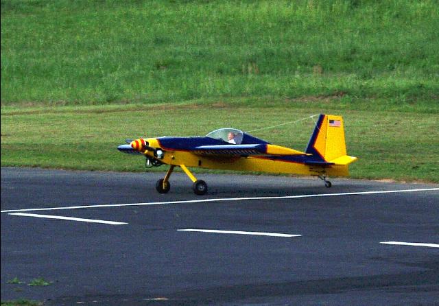

Well, since there have been no responses, I decided to weigh everything myself. Perhaps this will prove helpful for someone.
I weighed everything in the box, which, in the ARF, includes all Sullivan hardware, wheels, tank, etc, plus a lightweight pilot I will be using, and it all came to 123.9 oz, or 7.75 lbs. I'd be interested to know how this compares to the foam wing "Kit" version of the Stinger 120.
Weight of my servos, extensions, RX, battery and 2 switches (RX and ignition) came to 20.4 oz.
Therefore, the plane comes in at 144 oz, or 9 lbs even, not including engine stuff or glue.
I plan to use my Wolf Predator 1.8. This engine, including the 10-32 mounting bolts, ignition, prop (Mejzlik 19x8), spinner, nuts, and ignition battery, comes to 58.6 oz. Naturally, the engine is only about 3lbs without all that stuff you need to make it fly! Have not run it on this prop yet, but not yet broken in, it turns an MA Scimitar wood 19x8 at 7400 rpm. An 18x8 was 8100 rpm.
Not including glue or servo screws (but pretty much everything else!), this comes to 203 oz, or 12.6 lbs.

The cowl and wheelpants are fiberglass. By turtledeck, do you mean the removable hatch that the canopy is attached to? That's balsa. The front and rear curved turtledecks in front of and behind that are built-up balsa sticks and sheeting. The ARF wings are built-up, not foam.
Total weight actually turned out to be 12lb, 4 oz with Mejzlik 19x8, but then I reinforced the firewall and landing gear plate, which gained 2 oz. I understand that the ARF is quite a bit lighter than the kit, but I'm not sure by how much. Perhaps 2lbs or so.

Mine is 12lbs, 6 oz with a 30 cc Wolf gas engine w/C&H ignition, 2 batteries, etc. The weight difference might be even a little more than 2lbs, given that the OS160 glow version Kit Stinger weighs 14lbs.

Handling.....jury is still out. Was windy on Saturday when flown and plane did not feel locked in properly. Felt like it was not staying in trim, handled a little tailheavy, but CG is at 4-3/4". Flew my Jerry's Big Boy, same size and wing area, but is lighter, and that flew excellent. So, something about the plane, I think is not quite dialed in yet properly.
ARF CG is stated as 4.5-5" so I aimed for the middle. Kit is 4.5-5.5. People seem to be flying the kit at 5-1/8". No idea why the CG and throws are shown differently, unless the airfoil center of pressure is slightly different on the ARF, resulting in the need for a different CG.
