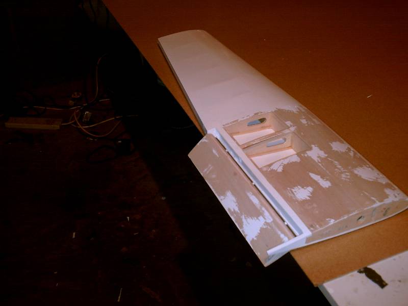

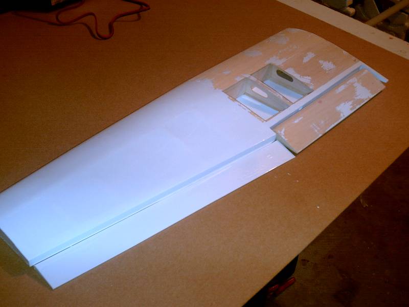

I added flaps to my GP 182, I took some pics during construction. I am at work now (yeah midnight shift) but when I get home tomorrow I will try to dig them up if I remember. you can also email me at sch1234 (at) gmail (dot) com if I end up forgetting to post here.
It was easy. I highly recommend adding the flaps before you join the wing halves. It is not a tough mod at all. I have not flown it yet (hanging in the garage for about 3 years now!) but I did build the Top Flite 82" version and the flaps were awesome on that one. I'm sure they're just as much fun on the smaller 182.
