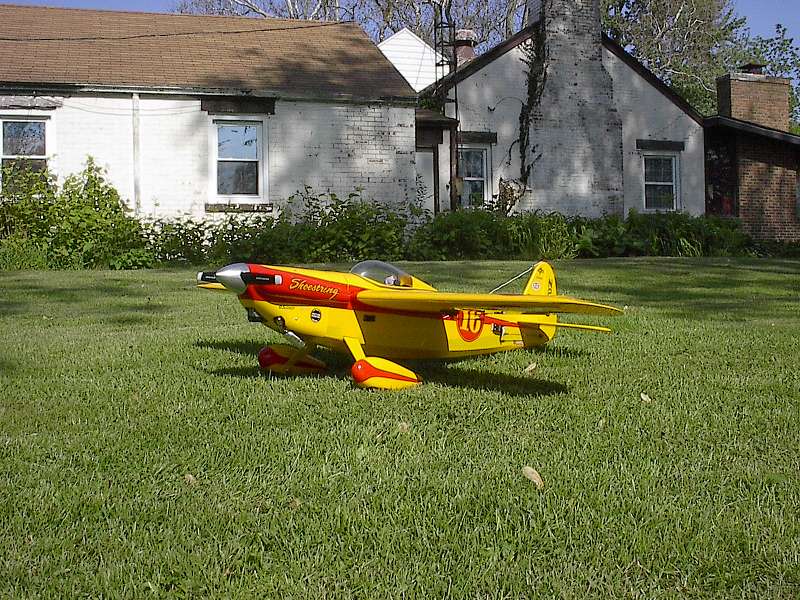

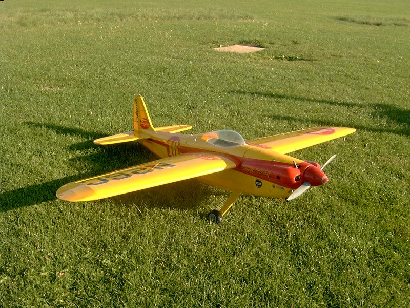

I've had mine half the summer and Love the plane... Were I fly most of the time I have a short runway so it took some getting used to puting it down... Once it touches down it slows down fast. I have a thundertiger 2 stroke 61 in mine and it screems... I got it on a trade and it's a bit nose heavy and getting it rolling with out nosing over was hard at first. but I pulled the wheel pants and put bigger tires on it and now once it's moving no problem.. I might add a little tail weight this winter... Hog out the wheel pants too so I can put them back on. Love the plane... Yea and if you didn't read all the threads... Go in and reenforce the wheel bracket area...Not much there to secure it except ribs...

Bull, It looks like you might have the gear in the wrong side which sets them back and could account for your nose overs.

Plane jim sorry didn't get back to you the site wasn't notifying me when people respond and haven't been to this post for a while... I'd have to measure the prop... I got it on trade for an e-max I had... But I think when I got it it had a 10 / 6 wood prop and I switched it to a 10/ 8 APC I know it definetly went faster with the apc on it. It's a Thundertiger pro 61 with a pitts style muff. As far as the wheel bracket being backwards could be I'll have to take a closer look. The guy I got it from said the wheel area broke off and he fixed it.. I peaked inside and its reenforced. The slanted side when I just went downstairs was to the back side... BUt the wheels are at the front edge of the wings... Will have to check it out. As far as 4 stroke vs 2 stroke... If you want torqe to pull you straight up and do acrobatic style flying or after four feet straight up the 4 stroke will throw a bigger prop and do the job... but the top end of the power band is lower.... If you want speed go with the biggest 2 sroke you can put on it and the rpms are higher... Takes longer to get to the top end but it will SCREeeeeemmmm!!!

It does look like the gear is on back words ....I have 3 of these planes and the best combo for speed and power is a ys 110fz and a apc 13.5x12.5 works great for me ...The os 91fx with a apc 13x8 prop is a good combo.....If you can put a 61 in it you can put a 91 ....They are the same physical size... However the Pitts muffler four the 91 is alot bigger......JW

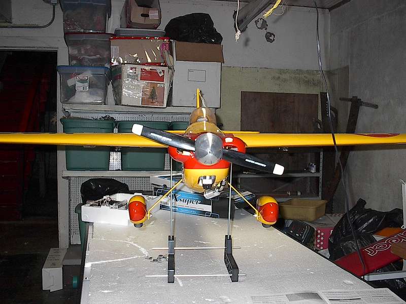

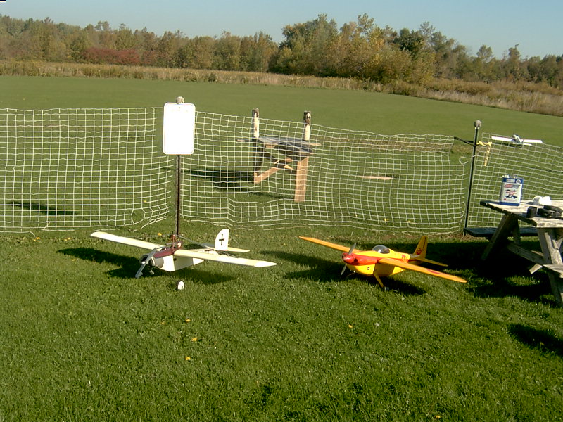

I used a OS 91 4 stroke and the cowl cutting looks preety good. As everyone else says, this plane is a dream to fly. Great looking too!
