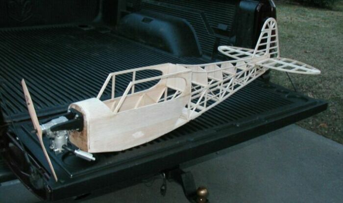

Hey guys, I have some questions.
I am building a scratch built Cub from Cad plans I have and I am currious if anyone has a Cub similar to the size of mine that could give me some guideline measurements. My wingspan is 90". I have started building the wing halves and Im curious about the angle of dihedral. Also what angles of deflection are for rudder and elevator.
Also, I am using a Saito .91 engine. I bought a 13x6 prop for this plane and from reading these posts I think this is a bad choice. quint is using this same prop on a .65 Saito, so I think I could use some better advise on prop size.
For more pics on this project.

Dan, the 13 x 6 is one of my favorite props on a Saito 72. Think you need to look at a 14 or 15 inchers with low pitch for a 91.
