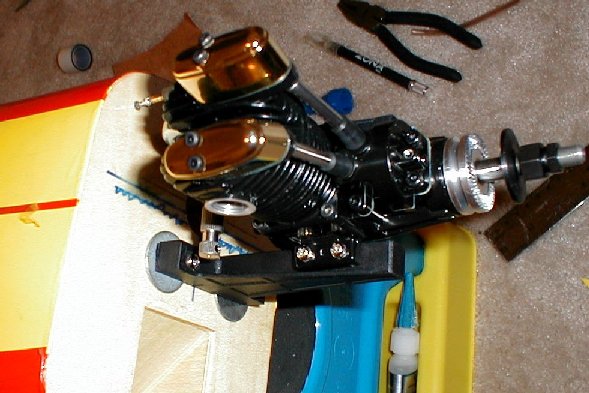

Thanks for the input so far.
I have a NIB Saito .72 that I was thinking about using in this plane. I originally bought it for my Cub, but I think it might find a new home here. What do you guys think?
I was planning to replace the stock wood dowel pushrods with DB 'glass ones. Is any one using a pull-pull rudder on this plane? Or should I stick with the pushrods? Any other recommendations!!?

I have 2...
One with a OS 52 Surpass...flying over 2 years...
New one with Saito 72....
I have a pull-pull rudder (Dubro)..and for the elevator pushrod, I am using Dubro fiberglass pushrod...
Using Hitec 605 Hi Torque servos on elevator and rudder...
Two things worth mentioning here...
A) Reinforce the landing gear block. This is very easy to do as I just took some triangle stock and epoxied it inside...
B) Like anyone who has flown this plane has mentioned...start with the CG as close to the nose as recommended and low rates on the elevators because she WILL SNAP....
Also on landings...once you setup and are in line with the runway, allow the plane to settle in and not apply too much up elevator...except when rolling out...

I have flown my Kyosho Cap 232 .40 size with a variety of engines. Saito .91, MVVS .40, Enya .50SS, OS .46FX and last the Saito .72.
I say go with the .72- why? Its light as the two strokes, but when hovering it will pull the plane up out of the hover, none of the two strokes would do that.
Mine weighs 5lbs, 3 oz (about 3 oz more with the .91). I had a previous one at 6lbs, 3oz with a Saito .65. Too heavy, some snapping tendency.
I used pull-pull on both rudder and elevator to save weight. Works great!
