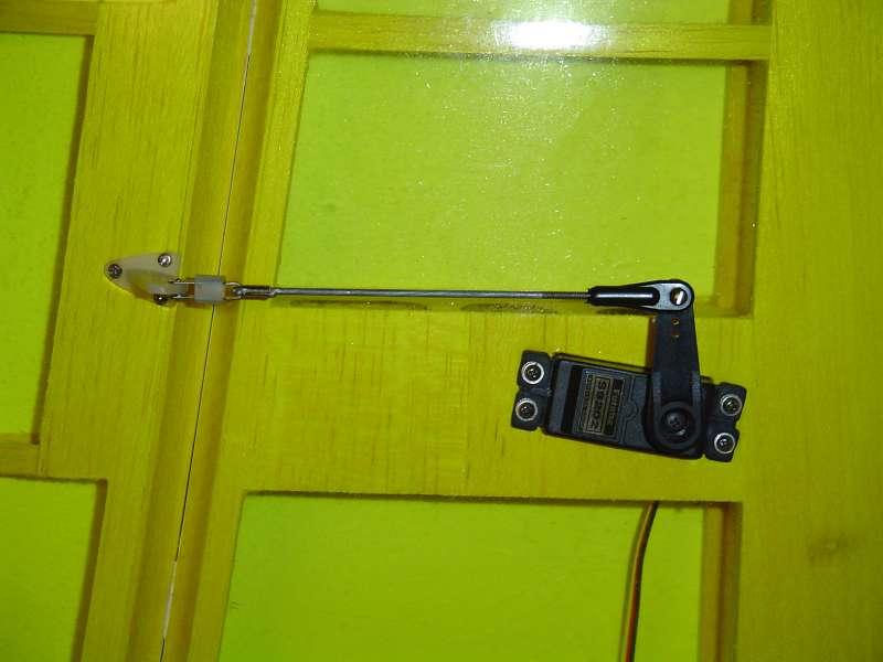

The threaded rod is a little week. You can stiffen it with a sleeve but then it's added weight. I'll put I pic below of how I did it.
David
p.s. Those are Du-bro servo arms

Here is the pic.

Thanks for the picture.That clears up alot.I am pretty new to the whole rc world so this forum is helping alot.I feel comfortable with my flying but it will be a while before I use full deflection on this bird.Thanks again.
John
PS any picture of your elevator and rudder set up?Thanks.

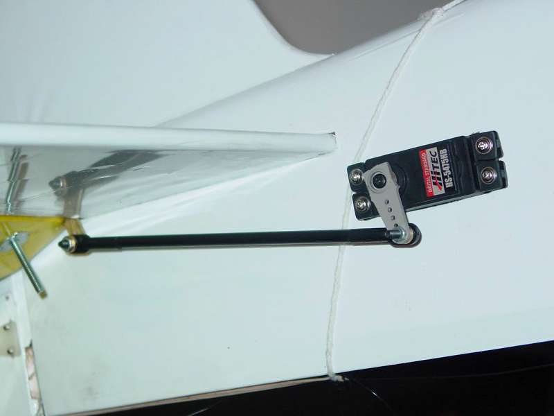

here is my elevator setup.. This is my second Funtana... I had problems with the 2-56 rods on my first one so i went a bit overboard for this one.
I am trying something different here. I soldered a control horn onto the elev joiner wire (should have made longer). There is a picece of carbon tube to take the stress on the joiner wire where it goes through the fuse. The pushrod is threaded 4-40 with a carbon fibre sleeve over it and dubro 4-40 ball links on each end.
Notice the extra control horn?? on my first funtana i had a HS81mg on each elevator whick worked fine.... If this setup didnt work, i will use dual servos on this one too, so I put the control horns in before assembly to assure alignment with each other.
Rudder and ailerons are set up the same

psyco, no i did away with the braces.... on my first one the braces didnt last long and i had a horizontal stab failure (ripped off in flight).
So on this one as well as my first I took it upon myself to rebuild the horizontal stab with hardwood trailing edge and put the carbon support rods into the structure of the stab to give it strength. This worked very well on my first funtana and should be just as strong if not stronger.
PlagueWielder;
I used the heavy duty ball links from du-bru - the 4-40 size ones..
