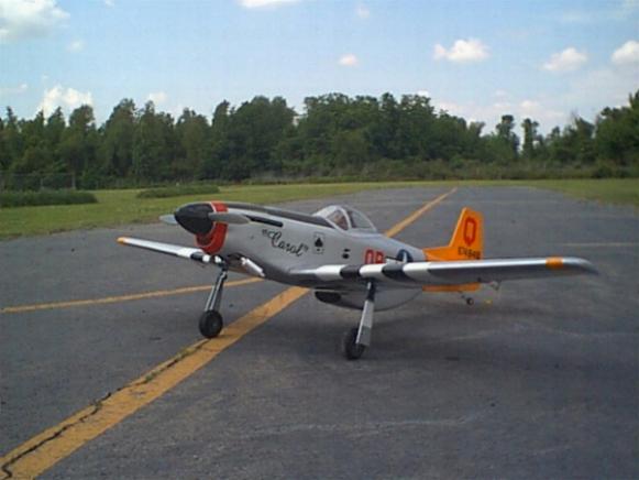

OK - I finally have pics. First flights memorial weekend. Flys great with YS 91.

Looks real good. I hope to fly mine sometime soon. My graphics should be here next week. I don't want to fly her till she is completely finished and that is all I am waiting on. Is the recomended aileron throw enough? I guess I have been flying to many IMAC birds, you know the ones get all the throw you can.
Any ways looks real good and hope it flies as good as she looks.

Flys great! Very smooth and responsive. Aileron throws were good but I used about 1/2" for elevator throw on low rate and recommended on high rate (never used high rate). Stalls straight ahead at a walk and lands nice and easy. Made my own instrument panel and added guns. No other mods.

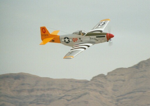

SSSSMMMOOOOTH and groovy! Gotta love it.

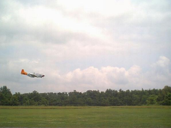

Got to concur - this one is smooth and fast. A keeper!!

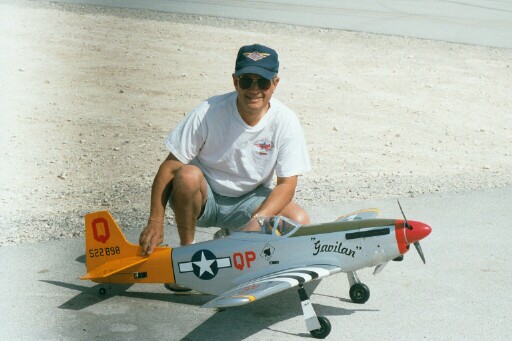

I used a H-9 1/7th scale WWII pilot. Made my own instrument panel though because of that stupid decal. Oh yeah - guns too.

How did you make your guns? Also how did you run your antenna? Did you drill through the fuse behind the canopy and run it to the top of the vertical stab?

I did what you said for the antenna. As for the guns - after trying different methods on a scrap leading edge, I ended up with two pieces of carbon fiber tube from the kite store. One is 1/4" thick wall and the other is 1/8" and fits exactly in the larger tube. Cut the large tube to a length that puts about 1/4" into the wing and about 3/16ths outside. Cut the smaller tube to protrude about 1/8th " beyond. Glue the two tubes together with med CA and make 6 assemblys. Drill 6, 1/4 " holes in the leading edge ( I did them on the Black stripe) and glue the guns in with med CA. I touched up the edges with a little silver paint to give them some definition too.
