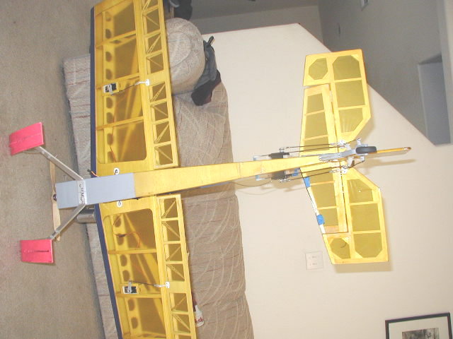

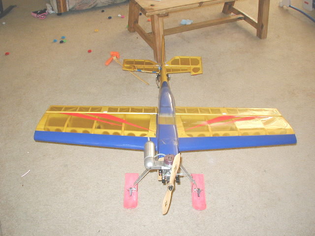

This is my favorite plane right now. I can't say enough about it. I'm in love.
http://www.chiefaircraft.com/cgi-bin...els/Model.html
Price is $119.95 shipped.
I went from never trying 3D to hovering on my 3rd flight. It does flat spins, torque rolls, harriers, bug splats, waterfalls, it is stable and it has a thick airfoil. It flies slow and lands at walking speed.

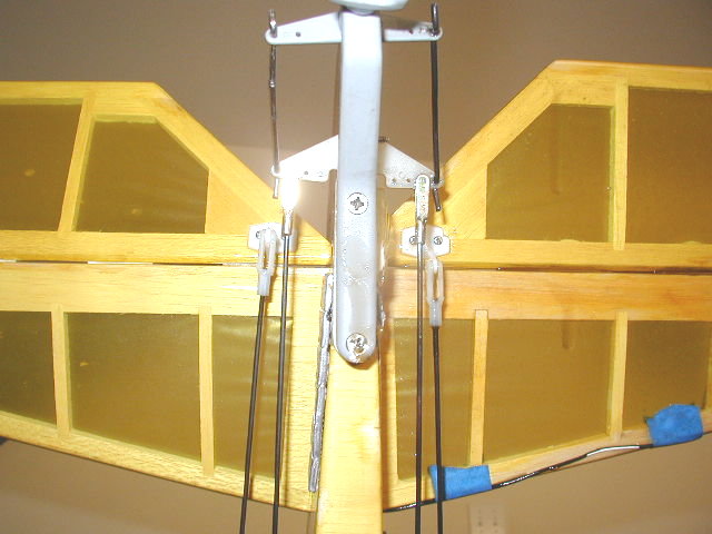

It does have 2 issues that needed fixin. The main gear is wires and the wheels wobble around and it's kinda floppy. The tail only has a wire skid-- not a tailwheel. I added a piece of hard plywood on the main gear mount and installed some real aluminum gear. I added a steerable tailwheel as well.
Power is a Tower Hobbies .75 2-stroke. Best engine in the world for $99. Flying weight is 5lbs. 8oz.

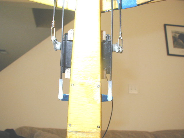

I DID use dual elevator servos with a JR Matchbox. I am glad I did. The surfaces are HUGE and I don't think a single servo and torquerod would have given the same authority to my harriers or snaps.
I REALLY like this plane. I never take the wings off. It fits in the back of my Nissan pickup fully assembled.

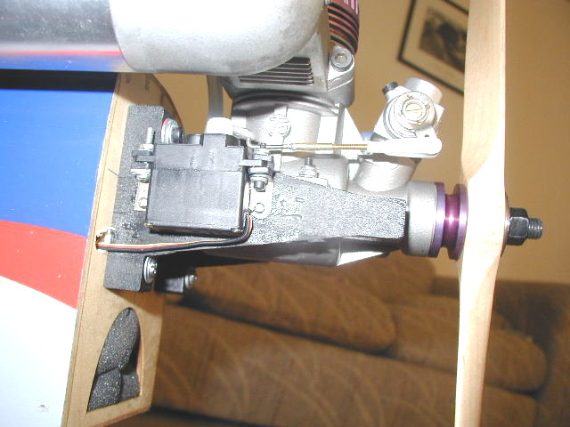

One last pic.
Throttle servo is Hitec HS-81. I used some flying wire straps and bent them into an angle. Then I bolted them to the servo and used small wood screws to mount the servo to my engine mount. Linkage is short and sweet.
I didn't bother with the fiberglass cowl on this plane. Not much left of it after cutting to fit around the TH .75 anyway.
Plane hovers at 1/2 throttle here in Denver at 6000' altitude. I'd think your 50 would do the job at lower elevation.
