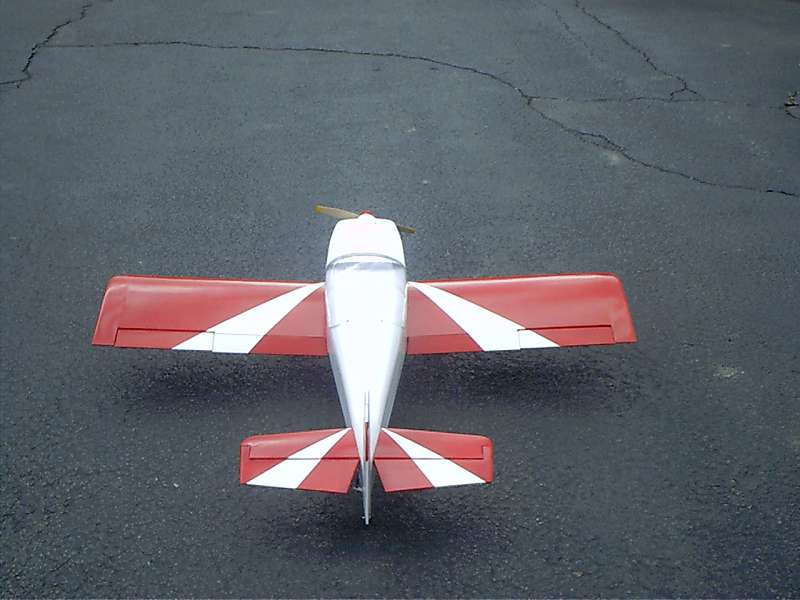

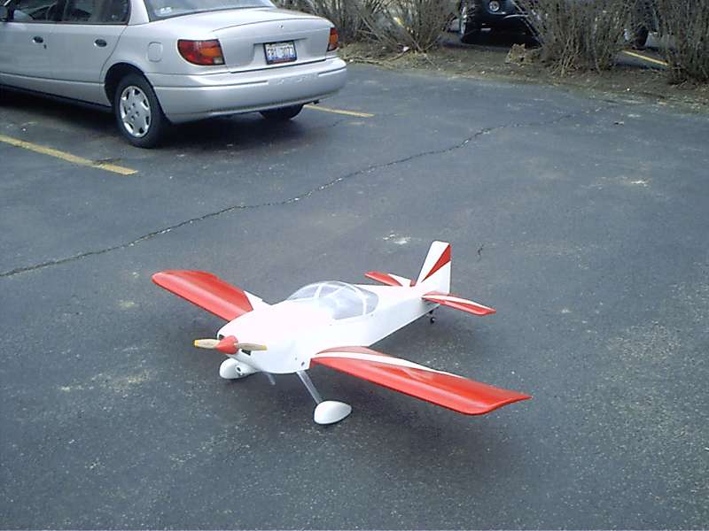

Just to bump this thread up, I just completed the build and painting of my new EAM RV-6.... nice product. This model is beautiful, and is just waiting for the 9c to come next month. Will be running an O.S. 70 Ultimate ringed pumper with a 14x5 prop. No comment yet on its flight characteristics, however I have read that they tweaked the airfoil a bit to acheive a more aerobatic Reynolds number, more suited to r/c aerobatics- I can't wait! I enjoyed building this model so much, and am so pleased with the finished product, that my next kit purchase will be their New Glastar with a Saito .90 twin- it looks awesome! Good job EAM, keep it up!

Here are a few pics of the new RV-6, BTW.
