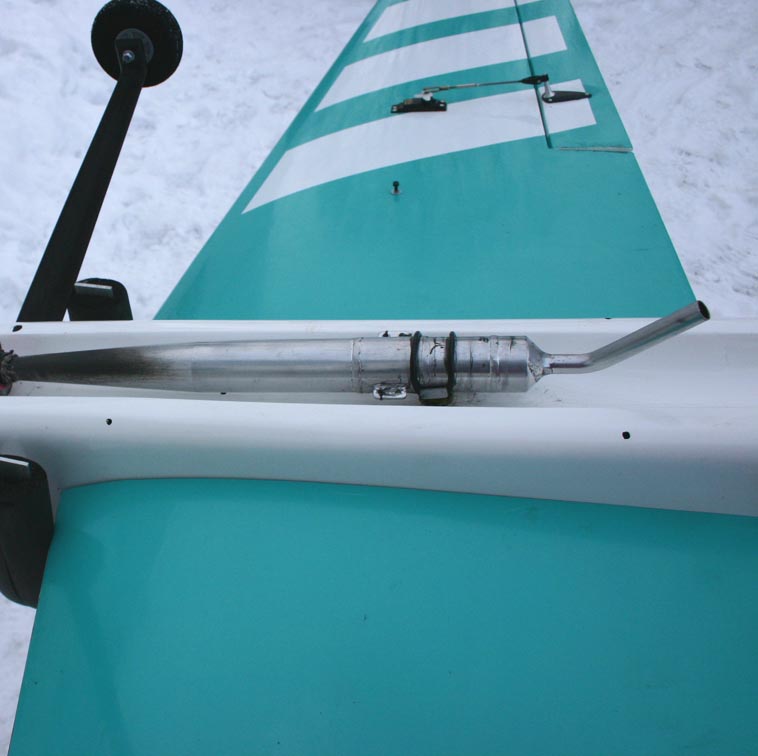

Me to big problems... not with orinetation...just seeing the little b#stards. Getting to old.
I tend to keep the art designs to the top of the wings and use a flat colour with high contrast (read white) simple graphics on the bottom.
I don''t mix 'em up. Top surfaces arty, bottom functional.
Tend to use the same colour all the time. Yellow is the key. It's highly refective and will transmit it's colour even at distance on cloudly day's. Unlike ever all colour that will, with distance just blend into one. You don't need much and keep it on one side only.

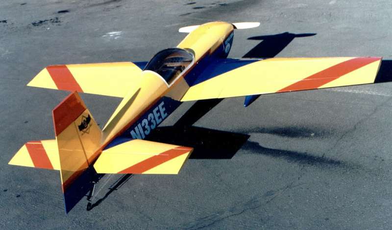

Flew the plane again today - sky was better so the sawed off wing was not as bad .
BUT for my own planes - you can bet your mass that there will be none of this
Here is a scheme which works well in any sky condition.

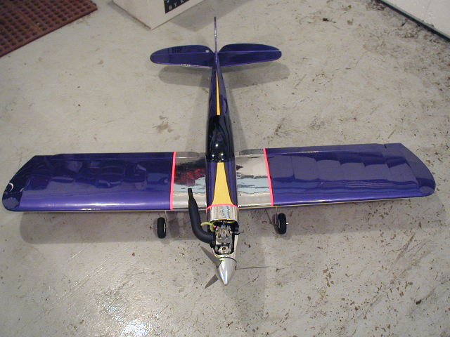

I have a Tower Uproar (kit) that I covered with black Ultracote on the underside of the wings and red Ultracote with yellow scallops on the top side. Even rolling like a deamon in bright sunlight it is very easy to tell top from bottom. On an overcast day, I cant tell top from bottom and have to count the rolls to tell up from down.

I will probably be accused of being too old to fly -by guys that just fly up close and hover
But
We fly aerobatics based on seeing -then changing attitude -then correcting as needed
This all happens pretty fast and we do it unconsciously.
The key point is that the attitude recognition must be instant.
The paint shemes with pronounced differences on left to right panels - can change the ingrained recognition bank in your head.
Everyone has therir own favorite schemes .
Red and alternating cub yellow seem to be the best
Then red and alternating white.
Our WH 35% Extra really showed up in foggy skies - Brian added large squares of white to the all red undersides and this was also a big help.
We once did a pattern plane in teal - and fine cream trim lines.
It was a stealth setup - just went invisible on bright days. awful scheme
The addition of cross box maneuvers -years back, added to the color sceme question
One huge reason that no one flies little planes in IMAC is that the recognition is far more difficult .
If you fly pattern in close -- the time frame collapses and everything happens too fast.
For doing 3D stuff - color recognition is not a problem- the plane is up close and going up and down ,easily seen and followed.
I knew I wasn't the only one with color recognition issues -
I wondered tho, if anyone else had tried the asymmetrical schemes -and how the schemes worked for them.
The underside shown here , is on a blue /yellow upper scheme -
This scheme -on an 80" span, shows attitude -even at a distance.

I hope color recognition will be a lot better now that the Cataracts have been removed.
Up until a few years ago, I flew primarily Helicopters and color itself didn't mean much to me, I think more so because the target was too small.
I have tried all kinds of combos (on heli's) including every fluorescent made. The only thing that works is contrast. If I made the windshield an opposing color it was much easier to recognize attitude, still a small target but greatly improved.
On fixed wing, I have also found the Cub yellow to be better for me than light yellow. I was using it with dark blue, it will be interesting to see if red will be better now. Before the surgery, red looked pretty much black at altitude.
Large stripes or blocks as you show are without a doubt better for me also. I have a 30% Extra with Cub yellow and what I thought at the time, BIG checker board blue squares, Ha, it just looks like a blur at altitude.
any checker smaller than 4" square is no good
- on our aerobatic stuff , we try to keep all contrast areas at least 4" and bottom stripes/blocks 6" or more.
