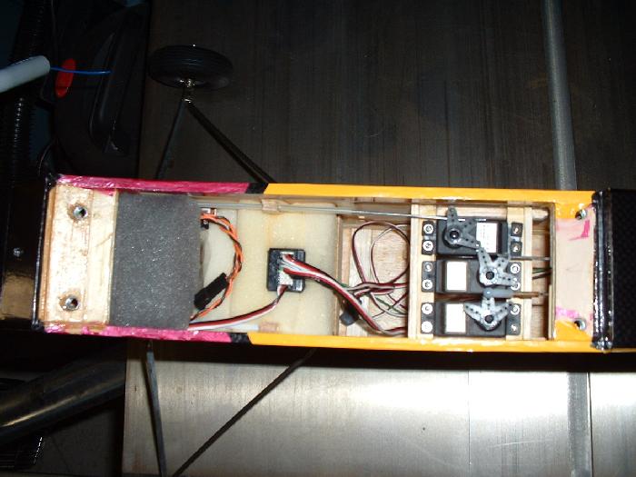

Here's a view of the fuselage.

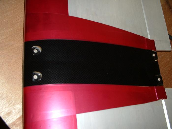

The wing, with 4 matching holes for the 1/4" plastic bolts.

Close up for the front holes.

Close up of the rear holes.

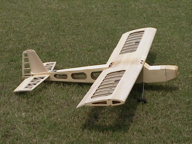

Here it is in the nude. I bought one of the last MkII versions, which came with shelf paper covering. I ripped it all off the plane and recovered with monocote. I added quad flaps, reshaped the tail feathers, and converted it to tail dragger.
