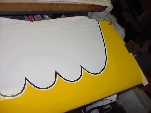

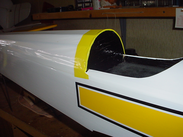

I started on the turtle deck....it was real saggy. The material wouldn't shrink
properly with the gun. Finally, when I got it to shrink it puckered real bad, and
pulled away fron the rear of the cockpit....even though I had my figer blocking
the edge.
I was able to salvage it by putting on a piece of yellow on it. I was gonna put
some black trim on it, to tie it in. I was able to shrink it pretty good with the
iron over the open-bay turtle deck....but after I got all done, it just saggied back
up....so it was a waste of effort.
I figured it would take about 10 minutes to tighten up the whole fuse....just with
the heat gun and a glove to press and smooth the material down. When I went
to use the iron ( because the gun wasn't working) on the top of the fuse in the
front ....all hell broke loose.
I wish I would have found out about the crummy covering before I put the tail
feathers on. It would have been easy to recover the fuse then.
Dave. []

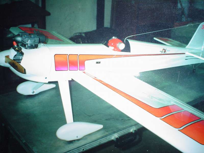

Covering like that is a real bummer. Makes me glad I bought the ARC version a couple of years ago. The Lady is a good solid airplane that flys great and looks good too.

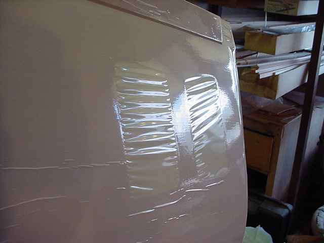

Look at these wings....[X(]....the tips are real bad too. I know they aren't
gonna shrink up right. I'm gonna hit 'em with the heatgun and see if they're
gonna fly...if not....the covering is outta here. Even if it does shrink up half-way
decent....when the summer heat gets to them, I'll probably wish I had just
removed the stuff once and for all.
I think "Mr Global" owes me some Mono-cote....
Dave. []

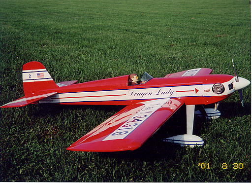

Here's a pic (of a pic) of my first DL. Super Tigre 1.41 ci swingin' a 18x6-10. I flew this for years, and was sorry when I sold it.
In the drawer waiting for it is a Super Tiger 1.37 ci (same prop) May just have to get started on it, as I just sold the plane that was on da bench. I'll mount the motor horizontally, and throw the fumes out the bottom with a Pitts.
