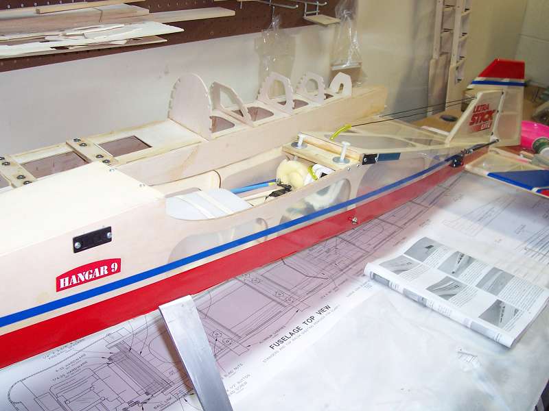

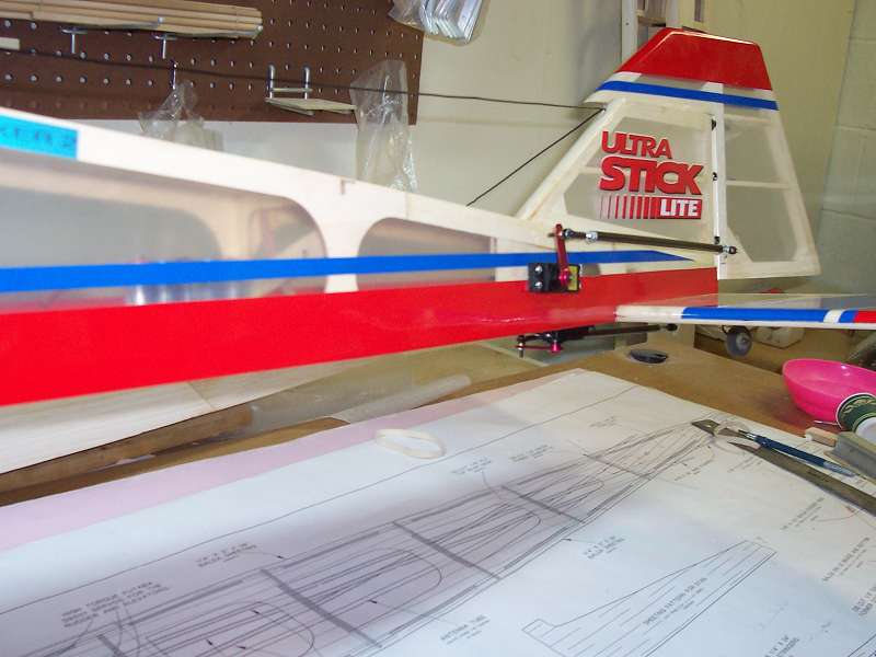

I have been flying the USL120 for several months with a brison 2.4 on the nose ,the servo's and the receiver battery has to go in the tail Fuel tank is under the wing to make room for the ignition and battery in the nose . I'm running an 18x10 prop but there is very little ground clearence. beef up the fire wall and wing mounts .
now for the answer your looking for yes it flies great unlimited vertical or should I say more like a rocket with flaps it can still land very short and same for takeoffs .and it was just under 12 lbs. I have not had any problems with this set up and this is now my favorite plane I never go flying with out it.

Sounds Cool! That was one of my options... The Brisson 2.4, I'm curious how you mounted the brisson, did you mount it with blind nuts or use standoffs. I'm curious. The Mvvs is rail mounted so i believe you would be able to use the stock engine mount. That and the weight made the Mvvs appealing. Did you use the mechanical advance version? How do you like it??? Sorry so many questions but it's good to hear from someone who used something Gas rather than the Saito or O.s. Thanks!

Hey Wyldman, How about some more info on your Brison 2.4 setup? Some pix would be great if you can! How did you mount it up front ? And what muffler did you use? Must see! Must see!! Did you stick with the stock gear with that 18" prop???

Wow I did'nt know there was anyone but me flying this thing, when I first got my USL120 I seached on RCU for a thread about and there was none.
As for answer to all the questions the brison 2.4 is on 1/2 plywood standoffs so I could get the fuel line though the fire wall as the brison mount takes up the whole fire wall then it's bolted on with blind nuts the fire wall has been reinforced. my brison has the mechicanal advance ,no real reason not to use the atuo advance unit I just like the mechicanal one .here are a few pics that might answer the rest of the questions.

Oh almost forgot It's has an 18x10 prop and the clearence is only 1 inch with tail level so you have to keep the tail down on landing ,but what the heck I love a challange. a smaller three bladed would be a better choice and this is with the stock landing gear so maybe just a taller gear would be cheaper , be either way this plane is a blast to fly.
