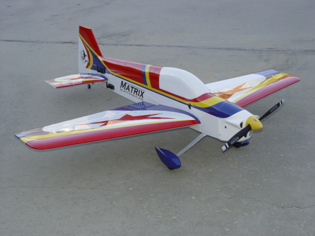

Buttoned it up this evening. A few specs:
OS 70 Surpass, inverted. The supplied tank doesn't fit in the nose, where it needs to be for a non-pressurized/non-pumped engine. So I used a DuBro ten ouncer.
MPI on-board glow system. It, the 1300 mAh sub-C battery for it, and the rx all mounted on or behind the CG. 1200 mAh NiMh rx battery mounted behind the CG, just in front of the elevator servo.
Notice that I keep mentioning the CG? With the balancer set for 5.5", the most-forward location, and the battery removed from its spot and placed ON THE BOTTOM OF THE RUDDER (much farther back than it could be mounted in the fuselage), it still took THREE OUNCES of weight on the stab before it stopped dropping the nose.
This is totally unsat. I have no idea why it is so nose-heavy. Yeah, it was designed to have the tank on the CG. But the rudder servo is in the tail.
This airplane has been one large and significant rectal discomfort. Nothing major (until now), just a lot of little annoying things- MUCH more than is usual, even for a low-quality el cheapo pacific Rim ARF. This one is supposed to be a high-quality offering; it certainly is priced that way.
But this felony nose-heavy condition is just icing on the cake. My first inclination was to rip all my gear out, and take it to the LHS first thing Monday to hang up and sell. Hey, caveat emptor, right? Nah, wouldn't feel right about that.
Normally, I don't throw good time or money after bad. But I've got so much time invested in this one, solving little BS problems, that I might as well solve this one. I'm going to remove that odd-ball elevator system and put two servos back there. They will have to be offset, but I think there is enough room to vertically offset them. The battery will still have to go behind the wing somewhere, I'll bet large on that.
If you are contemplating buying this model, don't. If you already have the kit, sell or trade it. What we have here is a beggar in an Armani suit.

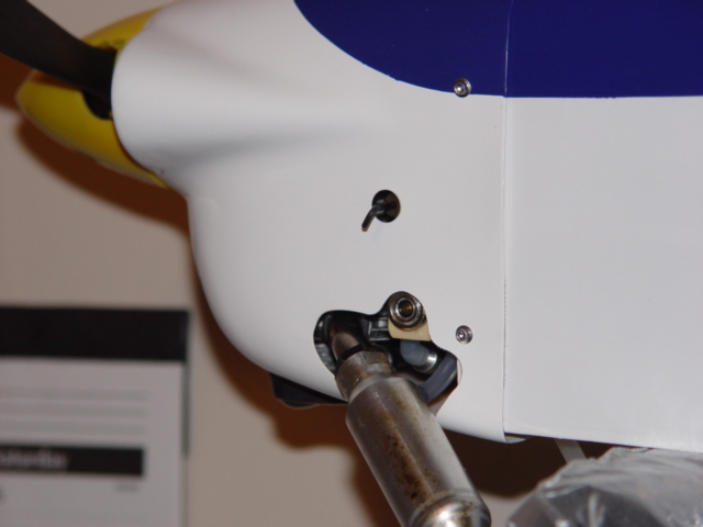

Well, its done.
Talked with Lanier Monday; guy there said their's had a 70 Surpass, and had the battery behind the wing. He had no idea why mine was so nose-heavy. Of course, you cannot expect an over-the-phone diagnosis on this sort of problem. He suggested I fly it first before adding the three ounces of weight under the stab. Good idea.
It balances now at 5 inches. I cut into the fuse bottom, made a mount and a hatch, and the battery is just ahead of the elevator servos.
I'll say this; after all the headaches I've had finishing this airplane, if its flight characterisitcs are anything short of orgasmic it will be swap shop material just as soon as I get something else to put the 70 Surpass in...[>:]
If the weather cooperates, I'll know this week-end. Another thing that is annoying me; I can't put my finger on it, but the model looks dfferent from what I see on the box, ad literature, etc. Sitting on the bench while I was setting the throws, it appeared, well; dorky I guess is the word. That impression solidified when I set it down on the driveway for the photos. Probably just me; Lord knows I'm not real thrilled with this thing right now...

I think you're just upset with this airplane Steve , it looks good to me. I did notice
the fuselage is a lot fatter than it looks in the pictures. Took me a while to figure that out.
Couldn't quite decide what looked different.
I'll fly mine this weekend also as the weather is looking good. I guess we can compare
notes next week. It looks like you painted your canopy and I tinted mine , other than that
and the spinner they look identical.
Good luck

I didn't use the tank that came with it because I wanted a larger one. I installed a Tettra
14 oz. where about 1/2 of it sticks out of the forward compartment into the center compartment.
I didn't want it too far back and end up having fuel draw problems. The Tettra is not very big
around so it fit very easily into the space. My SuperTigre Bluehead was blueprinted and ported
by George Aldrich years ago when I first got it and it uses a little more fuel than the average
SuperTigre so I wanted a little larger tank.
Be sure to check that bellcrank every now and then as it looks like an accident waiting to happen
to me.

Bruce, my original intention was to use a third line and fuel dots. But it is rather crowded in that cowl, and besides, a third fueling line does not address the problem of flooding the carb (which you say you've got figured out). The only way I could see to do it would be to use a hemostat to either clamp the line going to the carb, or just pull it off while fueling.
I had a vision of me on my hands and knees in the pits, grubbing about trying to get the line back on the carb nipple... nah, don't think so. I ended up using a Dubro fuel valve I found in the junk box. I haven't the greatest luck with these gadgets, but this one seems to work as advertised, so we'll see. In view of all the grief this model has given me, a non-functioning valve will simply be par for the course...
Of course, with the inverted installation, I could have just left the throttle barrel full open while fueling, and the overflow would run out, probably NOT flooding the carb. Kind of messy, though.
What I should do is tie the tail to a tree and try it here at the house before heading to the field Saturday. Everything works fine during the static test, but we know that doesn't always it will work for real. But to be honest, I'm simply tired of dicking around with this airplane.
If everything goes well Saturday, fine. If not, I may try to fix it; or may not. You can be sure that I'll bring a back-up model, so the day won't be wasted...
