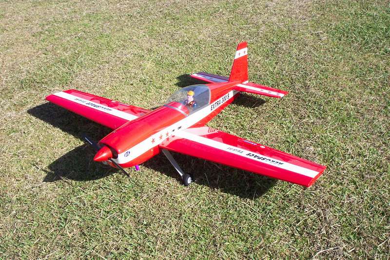

Just finished playing with it and moved the CG to about 95-100mm from the LE and it weighs 2.55 kgs or about 5.6 lbs thats with the wheel pants on ready to fly with out fuel...
Quiet happy about the weight but id like to weigh it on a better set of scales just to make sure..
I also added blue stripes to the bottom of the wing , didnt like the stars, makes it a bit more visable...
Any way going to fly it tomorrow after work ill let you know how it went..

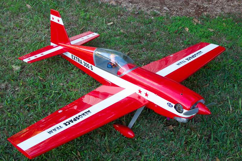

Few more pics

The blue stripes look great ... waiting to hear from you soon. I have a BH Sukhoi 40 and I wonder when I will have the guts to commit hara-kiri ... LOL!

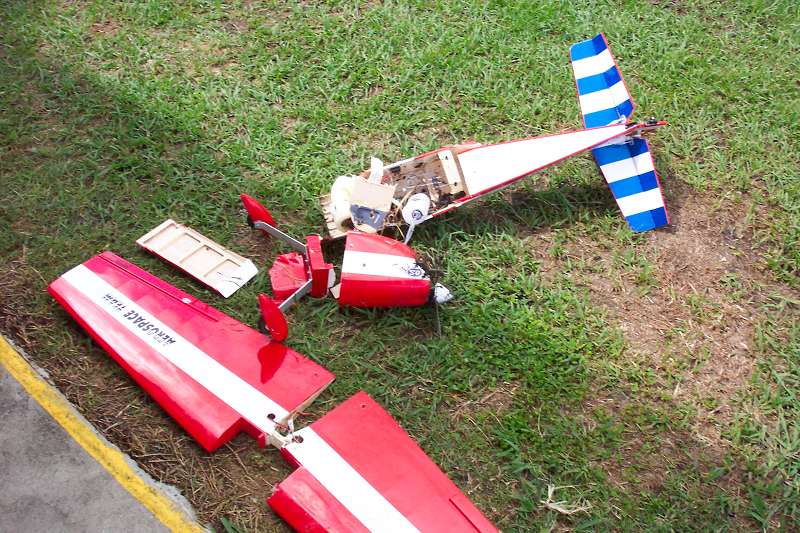

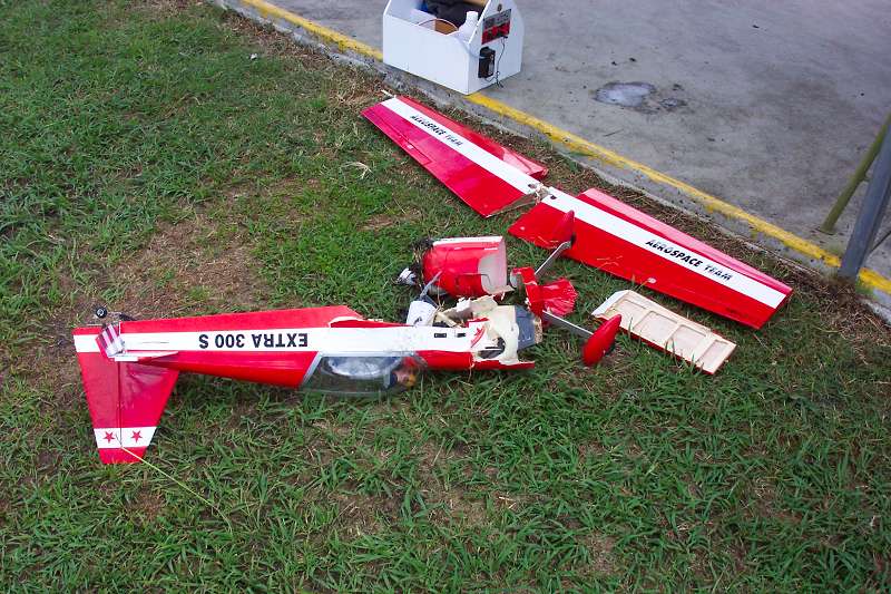

Well this is what happens to wood when it hits the ground realy fast..

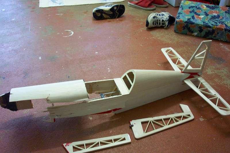

And another. I pulled the film off to have a looksee of the wood and the build is quiet good i think..Any way time for a new extra..

My friend trashed his, the engine was not properly tuned and the plane was not able to pull out of a dive. It took him 2 hard steps to break the fuse! The plane is strong. I am gonna fly my BH Sukhoi 31 and if that crashes (of which I am expecting) I will definately get the Extra 300, that plane flies decently enough from what I saw.

Yeah i tryed the 12.25x3.75 prop and the plane was like it was something else...It had more speed than the 11x6 i was using and was going to try a 11x5 but she hit the ground..wing is good to go again but the rest is in the bin,the wing only came apart where the epoxy was(it ripped 1 layer of ply apart)and it was a clean break.
The crash came from a straight down continual snap roll and got a bit low to the ground and pulled a bit more elevator on to get it up but it just made it snap more and in she went at about 3/4 throtle...Dont have any more 12.25x3.75 props at the LHS eighter..
