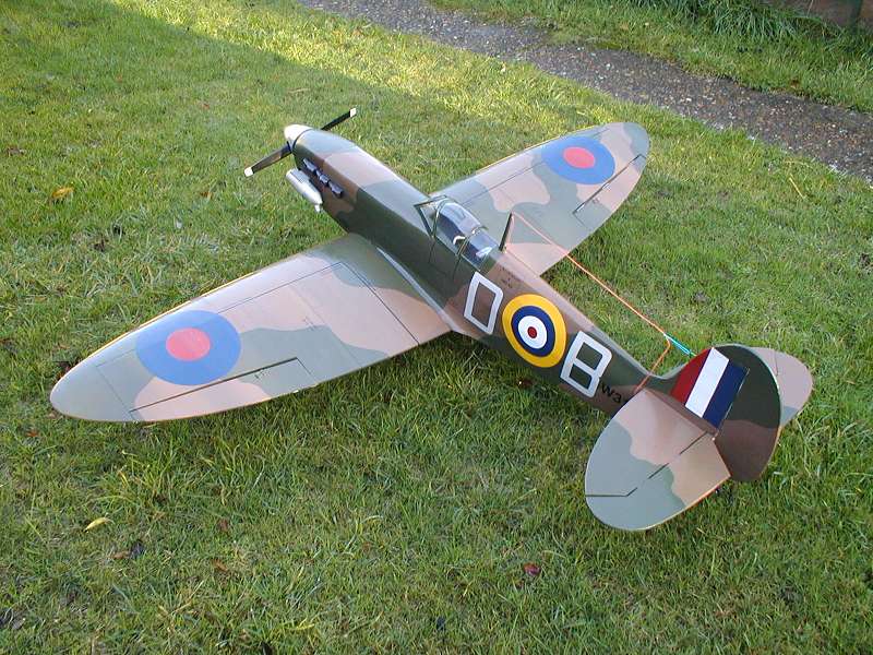

Hi evryone, before Christmas I purchased a second hand Kyosho Spitfire. I have only in the last month started work on it as I had another project on the go (a Seagull Models Space Walker - great plane ! Flys very nice !). I have been reading the prvious posts on the spit and there seems to be a lot of complaints about the undercarige, the wing mounting spar( you know the ply protruding out the front of the leading edge) and the covering. I am starting to consider saving up for some retracts, and was wondering if you think they are worth it as not many people seem to like the standard undercaige , also fitting retracts could pose to be a problem because as I purchased the spit 2nd hand it didnt come with the vac formed wells for the wheels I think it shoul have been supplied with. Ok one last thing, I have bought a mds 48 pro for it and have the engine running smootly and relaibly on the bench , but do you think I will battle to get the c of g correct?

Ive got one of these, so far ive not found anyproblems with the standard undercarraidge seems to be fine and i take off and land in grass... althou i hate the covering it rips extremely easy [&o]
As to the MDS, i use a OS 46 LA and it flys it very well althou be warned i had to add ALOT and i mean alot of lead in the nose as it was extremely tail heavy. Also change the metal wing bolts for plastic or if you have a bump you will have no wings left
I have the vac formed undercaridge legs somewhere for retracts as i never used them, althou i would have to dig them out of my loft, soo if you do want them just let me know and ill c what i can do, but i cant promise anything u havent seen what its like up thier lol.
I hope this isnt your first kit, as i found this alot harder to build than any other kit and ive built alot............. and you will need to fuel proof the whole thing because as soon as hot fuel gets to that wallpaper covering it will come off [:@]. The Spit flys well but its very much like a warbird in flight soo be careful not to land 2 slow.. Mine doesnt fly much now as i brought a Flair Spitfire 90 ARTF (Lovely kit, fibreglass body etc etc, much much better with retracts).

Thanks for the reply - no it is not my first model , I have been flying for about 3 years now. My MDS seems to be much more chunky and heavy than the O.S 46's so hopefully that will mean not to much lead in the nose ! As far as the vac formed wells are concerned, thank you very much for the offer, but I was just wondering if it was actually originally supplied with the wells - my Dad should be able to help me vac form the wells using a vacuum cleaner and a hot air gun. I understand what you mean about the loft - mine is like a mine field, one wrong step and you will be picking bits of plane off the bottom of your feet
! I will get some fuel proofing for that dreadful covering or possibly recover the spit in the RAF reconnaissance pink!
