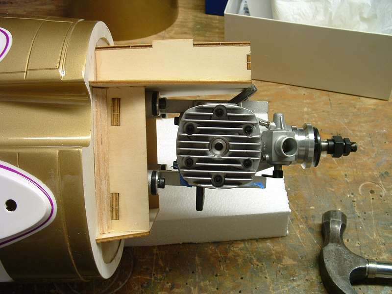

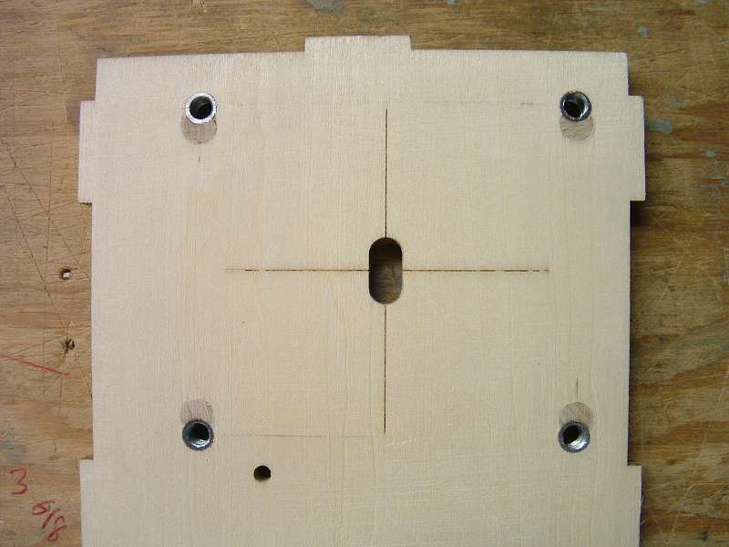

cstevec:
I have all but completed my radio and engine (OS-FX-1.60) installation into my RB and it fits without issue. I will be using a Brison 1.60 Pitts style muffler. There is NO cutting of the cowl needed except for the glow plug access and the muffler discharge.
To install this engine, all you need to do is insert 1/4" wood dowels into the EXISITNG motor mounting holes in the assembeled firewall, (3 pc's epoxied together), then drill NEW holes as per the detail below and YOUR DONE.
The engine has sufficent clearances in all directions and actually looks like the airframe was made for it !
A couple of assembly observations:
1. When installing the firewall into the ply side frames, it will go MUCH easier if you insert the firewall into the (shorter) frame FIRST then flex the other frame and walk the firewall into position as the longer frame has much more flex.
2. DO NOT GLUE the rear frame support bulkhead in place until you have installed and located the FRAME assy. into the fuse and thru the firwall. Then position the rear support bulkhead and CA together.
3. This is true for the bulkhead in the rear of the fuse for the tailwheel as well. Fit ALL pc's togther DRY then CA into place.
4. I added 3/8" tri-stock to the side frames on the firewall side of the fuse in front of the F/G.
I was hoping to get it done over the long weekend, however, the Robo-struts won't be here till the end of the week.
I will post some pictures this evening.
BR.

Hey there Vampire, just wondering what kind of prop clearance will you have with that 1.60? I had thought about ST 2300, but didn't know if I would have enough prop clerance since it swings an 18 inch prop. If you could, send pics with your engine mounted and prop on, when ever you get that far, just kinda currious. Thanks

aps f4u:
I'm already there and the kit comes with a 3 bladed spinner and thus since the O.S. FX-1.60 calls for an 18-8 > 10 2 blade, we will be using a 16 x 8 3- bld. and represents NO issues with ground clearance. (rule of thumb- 2 bld to 3 bld, drop 2" on Dia. and HOLD the pitch).
Pic's to follow this evening.

Engine install pic's (O.S. FX-1.60)

Yes, tack parts w/ CA+ then epoxy.
The box you see above the engine is for the Battery. I believe with the 1.60 install the battery will be used elsewhere in the model for final balance. I like that as dead weight in any aircraft is a sin.
