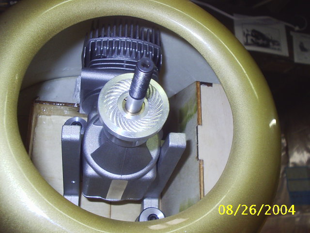

Hey Vampire, are you going to glass you firewall for extra strength? One other thing that concerns me, I had a friend to day, who took a super sportster 40 that he flys, and stuck a Tower Hobbies .75 in it, and we went out this afternoon to fly it....and boy did that thing haul!!! till it had the elevator sucked right off in a high speed fly by. The elevator just ripped out and it was all over, to the burn pile it went. It had the CA hinges in the plane and that had me thinking, that since the Rare Bear comes with the standard CA hinges, and we are over powering them, mabey those nylon pinned hinges and epoxy those suckers in there. I'll be damed if I have the control surfaces come off on me in high speed flight!
Here is another side shot of the 2300, these things have alot of right thrust in them....I thought so anyway!

No I did not glass the firewall as it is nearly 3/8" thick when all 3 firewalls are glued to gether and I did install triangle stock in on the front side.
As for the hinges, I did previously mention that I will be using Robart Hinges points in place of the CA hinges.
Another issue I have addressed is the location of the fuel tank. TT has it sitting in the bottom of the fusleage and SIGNIFICANTLY below the engine centerline by INCHES !
I installed a tray to raise the fuel tank to the engine mfg.'s recommend positon.
I have recieved and installed the Brison OS 1.60 Pitts muffler which only required a very small amount of the the wood frame to be remove (less than 1/16" ) to provide clearance and I must say that the final engine installation looks as if it was made for the Bare. The other bennift is that approx. 5/8" of the muff stacks exits the bottom of the cowl.
On the subject of balance, it turned out with all the mod's I have made, the balance can be achived just by moving the Rx batery around as detrimned by a preliminary C/G check.
