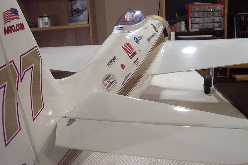

Also, JWortner, Vampire, I'm completely finished with my Bear. It looks AWESOME! OS-160, Sierra Air Retracts, Smoke system.
JWortner, your plane flew nice in the video. What control throws did you use for the elevator and ailerons? And, what point did you measure the CG...the reccomended 5.25" from wing front? Did your plane want to naturally climb?
I haven't broken the engine in yet, but will be ready to take her out in a couple weeks.

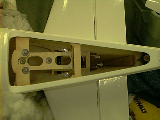

I've noticed a number of issues inside my right stab that might be the primary cuase of the failures. I've only modified one stab to date, and when I open the second stab I'll take pics and post them.

I have found a problem with the tail linkage that may cause flutter, the rods that go to the inside for the elevator pushrod flex or move away from the elevator onder load so i mad a bearing for the rod where it enters the fuslage to keep it solid and strait, to do this i put oil on the rod and then used some aeropoxy mixed it up and put it around the rod and spead on the fiberglass, when it dried hard i then broke loose the rod, now have a perfect bearing around the rod and have eliminated the problem, i hope this helps, or you understand what i am saying. here are some pics.
