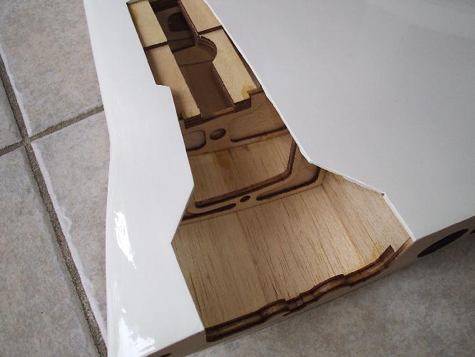

Here are a few pics I took of the new retract mounts I designed for my TT RB. The ribs were produced using tracings of the original ribs. I widened the retract mount fore/aft and designed the ribs to capture the retract mounting plate which prevents it from shearing out when landing on grass fields.
The pencil lines in the picture of the retract / wheelwell area are the original locations of the factory 1/8" lite ply ribs. The new retract mounting plate was expoxied into the wing with a long setting epoxy mixed with BVM Mill Fiber. The new ribs are simply butt glued the the spar shear webbing, the leading edge, and the upper wing skin. I used my finger to make a nice clean fillet of the epoxy/millfiber mix around all the joints.
My club field is grass and the new mounts have held up to one rollout into the rough stuff and two subsequent landings afterwards proved the structural integrity of the design.
I'll post the downthrust and right thrust numbers when I get a chance to measure them.

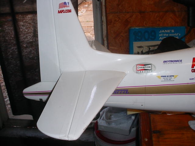

well boys....I have finaly test run the engine. It runs fine with that weird tank setup.......go figure..........this setup goes against everything I ever knew about good tank installation.
I started completing this plane Christmas day and cant beleive how long Ive had to work on it.
I noticed a few vibration issues and I'll have to brace that plywood crutch inside to stop the tail from shaking.
Ive done the tail mods yall suggested instead of building a new tail.
Had to raise the right wing tube 1/4 inch to make it parelell to the horizontal.
Had to ditch the rudder cable system due to the crappy hardware that broke. Using two nyrods for rudder and tailgear instead.
I made a pin and latch system for the canopy and it works good. I did use three screws for the under hatch at the tailwheel.
I replaced the hardware that wouldnt thread into one another like designed to do.
The canopy stickers are too small so I will be repainting the frame.
All I have to do is go get a needle valve o-ring for the supertigre, and secure the battery better, and brace the nyrods in the middle of the fuse. Paint the canopy and apply the decals and I'll be ready to go crash.

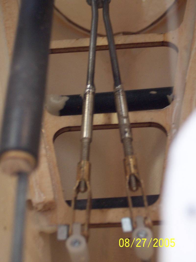

OKAY HERES SOME PICS. I;ll upload and then edit in some text.
The first one is the canopy installed.
2: front pins. The pins are simply music rod glued into 3/8 stock. Its then epolied to the canopy. The pins can be bent for fit. The holes the pins go into are elongated at the center of the fuse, and the rear, because the front pins go in first and the rear is lowered into position.. I added cut fiberglass to all epoxy.
3: is entire canopy pins and latch catch, no.it aint beatiful.
4:the latch itsself inside, attached to turtledeck with glass reenforced epoxy.Simple ink-pen sping design.
5: the latch as seen from outside the plane...... without the canopy.
6:wing tube mod. had to raise the hole and scab ply on the bottom....Gawd...what junk. Also note the hole for the 1/4 -20 bolt that holds the wing halves on.
7:I sealed the control surfaces to reduce the chance of flutter.
I do that to all my planes.
8: pushrods... oops wrong ones....next pic, 9: is rudder pushrods. In this pic you see a blue thing at the top right........thats a feather micro servo that will work the gear doors. One per side. I built the doors and worked out the mecanics, but I aint painting and installing til I see if it flies right.
Hope that helps.
