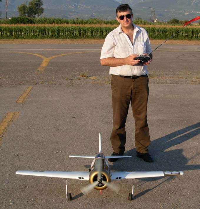

I have been flying my bear now for about 3 weeks and having a blast with it. It has spring air retracts and an AXI 5330/16 on 10 cells with a 18/12 prop and seems to be able to get out of its own way to me. Here is a clip of flying on its second flight. I had some problems with the retracts staying up.
http://www.youtube.com/watch?v=eQO9s7luepI
